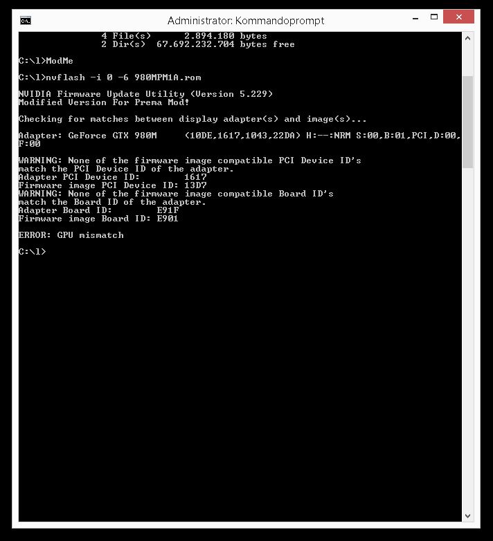

Gomi Posted October 23, 2015 Share Posted October 23, 2015 Well I just used Prema's instructions (see rar file) and it all went smooth. The only precaution I used was to restart the computer before doing it.As always with bios or vbios updates, be careful to have battery charged 100% and pc plugged in. Good luck and post some fo your overvolting/overclocking solutions (possibly stable ones for gaming, not for benchamrking) Ran the ModMe.Bat as Admin ... Unfortunately it tells me this: Link to comment Share on other sites More sharing options...
Guest Posted October 23, 2015 Share Posted October 23, 2015 Ran the ModMe.Bat as Admin ... Unfortunately it tells me this: [ATTACH=CONFIG]16348[/ATTACH]You have the g-sync version of the GPU and need another mod.Dump and PM me your vBIOS. Link to comment Share on other sites More sharing options...
Gomi Posted October 24, 2015 Share Posted October 24, 2015 You have the g-sync version of the GPU and need another mod.Dump and PM me your vBIOS. PM´ed Link to comment Share on other sites More sharing options...
Guest Posted October 24, 2015 Share Posted October 24, 2015 PM´ed OP updated with G751JY - GTX980M-G (g-sync edition) Prema Mod! ENJOY! Link to comment Share on other sites More sharing options...
