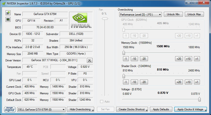

okay back after a day, i under-clocked my GPU from 1240 MHz to 810 MHz, thats too much i didn't test this before, i'm guess its a power problem(mobo or power brick) so after i UC i've played for 2 hours without getting a black-screen :D, and the surprise comes when i opened prime95(cpu bench), poof ! black-screen. i've been testing alot and what i understand is i have a power problem, and the GPU ask more power.. no response, poof black-screen ! i also flashed the unlocked bios A03 and limited my cpu (maximum battery profile, 1 core, no turbo, disabled c6 and c7 states), i played for 3 hours without GPU UC.
(in attachment i uploaded a screenshot of nvidia inspector, and i get that prompt after rebooting from a black-screen)
thanks for helping, i hope someone have a solution for this.
inspector uc.png2.png.c7485d4d166ac9f504dedf1a7a606fef.p1.png.c4341845d4476a396597c63ab123303c.p
