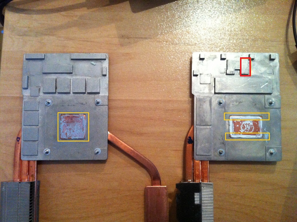

Drahcir89 Posted November 4, 2015 Share Posted November 4, 2015 cany anyone confirm that the heatsink from the ms 1761 with gtx570m will work with a 970m? Is there any modification required and if so can you point me in the direction of how the mod is done? Thanks Quote Link to comment Share on other sites More sharing options...

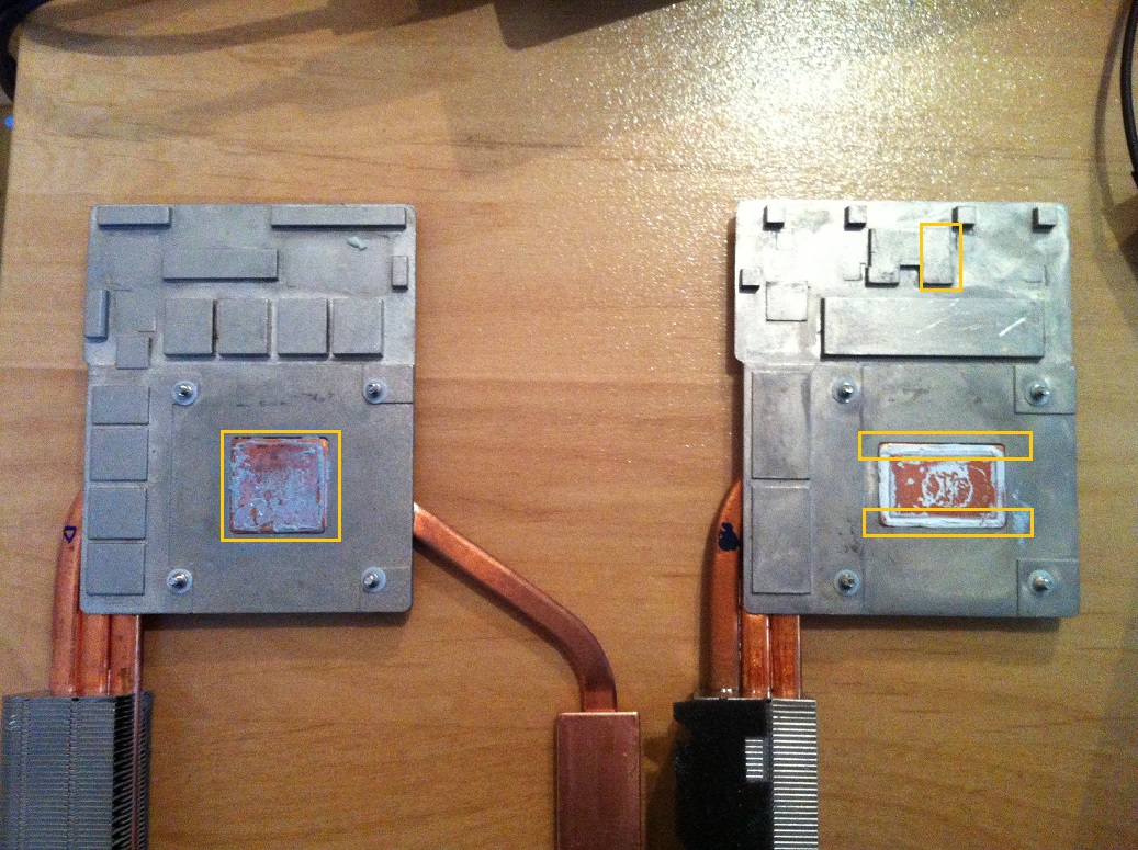

Bloetschkopf Posted November 8, 2015 Share Posted November 8, 2015 Yes,it is possible,You must modify the Heatsink like the red Mark in the Picture. The GPU Copperplate is a little small at the yellow Mark. And You need a lot of Thermalpads. - - - Updated - - - Quote Link to comment Share on other sites More sharing options...
Drahcir89 Posted November 28, 2015 Share Posted November 28, 2015 Hi bloet can you clarify about the smaller copper pad on the older heatsink vs the new one. Is the idea to put thermalpads where you marked in yellow? Or do you just paste it like normal and just go with the partial coverage? So to sum i guess where do you put the thermal pads and does the smaller plate pose any problem temp wise? Quote Link to comment Share on other sites More sharing options...

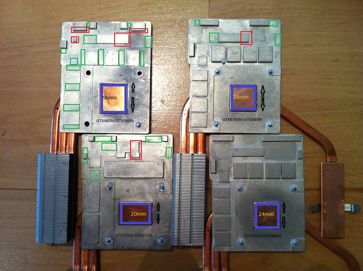

Bloetschkopf Posted November 28, 2015 Share Posted November 28, 2015 Hello Red : remove Green: Fill up with Thermal Pads Blue : Thermalpaste Quote Link to comment Share on other sites More sharing options...
Drahcir89 Posted November 28, 2015 Share Posted November 28, 2015 Wow thanks! That's the best instructions I've come across yet. Quote Link to comment Share on other sites More sharing options...
