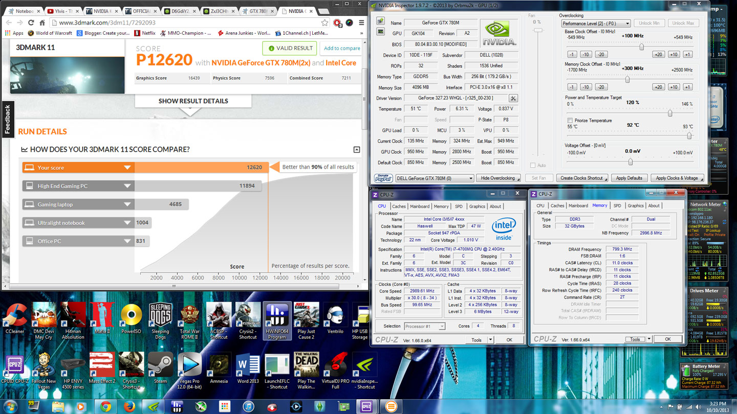

Here is some memory overclocking. For those that are not sure what to look for, what you see on the CPU-Z Memory tab is what I am running. The SPD tab shows the memory defaults. I might be able to get a little more of a memory overclock, but I am surprised I am able to use the 1866 timings. This is running 1.65v.
I think these are pretty tight timings for 2133 and they pass the Dell ePSA memory test with flying colors.

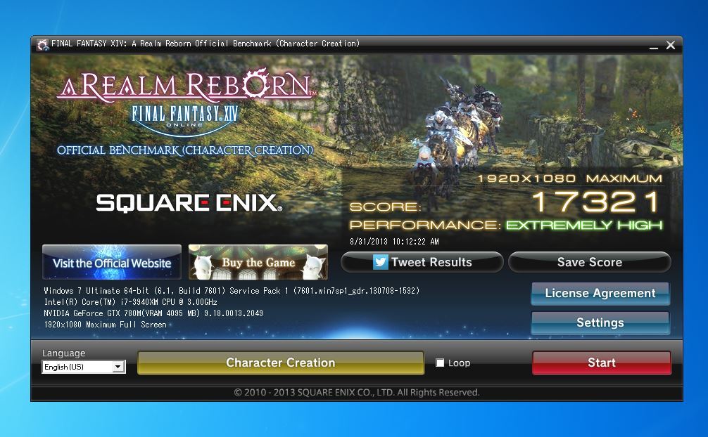

Final Fantasy XIV Catzilla - 9874
