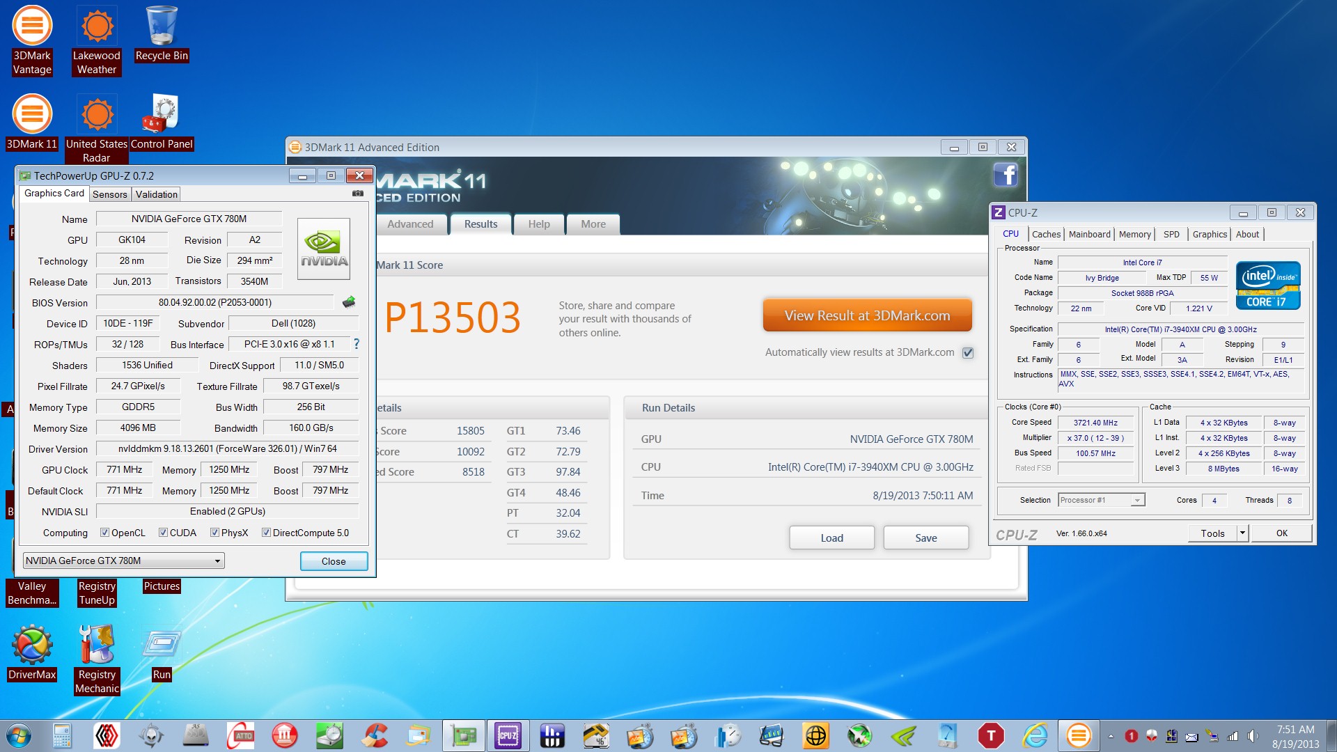

Finally got the new Alienware 18 running well enough to beat my M18xR2 in Fire Strike. This is as high as I can overclock the GPUs without tripping the AC adapter. Will try the dual-330W now that I have found the max OC potential using just one AC adapter.
Looks like our Fire Strike CPU scores are very similar with the 4930MX at 4.5GHz and the 3940XM at 4.6GHz.

Finally got the new Alienware 18 running well enough to beat 680M SLI my M18xR2 in Fire Strike. This is as high as I can overclock the GPU without tripping the AC adapter. Will try the dual-330W now that I have found the max OC potential using just one AC adapter.

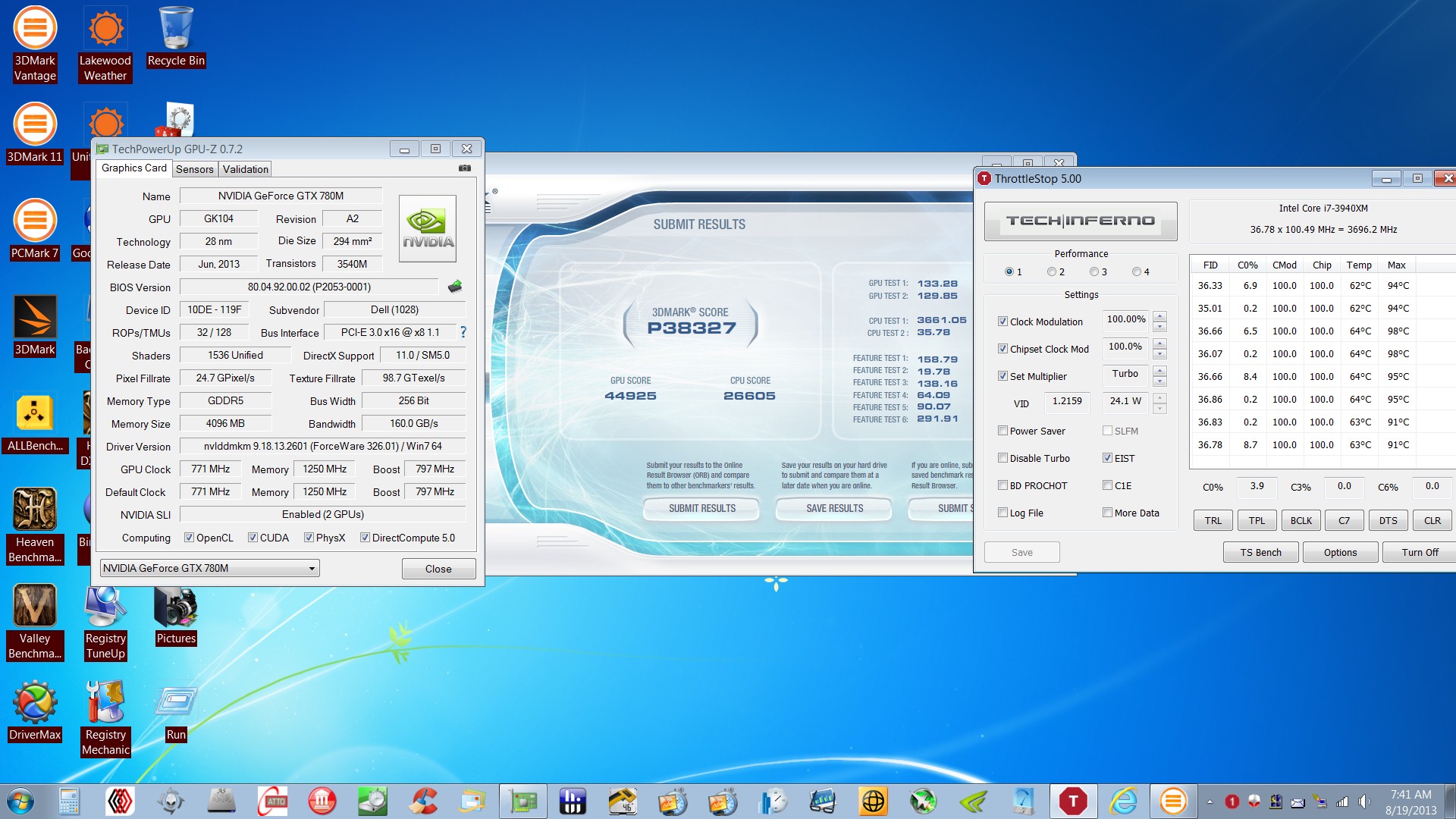

On the subject of HWBOT.org banning Windows 8, here is an interesting comparison with Windows 7. In this example, the skewed numbers actually go the wrong direction to provide an advantage to Windows 8 users. Not a revelation because we had already verified that Windows 8 often hinders CPU performance. This is with identical CPU/BIOS settings. I simply booted from one OS to the other.
Windows 7 Ultimate x64
Windows 8 Pro x64
