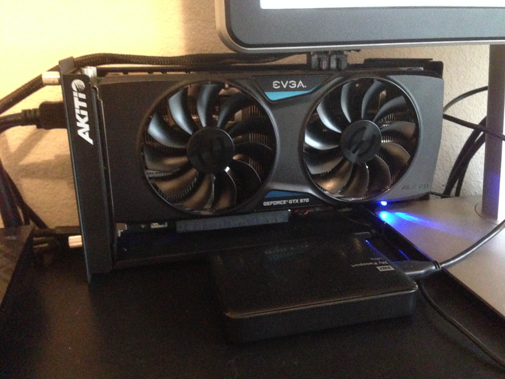

computersaysno Posted May 8, 2015 Share Posted May 8, 2015 System mid-2012 15" Macbook Pro Retina with the Nvidia 650m dGPU i7-3720QM 2.6Ghz quad-core CPU 16GB RAM 768GB SSD Win 8.1 MBR/bootcamp installation eGPU gear EVGA NVidia 970 FTW AKiTiO Thunder2 enclosure EVGA 500W ATX PSU eGPU Setup 1.20 software RE: http://forum.techinferno.com/implementation-guides-apple/9802-2013-15-macbook-pro-gt750m-gtx970%4016gbps-tb2-akitio-thunder2-win10tp-%5Biregret%5D.html , @iregret. Hey not as good as yours, but not bad for Thunderbolt 1 :-) 3dmark11.GPU=10619 I can run Fire Strike without a problem, maybe it was just the first test that doesn't jive with my system for some strange reason.... Got tired of messing with my bulky Cooler Master 130 and opened my Akitio case like you guys suggested. I took everything out & used a little black spray paint to clean it up a little. Pretty pleased with the results. Now to find a good compact modular power supply.... [ATTACH=CONFIG]14881[/ATTACH] Quote Link to comment Share on other sites More sharing options...

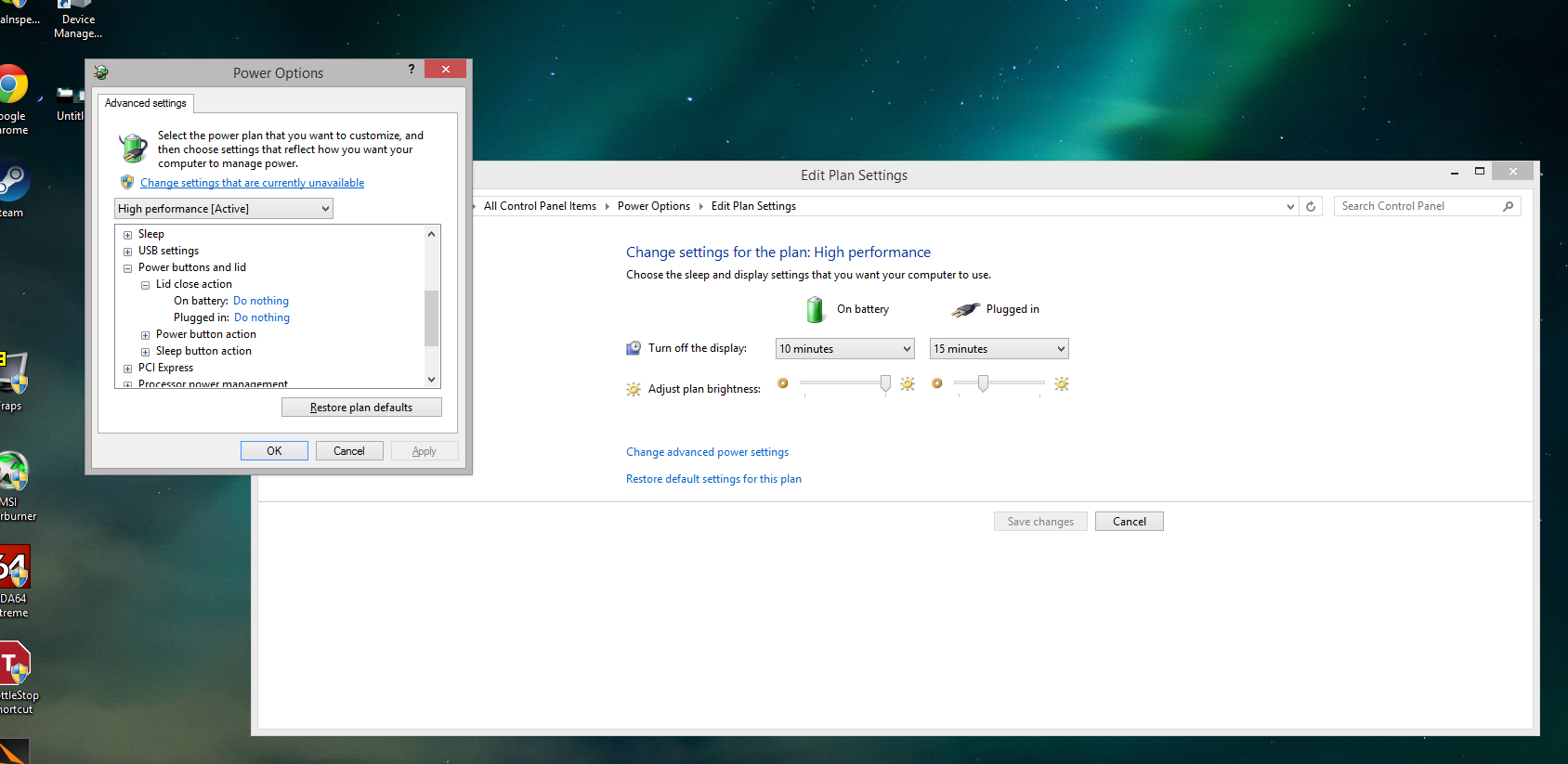

iregret Posted May 8, 2015 Share Posted May 8, 2015 Hey not as good as yours, but not bad for Thunderbolt 1 :-)NVIDIA GeForce GTX 970 video card benchmark result - Intel Core i7-3720QM Processor,Apple Inc. Mac-C3EC7CD22292981F[ATTACH=CONFIG]14794[/ATTACH]I can run Fire Strike without a problem, maybe it was just the first test that doesn't jive with my system for some strange reason....Not as good as mine, but it's pretty damn close! This makes me think the difference between tb1 and tb2 isn't as critical as I had thought. Also, I've got descent fire strike scores but I haven't tried gaming for hours to test stability. I'm hoping that someone will chime in and make sure I've got the clock settings correct in throttlestop. One other thing, I also use a program called macsfancontrol to control the fans manually. I'm still tweaking it, but essentially, I have the fans ramp up sooner and more aggressively. How are you running the MacBook closed in Windows without it shutting off? Where's that setting at? Quote Link to comment Share on other sites More sharing options...
computersaysno Posted May 8, 2015 Author Share Posted May 8, 2015 It's here in control panel, power options, change plan settings, change advanced power settings Although I'm not really sure it's making much of a difference. My Fire Strike score was basically the same (slightly higher by a few points) with the lid closed upside down. But I THINK it's been helping my in-game performance in GTA V. Who knows. I may be being ridiculous... Anyway, great pointers, thank you! 1 Quote Link to comment Share on other sites More sharing options...
computersaysno Posted May 16, 2015 Author Share Posted May 16, 2015 Changing the Intel Power balance doesn't disable the dGPU. It's more like disabling the iGPU.That gives performance preference to the CPU over the iGPU, since they both sit on the same processor die with both a temperature and TDP threshold. I set mine to 31 and 1 as sometimes a value of 0 means "all". Interesting.... With an MBR Boot Camp installation, the integrated Intel graphics drivers aren't installed at all (unless I'm mistaken). Intel Graphics do not display in my "Display adapters" section of Device Manager. So if my Intel Graphics driver isn't installed, are these ThrottleStop settings really doing anything for me? Maybe a placebo effect ;-) ? Got tired of messing with my bulky Cooler Master 130 and opened my Akitio case like you guys suggested. I took everything out & used a little black spray paint to clean it up a little. Pretty pleased with the results. Now to find a good compact modular power supply.... Quote Link to comment Share on other sites More sharing options...
