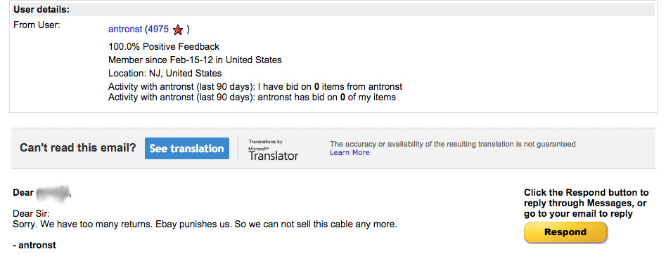

liga Posted September 11, 2015 Share Posted September 11, 2015 Hi, I tried to buy one of these and here's the reply Quote Link to comment Share on other sites More sharing options...
Dschijn Posted September 11, 2015 Share Posted September 11, 2015 Hi, I tried to buy one of these and here's the reply[ATTACH]15903[/ATTACH]The adapter cable? Guess too many bought it without knowing what it is for. Quote Link to comment Share on other sites More sharing options...

tranj10 Posted September 13, 2015 Share Posted September 13, 2015 It seems that the ebay seller no longer offers the pre-fabricated cable. Quote Link to comment Share on other sites More sharing options...
cbong23 Posted September 14, 2015 Share Posted September 14, 2015 Hello guys,Seems like this cable is no longer available from the owner. So I've decided to create my own.Based on the image, this wires has been spliced/soldered all together here. Is it something safe to do?Imgur: The most awesome images on the InternetPlus, if you know any alternative cables like this, let me know. Quote Link to comment Share on other sites More sharing options...
