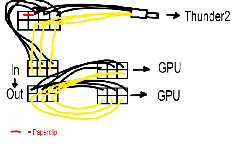

Thanks guys now i understand all i need to do:
i need
the parts:
1. 2 x /1 6pin (F) to 2-port 6Pin (M)/ - http://www.ebay.com/itm/381735085373 - US $5.58
2. 5.5mm x 2.5mm DC Power Male Jack - http://www.ebay.com/itm/122226983207 - US $1.61
3. Akitio Thunder2 PCIe Box by Akitio - US $219.00
4. EVGA GeForce GTX 1060 GAMING SC, ACX 2.0 (Single Fan), 6GB GDDR5, (6 Pin / 120W Max Power Draw) - to fit in the Akitio -  US $249.28
5. DELL DA-2 220W - US $15.00
(total - US $490.47)
the steps:
1. put the 6 pin (F) in the Dell DA 2 8 pin (M)
2. cut the 1 of the 2 - 6 pin and connect yellow / black to - 5.5mm x 2.5mm jack
3. connect 8 pin and 6 pin via paperclip (i will take one from my wife)sDHXda9.jpg
Is this are the right steps, because i need to order the parts? :)

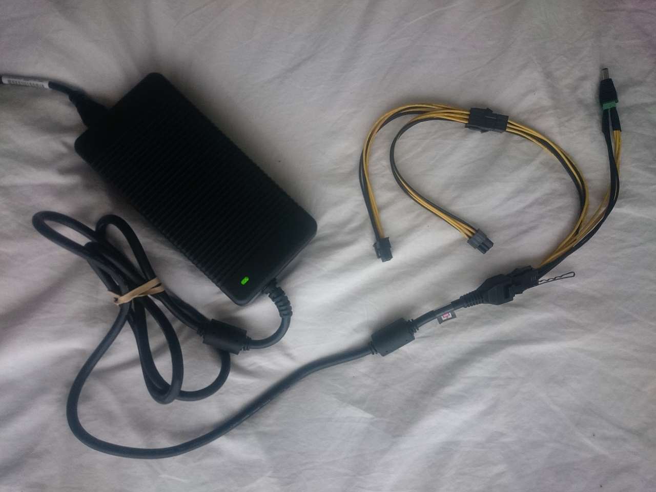

@Vegarab That is what I learn from this thread:
1 put the 6 pin (F) splitter in the male 8 pin of Dell DA-2
2. cut the of the two 6 pin (M) and put all yellow cables to (+) and all black into (-) of 5.5mm x 2.5mm barrel
3. connect the other 6 pin (M) with the other 6 pin splitter
4. Put the paperclip to turn ON your Dell DA-2
5. connect the 5.5mm x 2.5mm barrel to Akitio and 6pin (M) from the splitter (that without barrel) to the video card
DONE :)
Edited by enjoy

This works just fine @Vegarab. You don't require the second splitter because your gpu only has one 6pin.

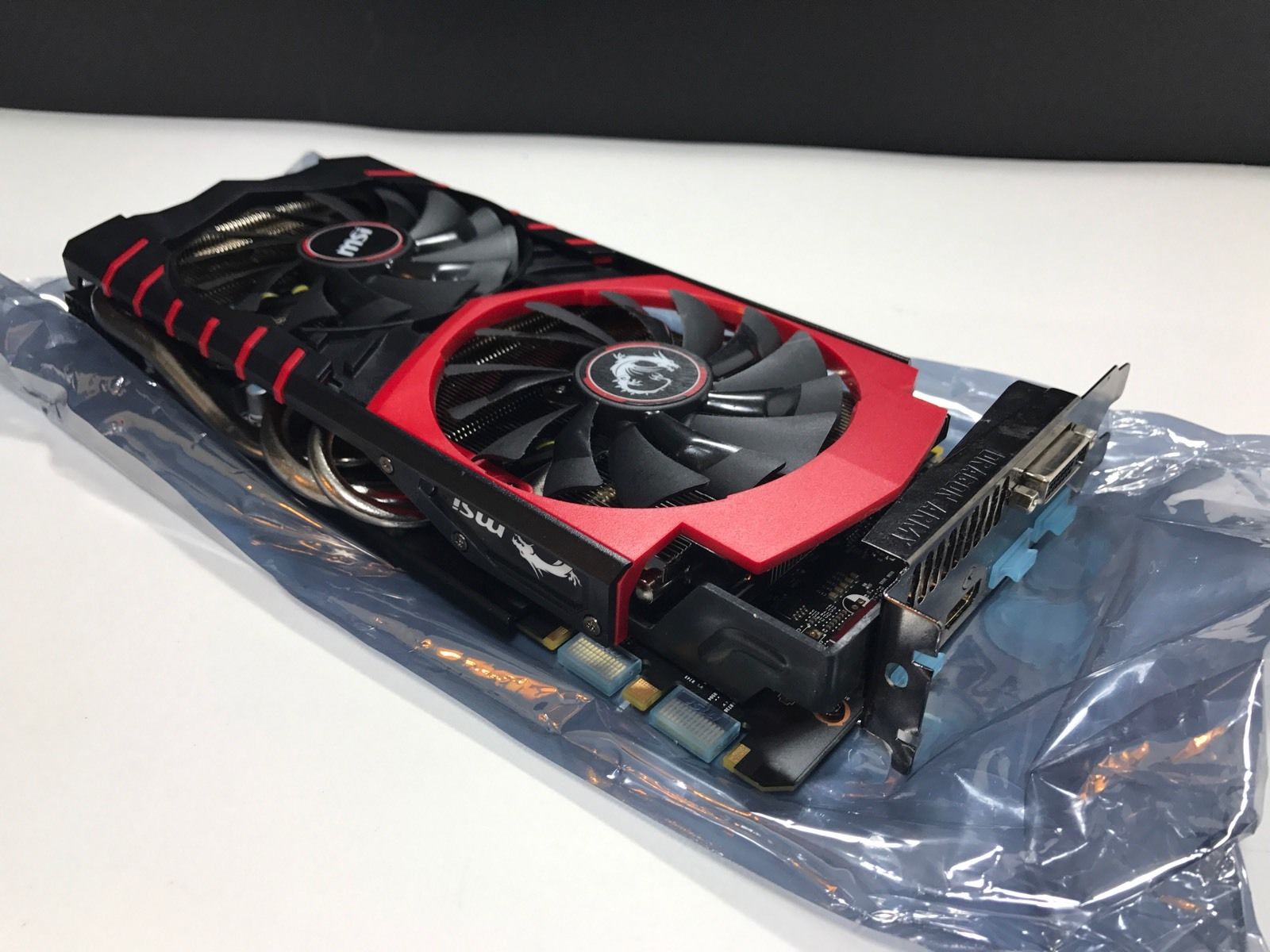

will non reference gtx980 work???
