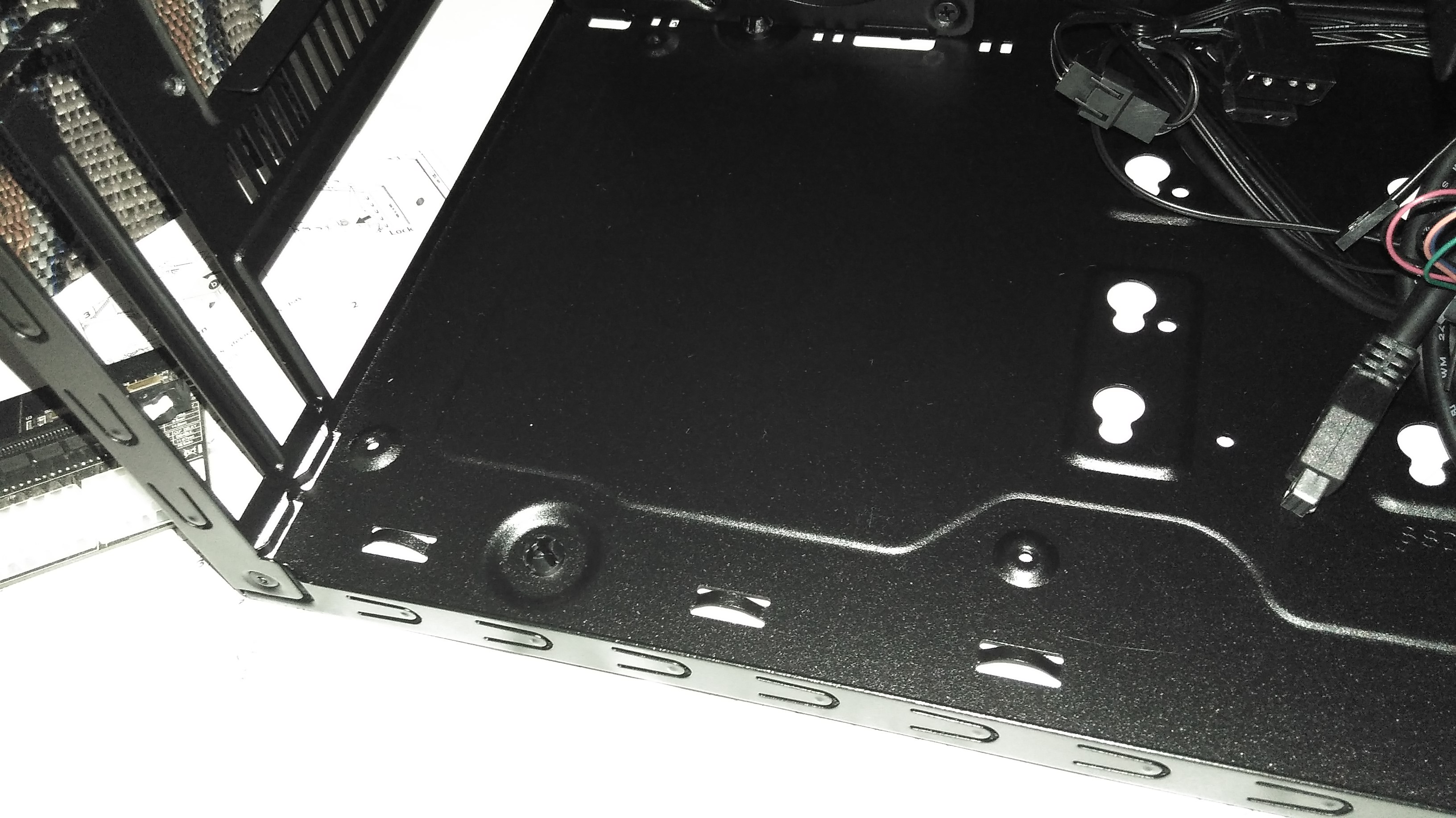

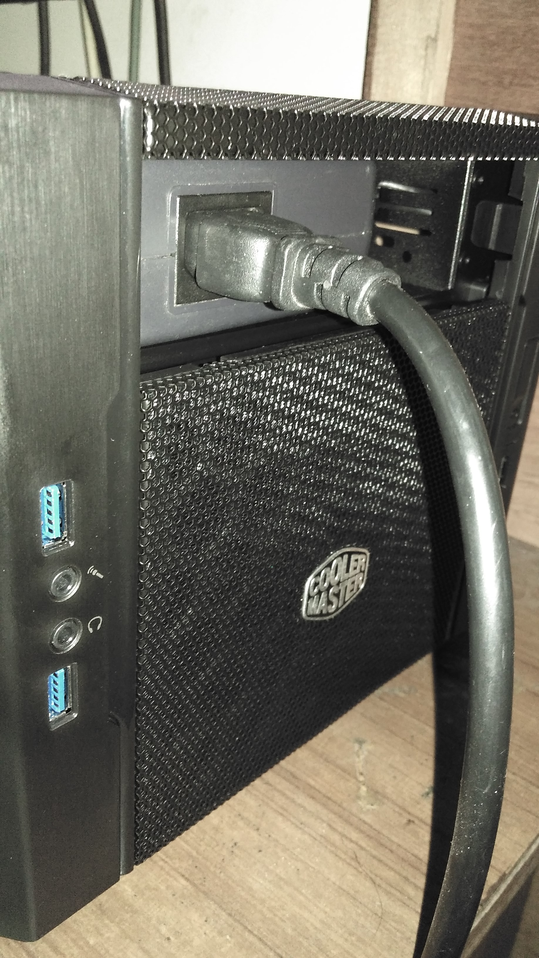

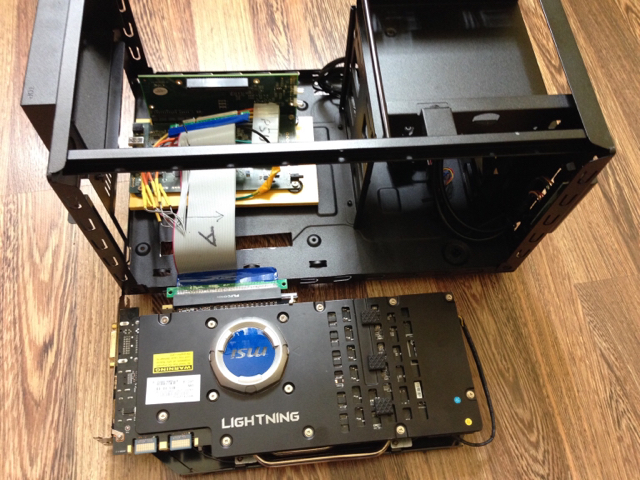

gharimanto Posted March 7, 2016 Share Posted March 7, 2016 On 2/25/2016 at 2:24 AM, Dschijn said: Ok send you in a PN Recently, I bought elite 130 advanced Should I get flexible pcie riser ? Because PE4C 3.0 stuck in this case Spoiler Spoiler Link to comment Share on other sites More sharing options...

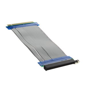

Dschijn Posted March 7, 2016 Author Share Posted March 7, 2016 Try and find this riser: DeLOCK 41788 PCIe x16 Riser You will need exactly this riser to make a 90° turn and you will need a flexible riser cable as well. OR you try and find Li-Heat Riser like this in Type-A: http://www.highflow.nl/hardware/videokaarten/li-heat-pci-e-gen-3.0-ribbon-flexible-riser-cable-black.html As you can see the connector makes a 90° turn into the cable: This is mandatory for cases like the Elite 130. 2 Link to comment Share on other sites More sharing options...

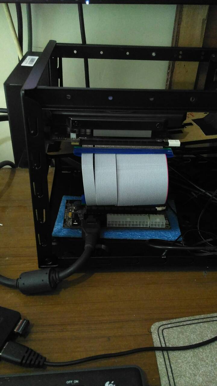

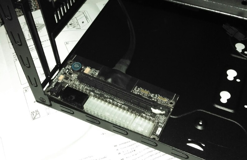

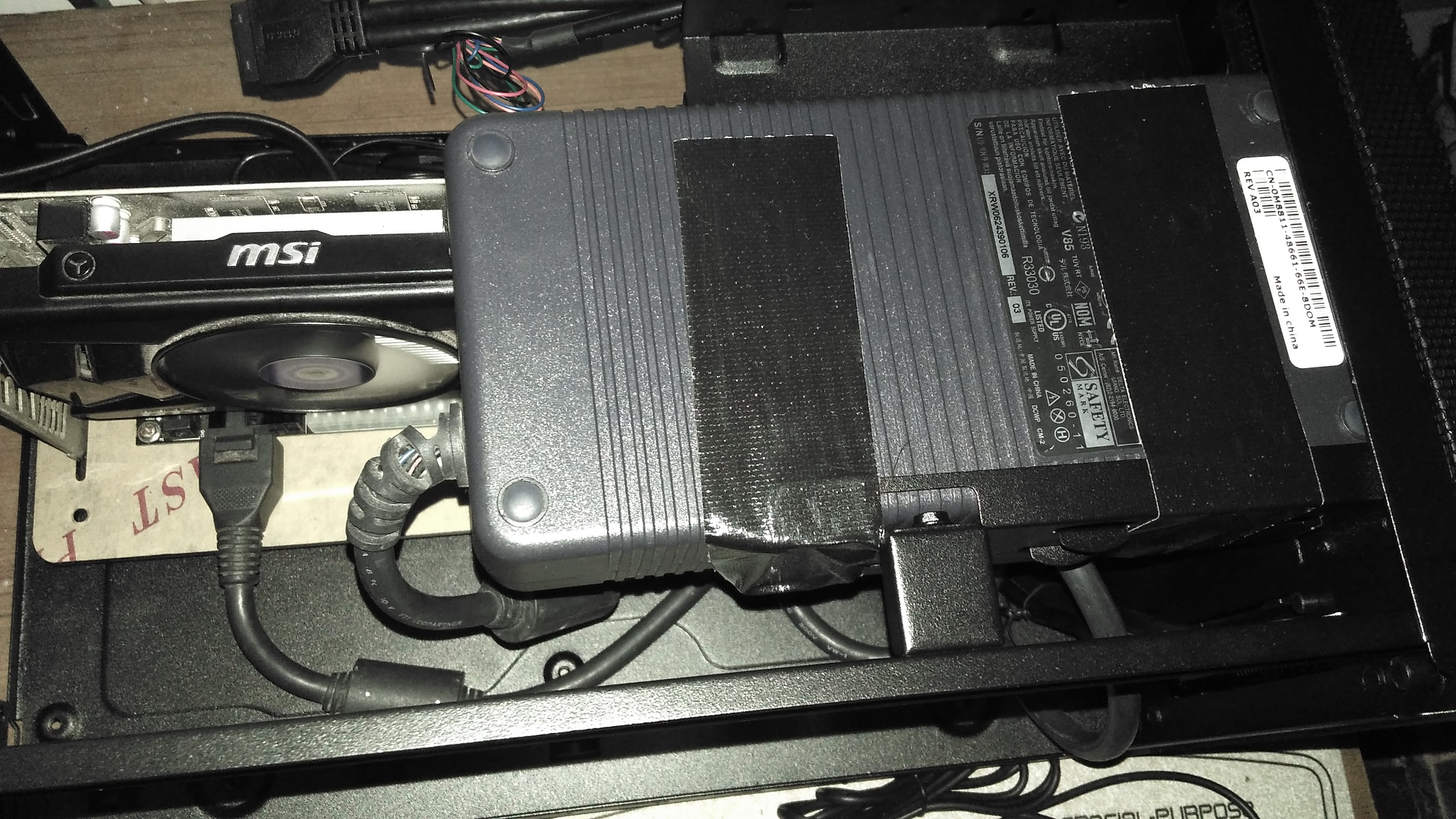

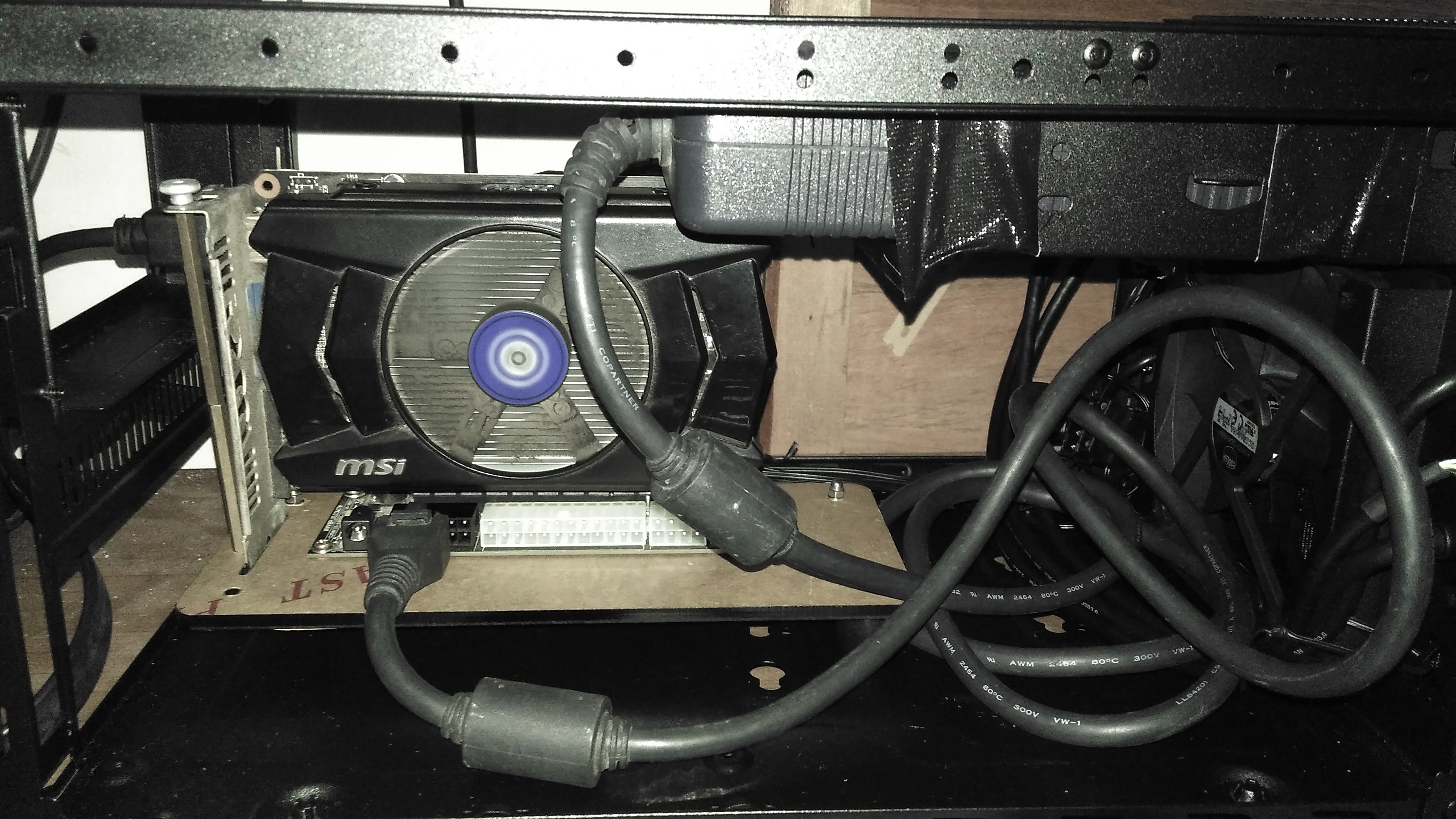

gharimanto Posted March 8, 2016 Share Posted March 8, 2016 19 hours ago, Dschijn said: Try and find this riser: DeLOCK 41788 PCIe x16 Riser You will need exactly this riser to make a 90° turn and you will need a flexible riser cable as well. OR you try and find Li-Heat Riser like this in Type-A: http://www.highflow.nl/hardware/videokaarten/li-heat-pci-e-gen-3.0-ribbon-flexible-riser-cable-black.html This is mandatory for cases like the Elite 130. Li-Heat Riser type A take IDR 500k ~ $ 38 (much expensive for student like me). I hope price of drop down. And now, I'm use a single flexible riser Spoiler But, the performance goes drop down. Firestrike testing was crash The Witcher 3 got half performance ( normally 30-44 FPS, but now only 12-15 FPS) So that, I decided to put PE4C with board into the case and Dell DA-2 too. Spoiler Spoiler Spoiler Link to comment Share on other sites More sharing options...

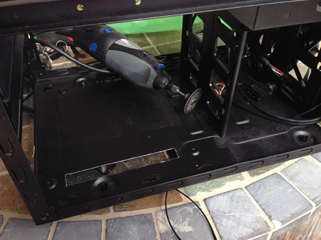

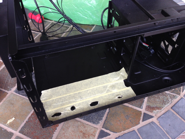

Arise Posted March 8, 2016 Share Posted March 8, 2016 I cut with the dremel in the bottom of my CM120 so I can make room for the extender to go through and return with the cable back. Sent from my iPhone using Tapatalk Link to comment Share on other sites More sharing options...
gharimanto Posted March 8, 2016 Share Posted March 8, 2016 3 hours ago, Arise said: I cut with the dremel in the bottom of my CM120 so I can make room for the extender to go through and return with the cable back. Sent from my iPhone using Tapatalk Nice, But I won't my case bleeding 1 Link to comment Share on other sites More sharing options...
Arise Posted March 8, 2016 Share Posted March 8, 2016 Couldnt find a better solution at that time. So I went ahead and made that hole to let the extender non flexible part some space. Sent from my iPhone using Tapatalk 1 Link to comment Share on other sites More sharing options...
Scooter Posted March 14, 2016 Share Posted March 14, 2016 Hi, very happy with the combination of a Milo ML08 from Silverstone, Highpoint RocketStor 6361A Thunderbolt 2 PCIe, and Silverstone SFX-L 80+ Gold 500W Modular Power Supply. Using the supplied riser from Silverstone, it is possible to mount the naked Thunderbolt PCIe card on the other side of the bay that holds the GPU, if you can insulate it, as the power pins from the molex connector are very close to the divider. As you will have to cut a hole to access the Thunderbolt connection, I chose to cut out a gap in the divider to prevent the possibility of anything shorting. I also had to do a bit of modding to get the pipes through for a Hybrid EVGA 980ti, so I always knew that there would be some cutting involved. Bonus with the Highpoint case is that is perfectly in tact, so it could be re-purposed in the future, and it is the same price as the AKiTiO at B&H. Oh and ofcourse, the power is supplied via 2 molex connectors for the Silverstone PSU, so none of the modding to the power supply is required. Its a very neat set up. Cheers 1 Link to comment Share on other sites More sharing options...

Scooter Posted March 20, 2016 Share Posted March 20, 2016 Here is the case build in pictures Cheers Link to comment Share on other sites More sharing options...

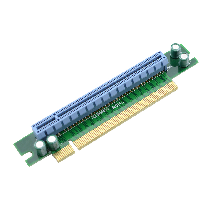

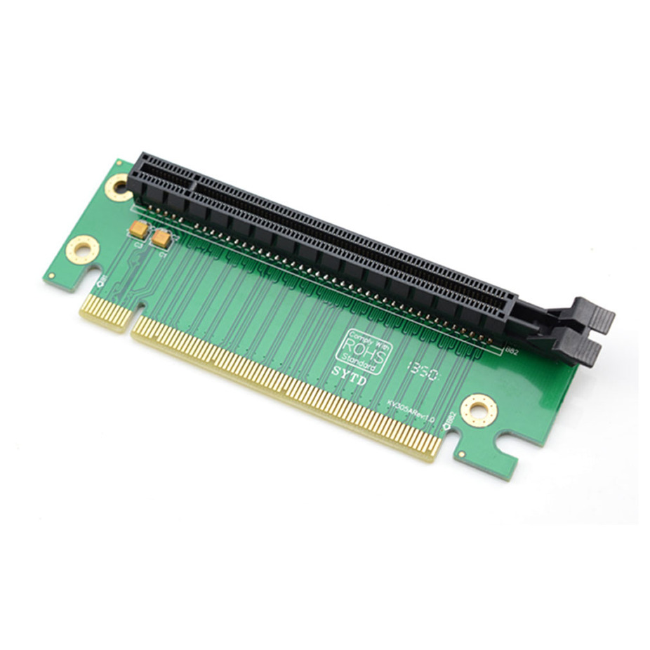

shirazigs Posted April 10, 2016 Share Posted April 10, 2016 (edited) I've found these that I can order from Canada. I wanted to know if these are Ok. PCI-E Express 16X 90 Degree Adapter Riser Card For 1U Computer Server Chassis UL http://www.ebay.ca/itm/PCI-E-Express-16X-90-Degree-Adapter-Riser-Card-For-1U-Computer-Server-Chassis-UL-/161868305414?hash=item25b01a5406:g:giAAAOSw~bFWK4E- PCI-E Express 16X 90 Degree Adapter Riser Card For 2U Computer Server Chassis UF http://www.ebay.ca/itm/PCI-E-Express-16X-90-Degree-Adapter-Riser-Card-For-2U-Computer-Server-Chassis-UF-/371472631839?hash=item567d7e881f:g:2bYAAOSwT5tWLg7L New PCI-Express PCI-E 16X Riser Card Ribbon Extender Extension Cable EA http://www.ebay.ca/itm/New-PCI-Express-PCI-E-16X-Riser-Card-Ribbon-Extender-Extension-Cable-EA-/252065399975?hash=item3ab044c4a7:g:TfYAAOSwT6pV2CwF THANKS Edited April 11, 2016 by shirazigs Link to comment Share on other sites More sharing options...
