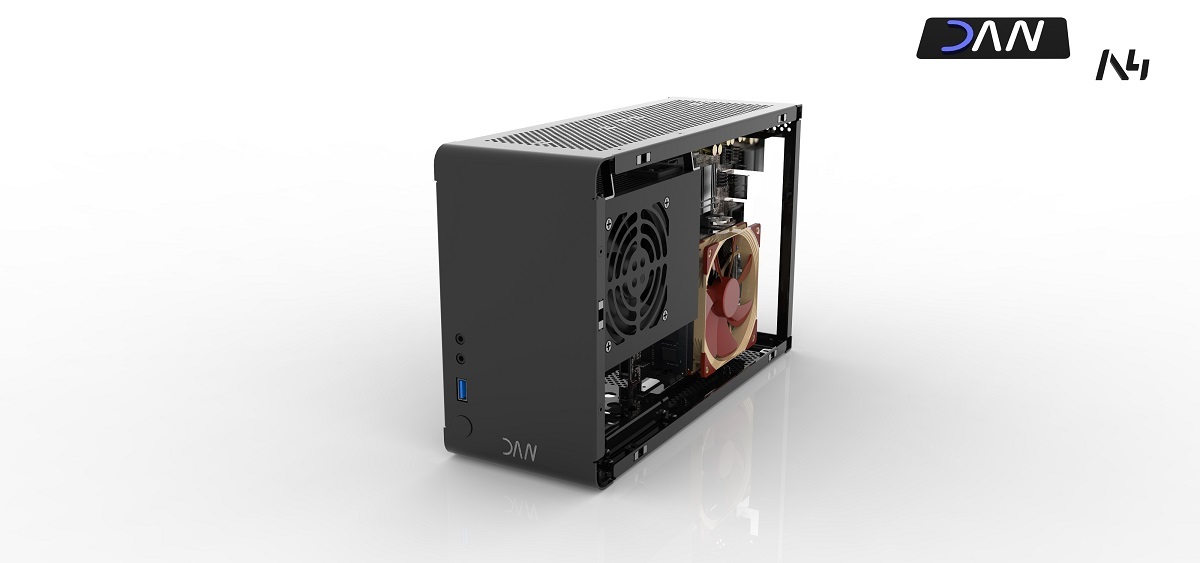

sforma 16 Posted January 12, 2015 I would like to add also: the coming A4. A4: The smallest gaming case series in the world - Page 41 - [H]ard|Forum Quote Share this post Link to post Share on other sites

ithildin 40 Posted January 20, 2015 I'm using the Silverstone Sugo SG05. It looks bigger in the pictures that it actually is. The footprint is about that of a shoe box, 10.8L volume-wise, can take a 10 inch long GPU (maybe even 10.5 inch one) and is fairly inexpensive (I got mine for less than $30). Unfortunately full length 11-inch cards won't fit but the Sugo SG05 can modded to be accommodate one by cutting the inner metal panel. The new Sugo SG13 is supposed to have an extra .5 inch of clearance and may be a better option at this point.There isn't enough clearance at the bottom of the case to connect a standard powered PCIe x16 ribbon cable to the GPU so I'm also using a Supermicro RSC-R1UG-E16R-X9 right angle PCIe adapter.For PSU, I'm using the Silverstone ST45SF-G 450W SFX 80+ Gold v2.0. It's got a nice max 37A on the 12V rail (which should be enough for any GPU) and is fairly quiet - just make sure not to get the v1.0 which suffered from a noisy fan. V2.0 has a new fan and smoother speed ramping.I would like to add also: the coming A4.A4: The smallest gaming case series in the world - Page 41 - [H]ard|Forum[ATTACH=CONFIG]13584[/ATTACH]That A4 looks gorgeous. I might get one myself to try out as an eGPU case. 1 Quote Share this post Link to post Share on other sites
bigdaniel 13 Posted January 21, 2015 Thank you, that you like my design Here are some more pictures: (This picture is only for demonstrate a view trough all components) 3 Quote Share this post Link to post Share on other sites
intelligence 14 Posted January 22, 2015 Thank you, that you like my design Here are some more pictures: Really nice work with the case! Would be all kinds of amazing if you'd use your skills to provide a custom chassi with small foot print for the Akitio 2 (1U or perhaps external brick). I'd gladly pay for a neat solution and I'm sure other would too. Quote Share this post Link to post Share on other sites
ithildin 40 Posted January 23, 2015 Thank you, that you like my design Here are some more pictures: It's a great design! I'm really looking forward to your crowdfunding campaign. I understand that you are going for a high quality part with the 3M PCIe adapter but I'm guessing it's not powered unlike the ones most people here use for their eGPUs. Do you think you could sell the A4 case without the 3M PCie extender? I'm thinking of trying to fit a powered PCIe ribbon cable in the A4 and seeing if it's stable enough for a x4 PCIe 2.0 link. I guess modding the the 3M extender cable is also an option but the idea of trying to solder some power leads to a $80+ extender makes me a bit nervous. Quote Share this post Link to post Share on other sites
bigdaniel 13 Posted January 27, 2015 @intelligence: Maybe for my next project, but i think it would be only intersting if egpu industry release singl buyable thunderbolt boards. @ithildin: Yes this would be possible , but you have to wait for the crowdfunding campaign. Quote Share this post Link to post Share on other sites

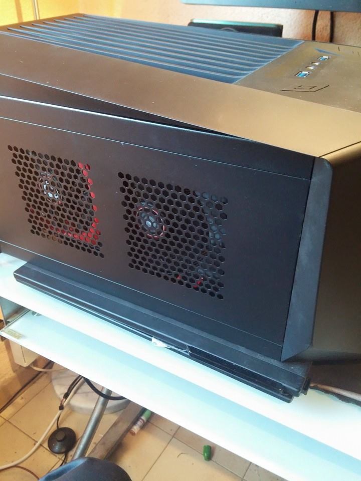

Riri-Fifi 101 Posted April 2, 2015 Hi My Egpu case Xigmatek Octans PE4H 2.4 Lepa 450W GTX 980 Gaming 4Go - - - Updated - - - http://www.3dmark.com/3dm11/9637802 1 Quote Share this post Link to post Share on other sites

Dschijn 329 Posted April 27, 2015 These cases seem fine, maybe a litle "big". The EVGA Hadron is interesting, because it already has a slim 500W PSU in the case.Daniel will get some prototypes of the A4 within this or the next 1-2 weeks. So it's close to production start, but seem might be available in the summer. Quote Share this post Link to post Share on other sites

Dschijn 329 Posted September 21, 2015 Here is a first Review of the DAN A4.translated: https://translate.google.com/translate?sl=de&tl=en&js=y&prev=_t&hl=de&ie=UTF-8&u=http%3A%2F%2Fwww.computerbase.de%2F2015-09%2Fdan-cases-a4-sfx-im-test-das-kleinste-gaming-gehaeuse-der-welt-kann-was%2F&edit-text=german: DAN Cases A4-SFX im Test: Das kleinste Gaming-Gehäuse der Welt kann was - ComputerBase Quote Share this post Link to post Share on other sites
