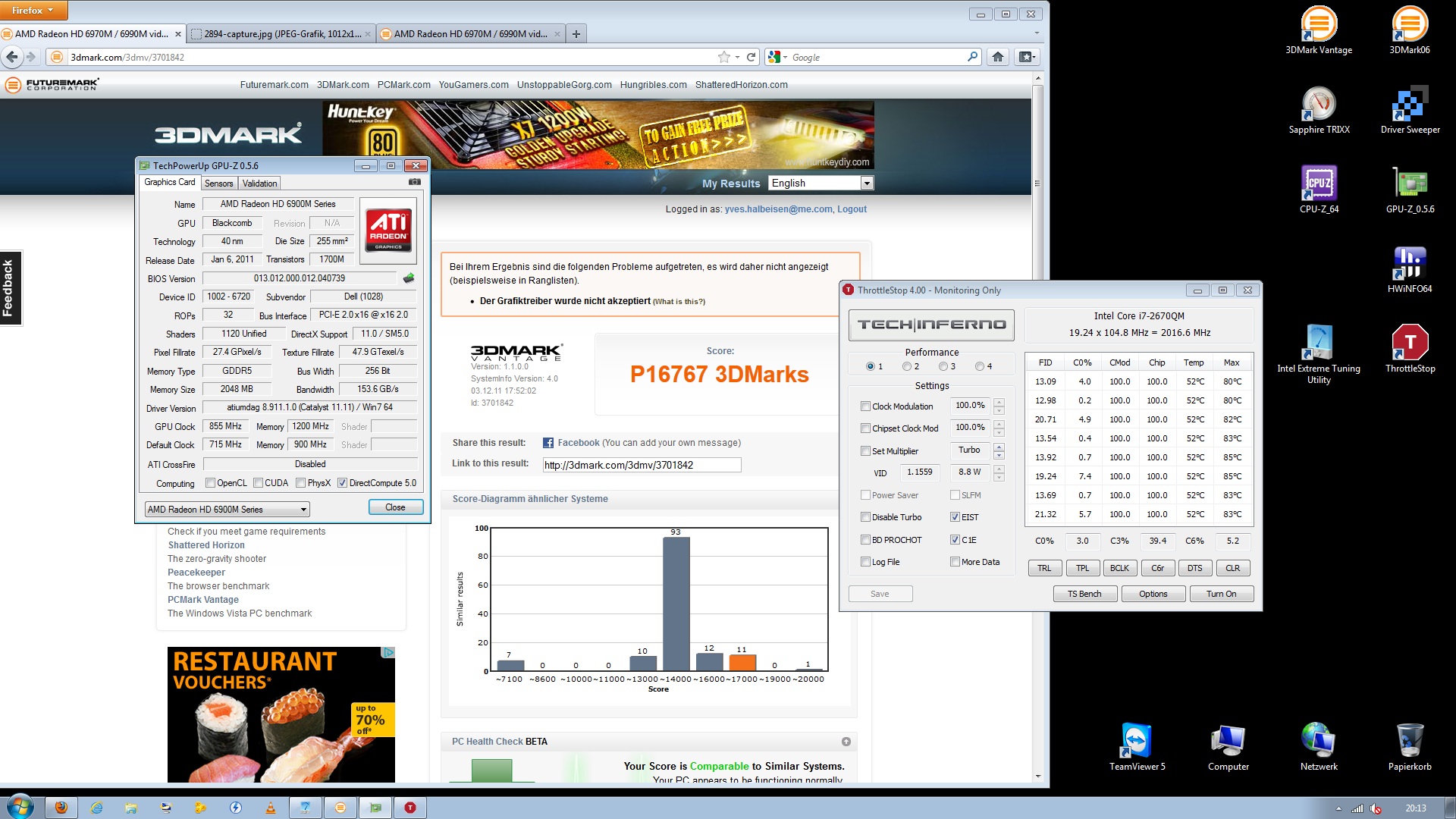

3dMark11 -- P4457 (6990M @ 830/1150/2820QM)
3dMark Vantage -- P16,578 (6990M @ 845/1200/2820QM)

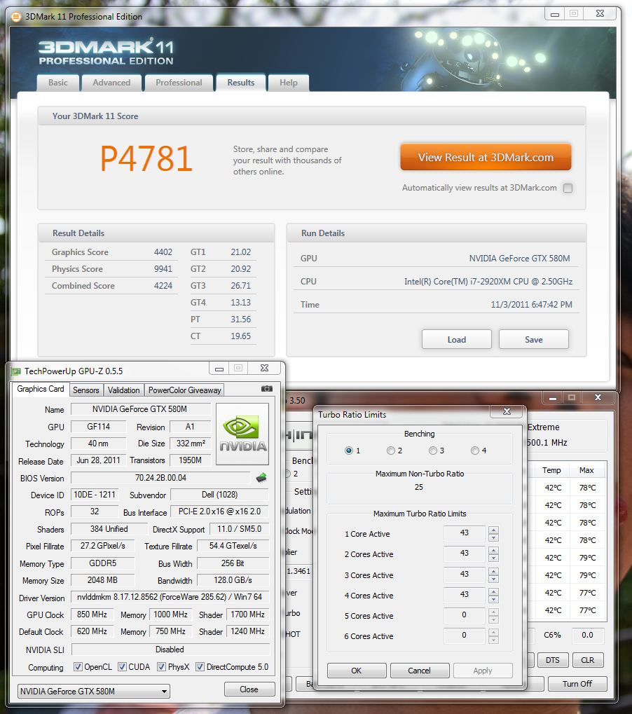

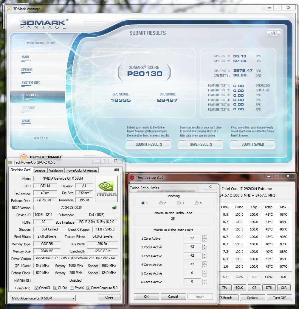

Finally managed to hit the 880Mhz on the GTX580M. Vbios is modded to 0.92V, using System Bios A08, Forceware 290.36.
No CPU overclocking, stock cooling, repasted with Arctic Silver 5 and using Notebook Cooling Pad

That is a very very good overclock. I don't think I can hit that. Mine pussies out at 850Mhz. I'll try and push harder but I really don't see it happening. Nice score. I could not hit 18k GPU score with a i7 2630QM so well done :)

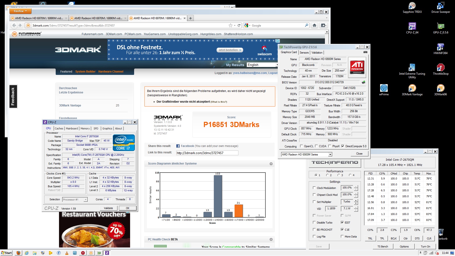

Did a Vantage run today, I set the Clock in Intel XTU to 105MHz.

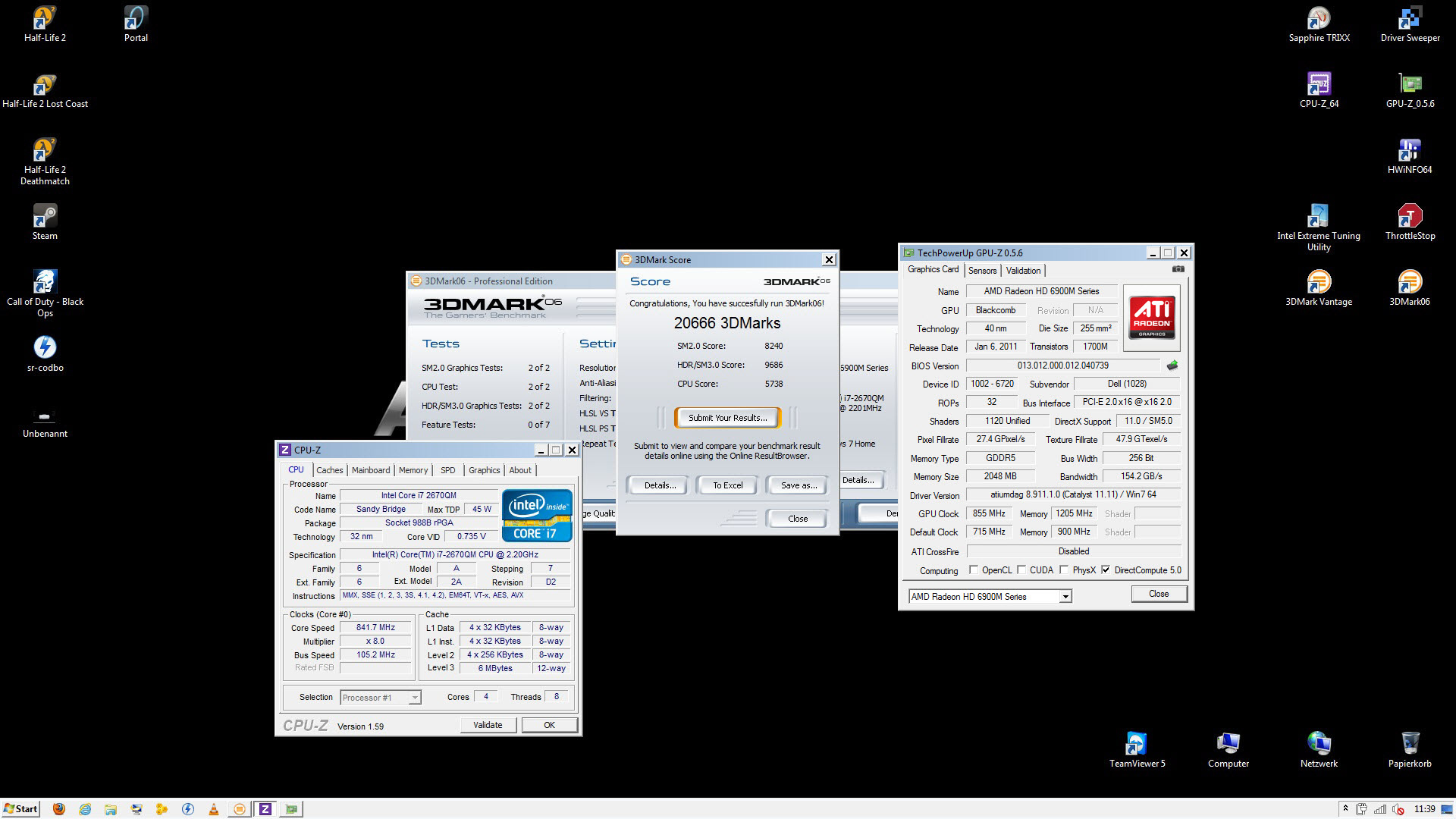

What do you think about the result? in 3D Mark 06 I got 20769, but I can't have the 6990 set as high as in a Vantage run, because other wise 3D Mark will crash.
BTW, still haven't repasted... ;)

That's pretty good for a non-XM system. I've seen 18k from a 2960xm + 580M but obviously it was the CPU helping them in that case. Good job.
