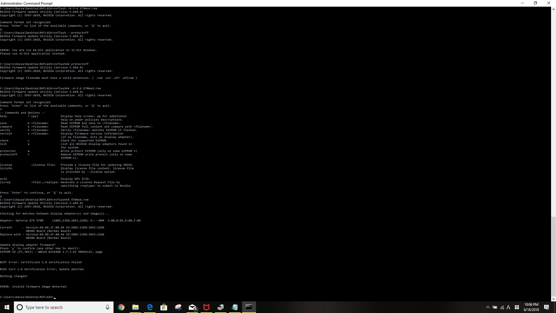

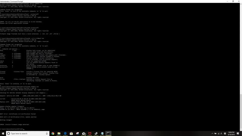

Update: I was finally able to flash the vbios by using -i o -6 commands and everything seemed to go well, even the prompt said it was successful.. Then I went to enable the gpu in device manager and the whole pc froze. I did a hard restart and now in device manager it says that Windows has disabled 980m because of problems. I tried reflashing but of course its being a b*tch like it was before and not letting me.

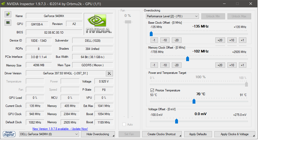

can you make a modified vbios for GTX 940MX 4GB on my dell inspiron 7570 ?
In this laptop, the throttle temperature is set at 70 °C, and i want it to reach more than 70 °C.
can you please help me ?

Hi
Your bios is write protected, therefore any modified bios can be flashed by using hardware SPI programmer only.

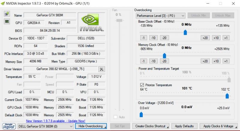

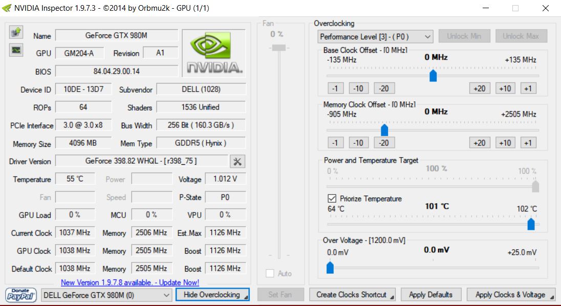

Hi Klem !
Sorry to bother you, but I saw that you already helped several members with similar requests, so I thought that you could also help me too by any chance !
I have a 2015 release of the AW 15, 980m 4gb, bios A06 and for the last 3 years, I didn't experience any problem related with performances in-game. However, recently, i've had to face throttleling issues which, aparently, are not uncommon on this rig. Two years ago I downloaded a modded Vbios by Prema, just in case, but I'm affraid I lost the file and for some reason (which is probably a good one), Prema stopped sharing his work with the community.
If I had the skills, I would have modded my bios by myself but I'm affraid to f...up my laptop. So I figured you could help with that ?
Thanks for your pain !
