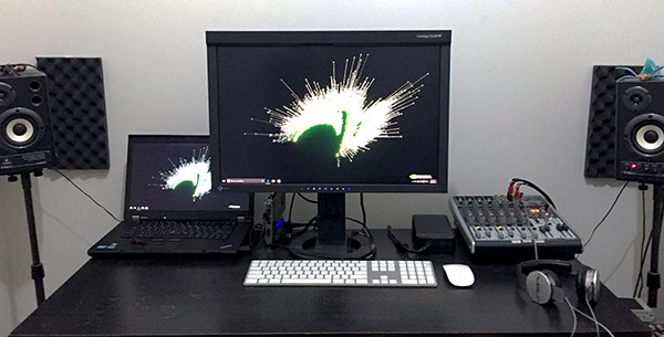

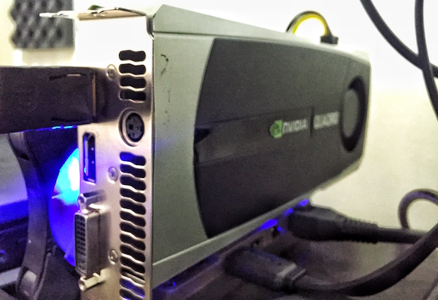

I have managed to make iGPU runs for my internal and eGPU Quadro 4000 for Mac 2GB for my External monitor
But this doesn't work when i use Quadro 6000 6GB. Output display only goes to eGPU
Both setup has no issue for lid closed, and restart or sleep while it closed
