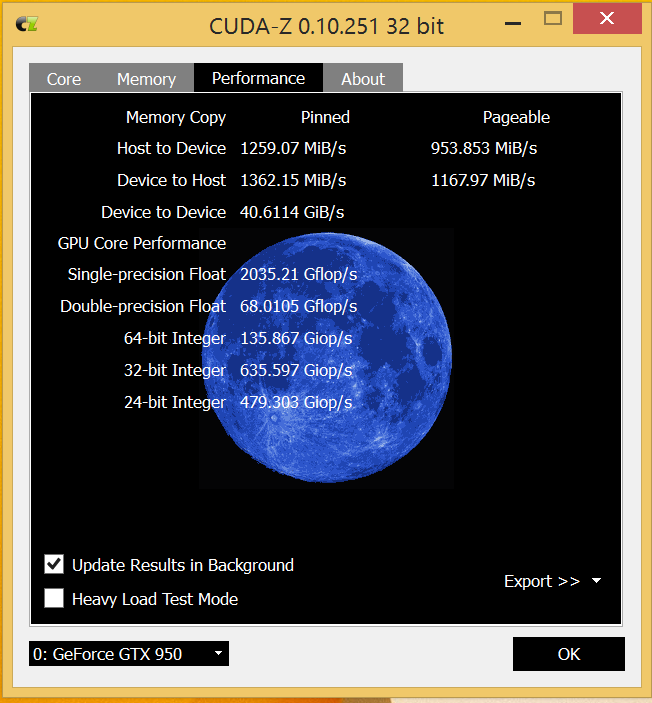

THOMASRAJA Posted December 14, 2015 Share Posted December 14, 2015 Hi all, Now, I do my first eGPU with my setup : 2015 rMBP 13" with Intel Iris 6100 and 2,7Ghz i5. My eGPU is an EVGA GTX 950 2go in an Akitio enclosure with a corsair 430 PSU My problem is, when I boot in win 8.1 (to have Optimus) everytime I hva a Black Screen or the Windows Boot circle and after 10 minutes a black screen... Before doing this EFI mod I can boot into win 8.1and I saw my GTX 950 but I can only set Iris 6100 for the internal display EDIT : I do a clean install of all and I reinstall Os X 10.10 instead of 10.11.2 (to try) I'll install Windows 8.1 via Bootcamp and try to set GTX 950 for my internal screen. How to see if the eGPU works on internal screen ? In PhysX ? (Sry for my bad English... ) Quote Link to comment Share on other sites More sharing options...
tusctodd Posted December 17, 2015 Share Posted December 17, 2015 On 12/14/2015 at 2:45 AM, THOMASRAJA said: Hi all, Now, I do my first eGPU with my setup : 2015 rMBP 13" with Intel Iris 6100 and 2,7Ghz i5. My eGPU is an EVGA GTX 950 2go in an Akitio enclosure with a corsair 430 PSU My problem is, when I boot in win 8.1 (to have Optimus) everytime I hva a Black Screen or the Windows Boot circle and after 10 minutes a black screen... Before doing this EFI mod I can boot into win 8.1and I saw my GTX 950 but I can only set Iris 6100 for the internal display EDIT : I do a clean install of all and I reinstall Os X 10.10 instead of 10.11.2 (to try) I'll install Windows 8.1 via Bootcamp and try to set GTX 950 for my internal screen. How to see if the eGPU works on internal screen ? In PhysX ? (Sry for my bad English... ) Under Windows 8 on the 2015 series macbook pros, you have to wait for the spinning balls to start BEFORE you turn on your EGPU. This works about 95% of the time depending on my timing to turn the EGPU on. If you turn it on too soon you will black screen. If you turn it on too late Windows will crash due to a driver error. DO NOT install the optimus EFI hack used for pre-2015 models. It is not required and may cause more problems. Quote Link to comment Share on other sites More sharing options...

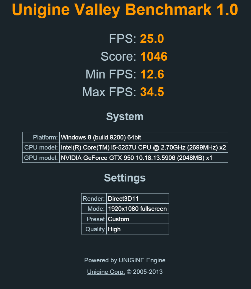

THOMASRAJA Posted December 17, 2015 Share Posted December 17, 2015 Hi, finally it works, I plug the tb cable on the same time of the boot chime and it works 100% of time ! I run Unigine Valley Benchmark in full screen 1920x1080 on internal screen and I have a score of 850 it is normal ? Quote Link to comment Share on other sites More sharing options...
Dschijn Posted December 17, 2015 Share Posted December 17, 2015 Are you running at stock settings with the GPU, so no overclock? With my overclocked 970 I get in Optimus mode more than 2000 points. So your results could be right, just seem a bit low. Maybe the Dual Core CPU of you is affecting the results as well. Quote Link to comment Share on other sites More sharing options...

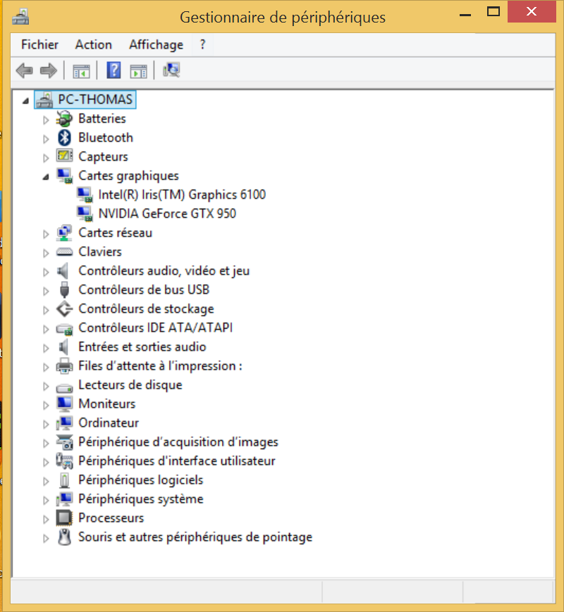

tusctodd Posted December 18, 2015 Share Posted December 18, 2015 6 hours ago, THOMASRAJA said: Hi, finally it works, I plug the tb cable on the same time of the boot chime and it works 100% of time ! I run Unigine Valley Benchmark in full screen 1920x1080 on internal screen and I have a score of 850 it is normal ? Check your device manager. Even though the device shows up in the list, it may not have a driver loaded. Quote Link to comment Share on other sites More sharing options...
THOMASRAJA Posted December 18, 2015 Share Posted December 18, 2015 5 hours ago, tusctodd said: Check your device manager. Even though the device shows up in the list, it may not have a driver loaded. Yes the device is show as u can see on attach files.. 9 hours ago, Dschijn said: Are you running at stock settings with the GPU, so no overclock? With my overclocked 970 I get in Optimus mode more than 2000 points. So your results could be right, just seem a bit low. Maybe the Dual Core CPU of you is affecting the results as well. I'm running on stock settings. Today i run the test again and my score is 1046. I attach the CUDA Z and Valley benchmark result. Quote Link to comment Share on other sites More sharing options...
Dschijn Posted December 18, 2015 Share Posted December 18, 2015 Seems right to me... Here is a GTX950 running in a PC and scores 1200. So the difference is due to the Optimus loss: Quote Link to comment Share on other sites More sharing options...
THOMASRAJA Posted December 18, 2015 Share Posted December 18, 2015 30 minutes ago, Dschijn said: Seems right to me... Here is a GTX950 running in a PC and scores 1200. So the difference is due to the Optimus loss: Ok nice ! In 2016 i will buy an external screen Thanks for u'r reply ! Quote Link to comment Share on other sites More sharing options...
