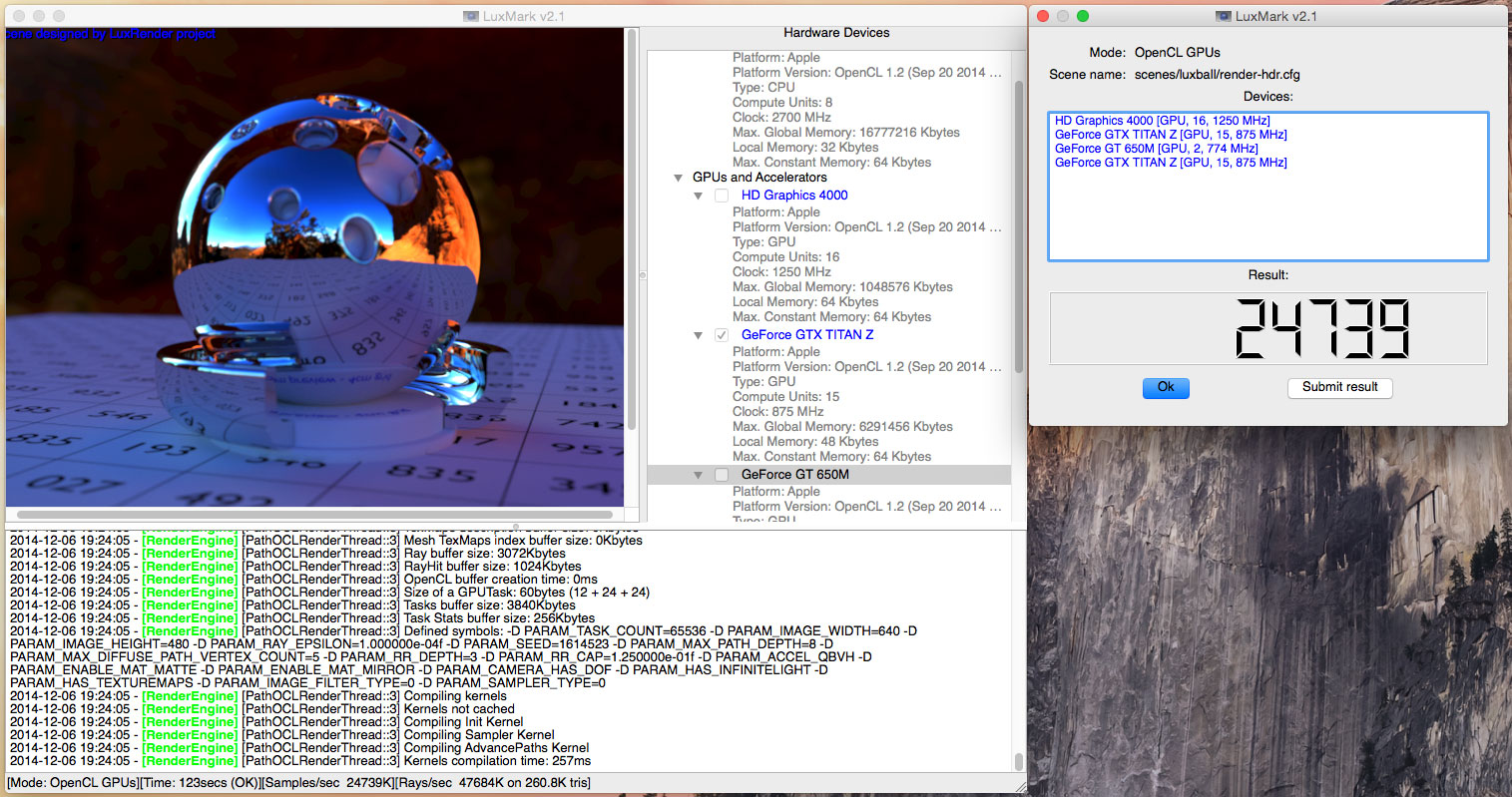

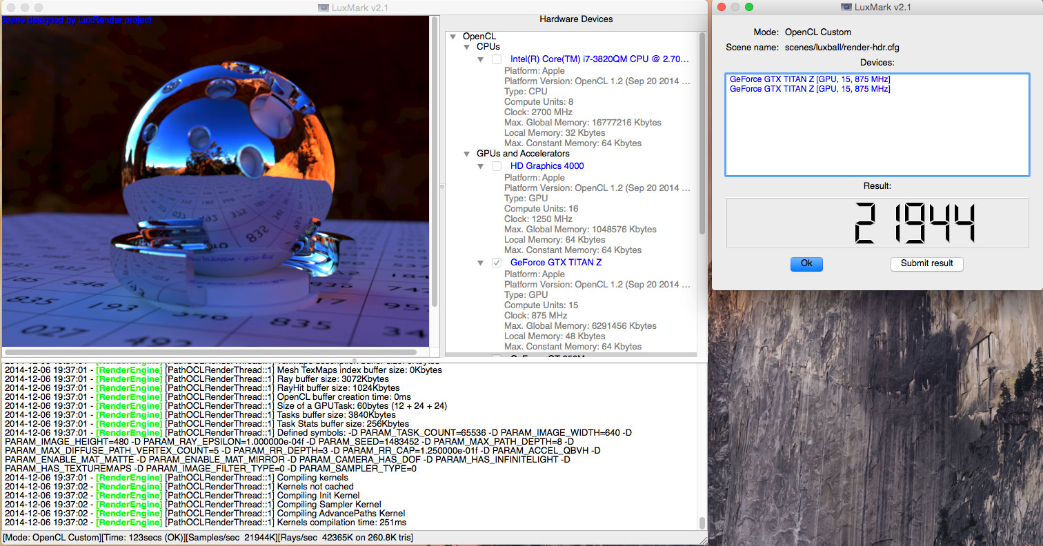

I think that answers the question. The prompt lists what is used in the test. It was just the Titan Z. Here's another that includes the 750M. This seems like exactly what the scores would be if only 1 core was being used. Thanks for this. I had been scouring for info but the benchmark thing seemed like it would not bring me the answers I was looking for. Glad I did it!
http://www.mediafire.com/view/acu3y6cxac3nf4t
another member just posted in the Octane forums a screenshot of both Titan Z cards loaded with drivers so I know it's possible. :) I'll give an update.
Simple File Sharing and Storage.

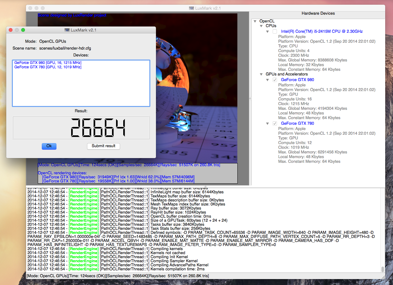

I think you should have stayed with 780. OS X can't use both cores it seems.
Here is a single Titan Black on a 1.4Ghz Mini
Note that if you drag the score Window to left (over the ball) then everyone can see what was tested.
I'll plug in a 2nd Black and update this.
UPDATE: 2nd Black nearly doubled score. Fast cards.

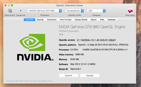

Would you tell what enclosure/PCIe board you used with your Mac mini setup running two Titan Blacks? It might be possible with two AKiTiOs.
Mac mini (Mid 2011) performs amazingly well with a single TB cable connected to NA211TB + EVGA GTX780 6GB OC + Gigabyte GTX980 reference card. I guess two GTX980s would show better score than two Titan Blacks. Even though GTX980 is primarily meant for accelerated graphics, it is a fast card on CUDA applications. AnandTech says “So per CUDA core, GTX 980 delivers over 2x the LuxMark performance of GTX 780 Ti”.
AnandTech | The NVIDIA GeForce GTX 980 Review: Maxwell Mark 2
Steam gaming was also possible on 4K@60Hz display.
