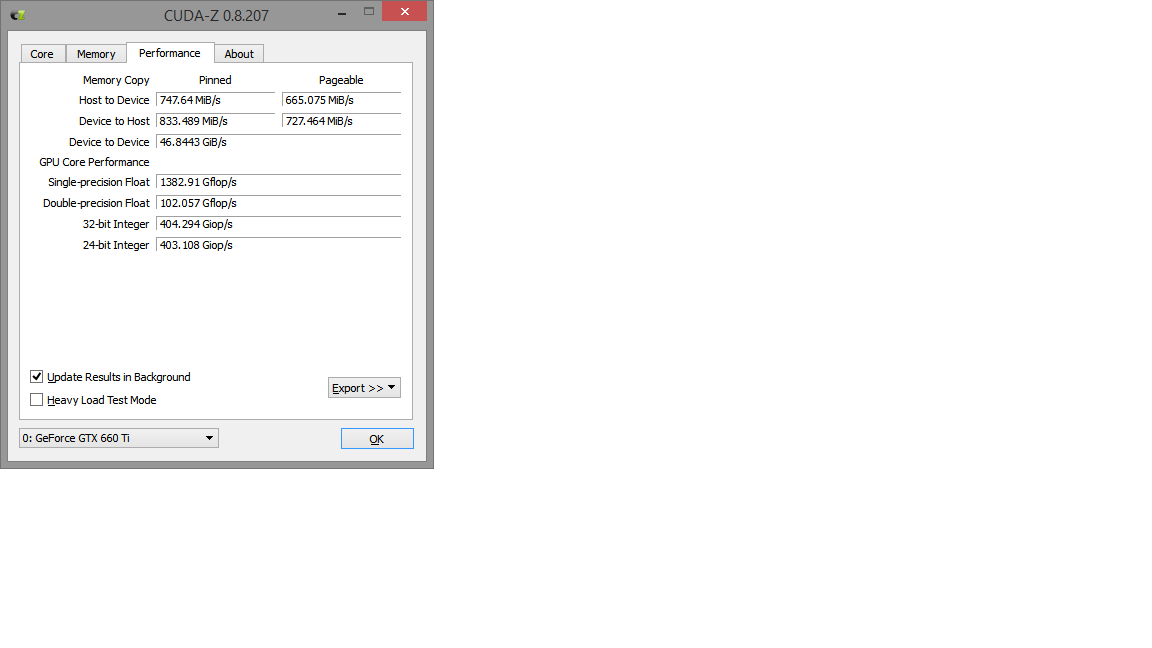

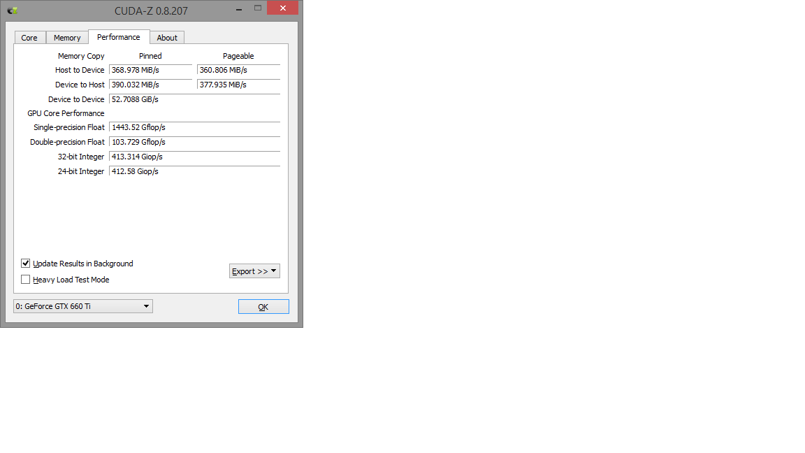

Not sure if you guys have been testing some more, but I managed to the 660ti running somewhat stably in the Akitio. I purchased a new riser (PCI E Express x16 to 16x Molex Powered Riser Adapter Card Safer Version | eBay) and the 660 now stays up under load now.
I say somewhat stably, because all I tested so far was the suite of 3dmarks. I am now running into an issue of performance. Everything seems to see the extra PCIe lanes from the Akitio, but the performance is less than the PE4L.
CUDA-Z does show the increase in bandwidth (747.64 MiB/s vs 368.978 MiB/s) but all 3dmarks are a few hundred points lower than the PE4L. I'm not ruling out a video card, so I got a friend to send me his spare 580 to test.
3dmark11 (PE4L) - 6514 NVIDIA GeForce GTX 660 Ti video card benchmark result - Intel Core i7-3520M,LENOVO 2352CTO
3dmark11 (Akitio) - 5682 NVIDIA GeForce GTX 660 Ti video card benchmark result - Intel Core i7-3520M,LENOVO 2352CTO

[ATTACH=CONFIG]13050[/ATTACH][ATTACH=CONFIG]13051[/ATTACH]
Wow! First Lenovo T430s TB1 eGPU implementation. Congratulations.
Strange bench results. I would have expected the reverse of the scores you are seeing - the AKiTiO to be faster than the PE4L. You could cellophane tape lane2-4 on the GTX660Ti as shown then insert in the AKiTiO. Doing so would force a 4Gbps+c (formerly x1.2Opt) link, same as your PE4L 2.1. x1 PCIe compression might be skewing the results to be better than on a 10Gbps link.
