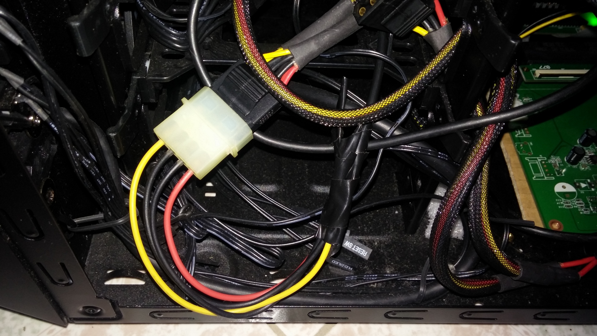

[GUIDE] Making a molex-to-barrel adapter
linh1987 replied to jacobsson's topic in Enclosures and Adapters
Actually it's a very simple mod. I have a barrel plug handy so what I did is cut it out, separate the outer and inner wire, twist outer wire with molex's black ground and the inner wire with molex's 12v yellow and that's it. The other 2 wires of (red and black) are unused. In use the barrel plug is connected to Akitio board, the riser is UNPOWERED. I'm not sure it we should also power the riser but I have it running fine for me up til now (9 hours without any crash). My barrel plug has a very clear outer/inner wiring so it's a piece of cake. If it's 2 wires setup like above then I recommend you carefully do testing before wire them together -
linh1987 replied to Tech Inferno Fan's topic in Enclosures and Adapters
I think I found the problem, probably is because of my powered riser. I finished the molex to barrel mod and now running with Akitio and VGA being powered by the barrel connector (and a 6 pin pcie). The voltage is much more stable than using the powered riser (although I replaced it with another one before). With the powered riser and Furmark, the voltage and power consumption fluctuate a lot between 80-100%, but with barrel connector, the power consumption stays flat at 100%. I will get back to you guys if I get any problem. -
