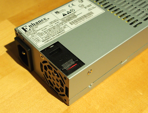

Dschijn Posted November 4, 2014 Share Posted November 4, 2014 Great news and great guide. thx!But the fan noise is a no go imho… Quote Link to comment Share on other sites More sharing options...

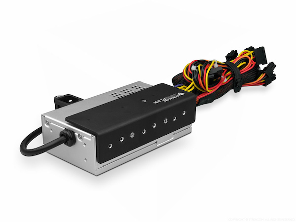

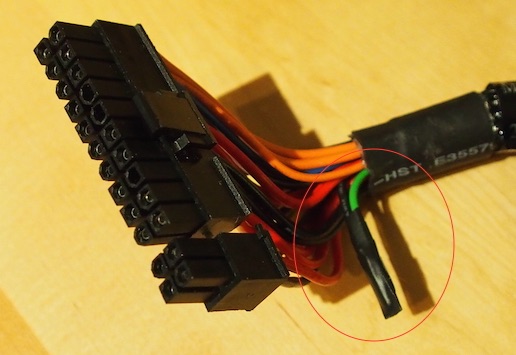

euqlaog Posted November 11, 2014 Author Share Posted November 11, 2014 I figured out that this box is really the modder’s dream in addition to the 24pin power connector: a standard Flex ATX PSU (150mm x 81.5mm x 40.5mm), which is easily replaceable. The PSU length can be much more than 150mm because no obstacles at the bottom space. Streacom has just released a fanless 240W PSU: ZF240 – Fanless 240W ZeroFlex PSU | Streacom With this PSU, the only audible component would be the GTX 980 reference blower, which has pleasant soft “whoosh” sound. I already sent an enquiry and waiting for the answer if it’s possible to use splitters to feed up to 75W for two 6pin plugs via MOLEX and SATA. I am a bit worried as the specs says 12V@14A. The highest peak I saw was 205W under 3DMark11 and Fire Strike with the NA211TB + GTX 980 when metered from the power strip. The reference GTX 980 draws only 177W/185W under gaming/torture test according to this review: Nvidia GeForce GTX Watchdogs Results If the fanless PSU won’t work, there are still other Flex ATX PSUs to choose from, for example this: FSP Europe - Fortron Source - Professional Does anyone have experience of some Flex PSU to recommend? Preferably with two 6pin plugs. By the way, GTX 750Ti keeps the original PSU fan noise more acceptable level. Quote Link to comment Share on other sites More sharing options...
euqlaog Posted December 1, 2014 Author Share Posted December 1, 2014 Great news and great guide. thx!But the fan noise is a no go imho…I updated my post regarding the noise issue. Netstor sent me a new PSU with lower fan speed for free. That's awesome service! It's not as quiet as SFX PSU, there is that little "buzzing" at idle, but notable improvement when the GPU was stressed. I ran Valley benchmark for an hour on OS X and half an hour on Windows, and the system was stable, no sign of crash or kernel panic at 80C degrees, 2560x1140 ultra quality mode with a 4K display, enclosure's top cover placed. On windows, reference GTX 980 fan speed was 53% (~2215 RPM) after half an hour of benchmarking. 1 Quote Link to comment Share on other sites More sharing options...
alex20hz Posted January 5, 2015 Share Posted January 5, 2015 I did email Netstor support and got this:The original Fan speed will be running up and down by loading. Since the GTX 970 is requested only 145W, the fan noise will keep around 25dB. The new design is keeping fan speed on 23~24 dB for max. so it’s only different when the GPU card request over 200W.The original Fan speed will be running up and down by loading. Since the GTX 970 is requested only 145W, the fan noise will keep around 25dB. The new design is keeping fan speed on 23~24 dB for max. so it’s only different when the GPU card request over 200W. 1 Quote Link to comment Share on other sites More sharing options...

svcti Posted May 27, 2015 Share Posted May 27, 2015 I updated my post regarding the noise issue. Netstor sent me a new PSU with lower fan speed for free. That's awesome service! It's not as quiet as SFX PSU, there is that little "buzzing" at idle, but notable improvement when the GPU was stressed. I ran Valley benchmark for an hour on OS X and half an hour on Windows, and the system was stable, no sign of crash or kernel panic at 80C degrees, 2560x1140 ultra quality mode with a 4K display, enclosure's top cover placed. On windows, reference GTX 980 fan speed was 53% (~2215 RPM) after half an hour of benchmarking.Thanks for the great write up goalque. Are you able to put the top case shell back on with the gtx 980 installed, hopefully with that it doesn't run too hot? I'm interested in this model because everything i need is already included with room for another card, and if the top fits back on, it seems rugged enough to travel with me if i need. Quote Link to comment Share on other sites More sharing options...

ultrahumanite Posted June 27, 2015 Share Posted June 27, 2015 @goalque I was wondering if you'd be willing to answer a question about the dimensions of the Netstor NA211TB enclosure? From reading your post I gather that the enclosure comes with a standard Flex ATX PSU size 150mm x 81.5mm x 40.5mm. It looks like a longer (over 150mm) PSU would fit the case without any issues. It also seems like there is some room above the stock PSU so a PSU taller than 40.5mm should fit inside the case in place of the stock unit, would you mind measuring how much space is left above the 40.5mm? Thanks in advance. Quote Link to comment Share on other sites More sharing options...
euqlaog Posted June 28, 2015 Author Share Posted June 28, 2015 @goalque I was wondering if you'd be willing to answer a question about the dimensions of the Netstor NA211TB enclosure? From reading your post I gather that the enclosure comes with a standard Flex ATX PSU size 150mm x 81.5mm x 40.5mm. It looks like a longer (over 150mm) PSU would fit the case without any issues. It also seems like there is some room above the stock PSU so a PSU taller than 40.5mm should fit inside the case in place of the stock unit, would you mind measuring how much space is left above the 40.5mm? Thanks in advance.There is approximately 7mm space above the 40.5mm and if you remove the small angle iron at 150mm, you can place longer (even 300mm Flex ATX PSU). The PSU needs some space for ventilation. However, I am not aware of any fanless Flex ATX PSU which would be powerful enough. If there was a hole at the bottom and 8cm slim PSU intake air/exhaust fan, that would be ideal. Quote Link to comment Share on other sites More sharing options...
ultrahumanite Posted June 30, 2015 Share Posted June 30, 2015 There is approximately 7mm space above the 40.5mm and if you remove the small angle iron at 150mm, you can place longer (even 300mm Flex ATX PSU). The PSU needs some space for ventilation. However, I am not aware of any fanless Flex ATX PSU which would be powerful enough. If there was a hole at the bottom and 8cm slim PSU intake air/exhaust fan, that would be ideal.Okay, thanks for the info. I was hoping to use a 500w PSU, 200x82x53mm dimensions, I guess it won't fit. Quote Link to comment Share on other sites More sharing options...
