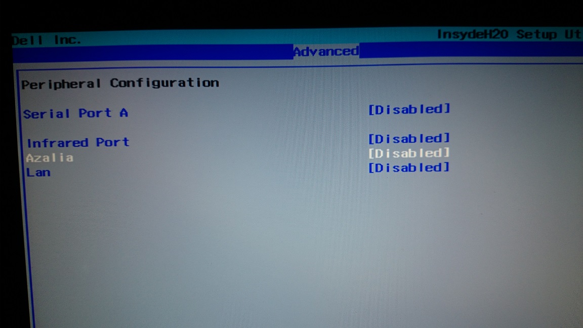

TBoneSan Posted February 25, 2015 Share Posted February 25, 2015 Yes I disabled Serial Port A & Azalia. I also double checked the HDMI was worked before hand.. 1 Quote Link to comment Share on other sites More sharing options...
J95 Posted February 25, 2015 Share Posted February 25, 2015 Yes I disabled Serial Port A & Azalia. I also double checked the HDMI was worked before hand.. Hopefully it's one of the other settings then, since it's partially disassembled already, try disabling Serial Port A & Azalia and forget the other settings. If it works it will be really easy to flash the cards using an external drive/esata or drive swapping. @J95 damn you've finally solved it Now I'm Alienwareless!!!! Lookin forward to my new Clevo P570WM Yep, flashing the cards. Throttling...is just a temporary solution unfortunately, like everything 980M related, it ends once you raise clocks. Quote Link to comment Share on other sites More sharing options...
TBoneSan Posted February 25, 2015 Share Posted February 25, 2015 From memory the only other setting would be have been "disable lan"...? I had already put it back together otherwise I would have tried. I needed to use my machine... too little time on my end tonight , I didn't expect to be doing a tear down . 1 Quote Link to comment Share on other sites More sharing options...
J95 Posted February 25, 2015 Share Posted February 25, 2015 Thanks for trying, 120Hz AWs limited for now. Added 'backup card' requirement. 1 Quote Link to comment Share on other sites More sharing options...

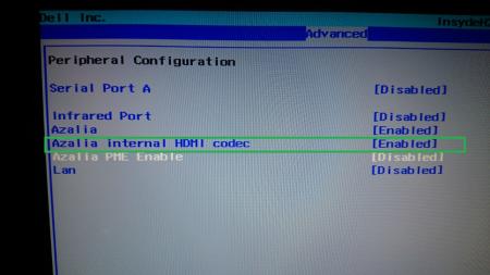

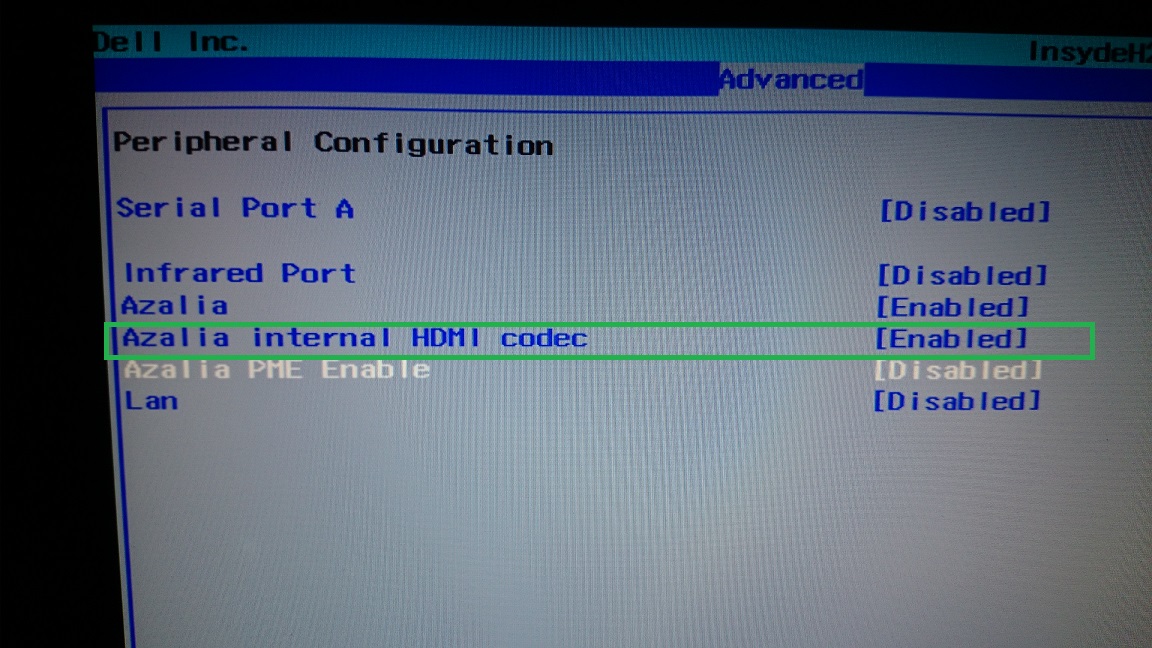

TBoneSan Posted February 25, 2015 Share Posted February 25, 2015 @J95 - It was worth the try still bud . I appreciate what you're trying to do for us all. Here was the selection I tried. I just went back into the BIOS then to make sure If Azalia is left enabled, it's possible to Enable "Azalia Internal HDMI codec" which is normally disabled...? Would have that been why I got an 8 beeb error perhaps? 1 Quote Link to comment Share on other sites More sharing options...

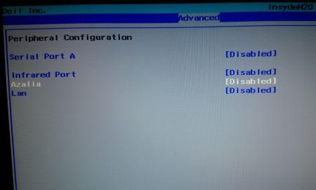

J95 Posted February 25, 2015 Share Posted February 25, 2015 hey guys. just installed 980m in m18x r2 today and noticed it is also flickering at unengine page, actually in 2 different machines - same result.can anyone look? https://unigine.com/products/valley/ That's normal 60Hz, setting 120Hz and the flickering is gone. @J95 - It was worth the try still bud . I appreciate what you're trying to do for us all.Here was the selection I tried. [ATTACH=CONFIG]14220[/ATTACH] I just went back into the BIOS then to make sure [ATTACH=CONFIG]14221[/ATTACH] If Azalia is left enabled, it's possible to Enable "Azalia Internal HDMI codec" which is normally disabled...? Would have that been why I got an 8 beeb error perhaps? Yep, correct settings pic1, all disabled. If there's any HDMI connection issue it will start beeping, the external monitor will stay blank but not the laptop. Enabling 'Azalia Internal HDMI codec' probably won't help. Quote Link to comment Share on other sites More sharing options...

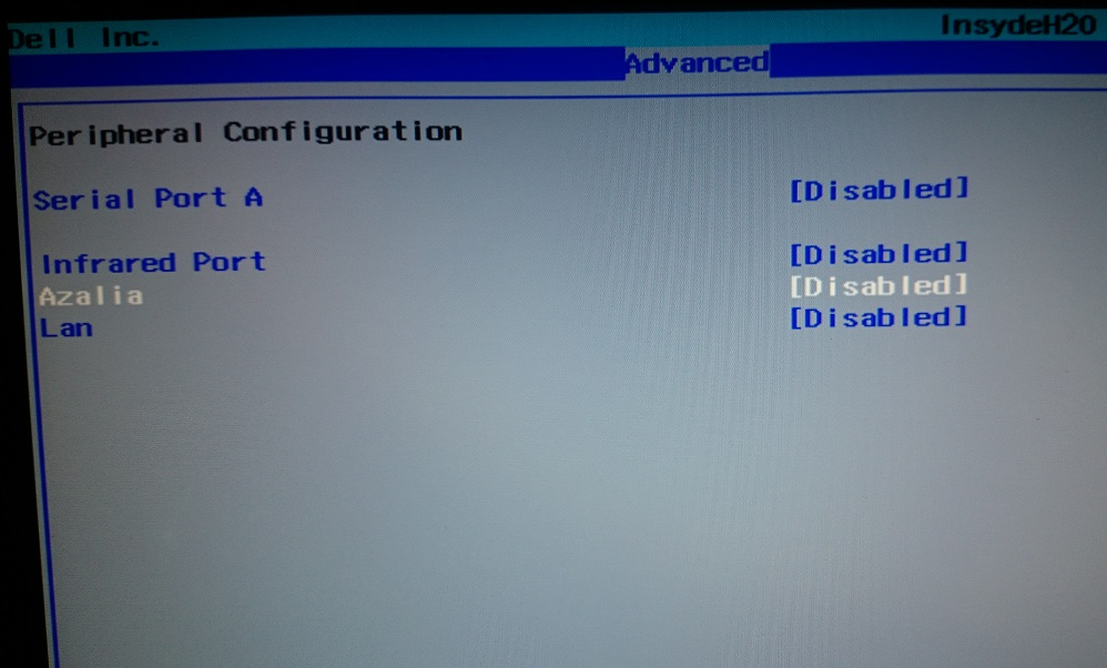

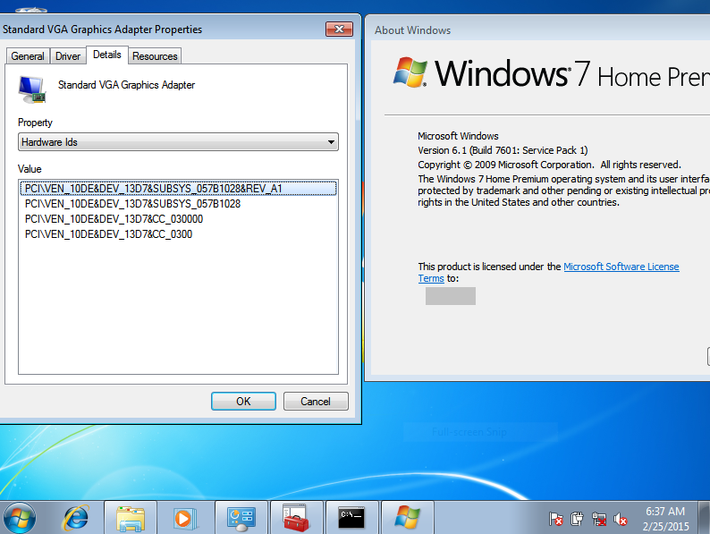

TomJGX Posted March 9, 2015 Share Posted March 9, 2015 Win7/MBR are basically for flashing the cards and 3DMark11/stock (sound card disabled), the other BIOS settings + NV Inspector will remove throttling for Gaming but not extreme OCing.[ATTACH=CONFIG]14216[/ATTACH]Edit: Core throttling, at least flashing is not a problem anymore for 120Hz AWs...M18xR2? @J95 how can you boot with Windows 7 and 980M? Does it work properly??? You haven't answered my question from earlier..Thanks,Tom- - - Updated - - -Win7/MBR are basically for flashing the cards and 3DMark11/stock (sound card disabled), the other BIOS settings + NV Inspector will remove throttling for Gaming but not extreme OCing.[ATTACH=CONFIG]14216[/ATTACH]Edit: Core throttling, at least flashing is not a problem anymore for 120Hz AWs...M18xR2? @J95 how can you boot with Windows 7 and 980M? Does it work properly??? You haven't answered my question from earlier..Thanks,Tom Quote Link to comment Share on other sites More sharing options...
J95 Posted March 11, 2015 Share Posted March 11, 2015 @J95 how can you boot with Windows 7 and 980M? Does it work properly??? You haven't answered my question from earlier..Thanks, Tom - - - Updated - - - @J95 how can you boot with Windows 7 and 980M? Does it work properly??? You haven't answered my question from earlier.. Thanks, Tom You need to disable the sound card 120Hz/PEG AWs nvflash'ing 900M series - Legacy BIOS Mode, HDMI or USB solution instead. Win7/GPT - UEFI/Legacy option ROM Win7/MBR - Legacy BIOS Mode. - - - Updated - - - February 13th, my card finally arrived... - Clock-block *workaround* ✓ - 120Hz/PEG nvflash'ing ✓ - Win7 both UEFI & Legacy ✓ - PEG throttling ✓ - OCing "" "" *soon*... Quote Link to comment Share on other sites More sharing options...
