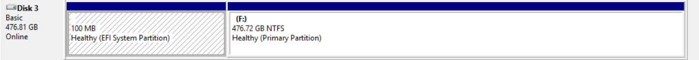

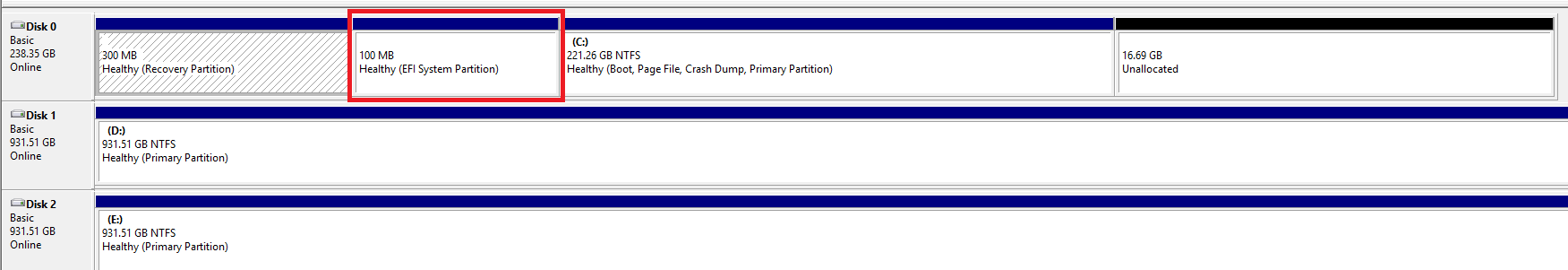

Guest Posted November 27, 2014 Share Posted November 27, 2014 @Mr. Fox I did this long time ago, can't remember if it was stock A13 latest BIOS (power lock issue). Anyway, Backup your current win7 installation and try what I mentioned before (crappy video quality). @ssj92 your 'trick' (BIOS mode) won't create the necessary partitions UEFI installation, HM77 AW / A11 Unlocked BIOS.[ATTACH=CONFIG]13262[/ATTACH] .Brother @J95, I don't remember reading what you said. Was it in this thread? Quote Link to comment Share on other sites More sharing options...
lechonman Posted November 27, 2014 Share Posted November 27, 2014 3d will work anytime??? and optimus disable???? Quote Link to comment Share on other sites More sharing options...
J95 Posted November 27, 2014 Share Posted November 27, 2014 Brother @<u><a href="http://forum.techinferno.com/member.php?u=3012" target="_blank">J95</a></u>, I don't remember reading what you said. Was it in this thread? Well done. All necessary steps to convert current installation, even using installation media, last step... Quote Link to comment Share on other sites More sharing options...
godfafa Posted November 27, 2014 Author Share Posted November 27, 2014 Well done. All necessary steps, even installation... Thanks for the video. But isn't that method just moving the pre-installed windows to GPT partition? I am saying this because, if we clean-install windows in UEFI without legacy rom load, the windows will be installed in GPT partition. That's not the problem. The problem is when you run windows 7 in UEFI (without legacy rom load) which is already installed in GPT, will not load graphic driver. And the results are it looks it is stuck somewhere at screen but actually it is booted. We can even alt - F4 to turn off the laptop though the screen shows "starting windows". Quote Link to comment Share on other sites More sharing options...

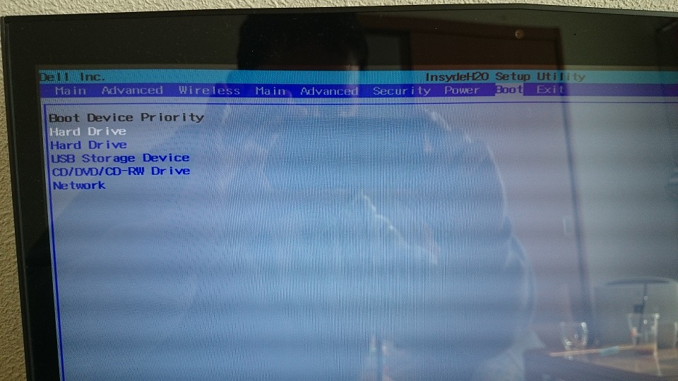

TBoneSan Posted November 27, 2014 Share Posted November 27, 2014 This I didn't know. A03 (unlocked) has no option to switch between Legacy and UEFI and all the other boot options? Something I'm missing? Perhaps this is a chance for me to update and try one of the other BIOS others haven't.. thoughts ? Quote Link to comment Share on other sites More sharing options...
godfafa Posted November 27, 2014 Author Share Posted November 27, 2014 This I didn't know. A03 (unlocked) has no option to switch between Legacy and UEFI and all the other boot options? Something I'm missing?Perhaps this is a chance for me to update and try one of the other BIOS others haven't.. thoughts ?[ATTACH=CONFIG]13264[/ATTACH]Yes you definitely need to update your bios. At the time of A03, I guess there was no UEFI? or UEFI wasn't that popoular. Quote Link to comment Share on other sites More sharing options...
