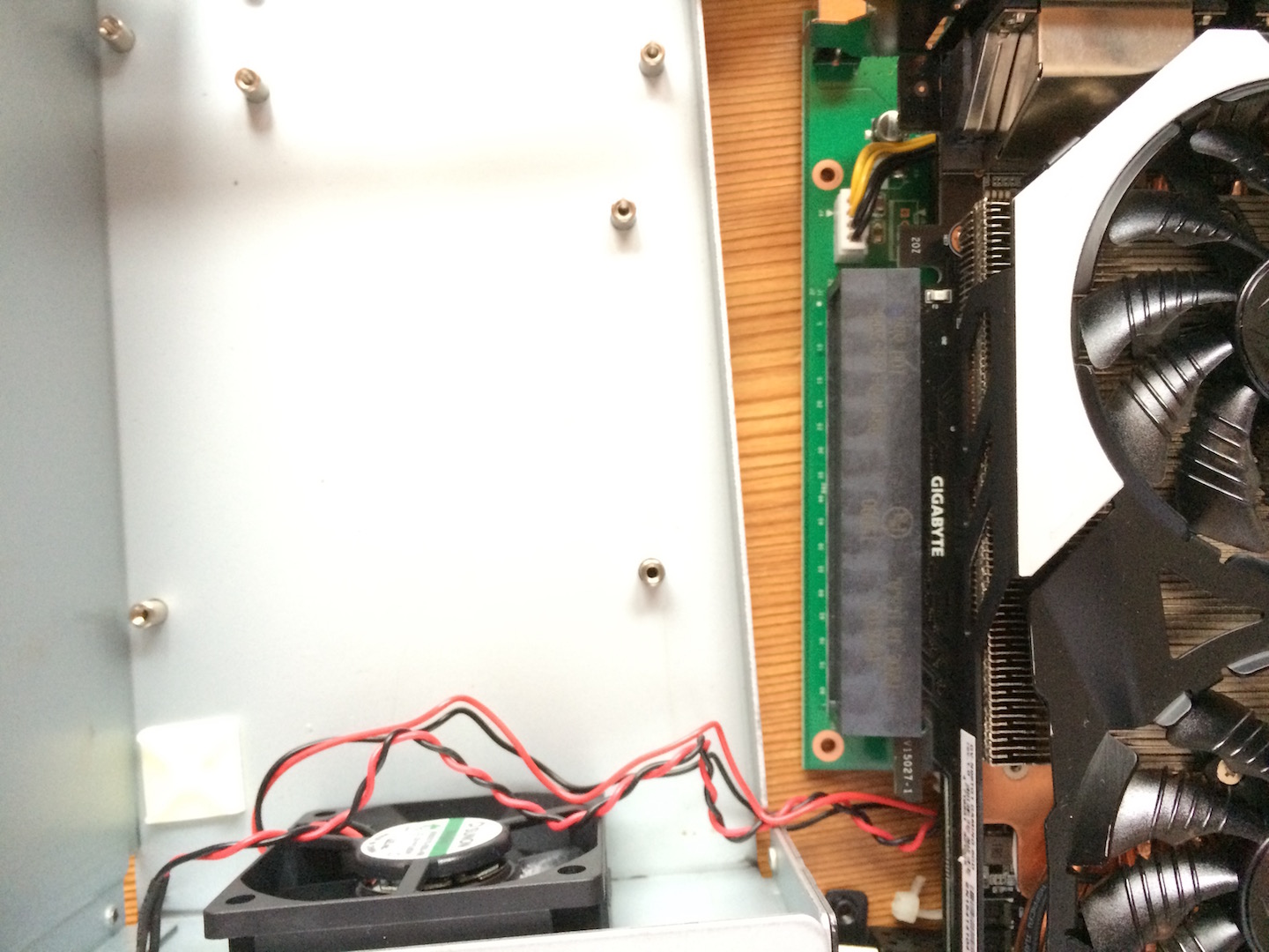

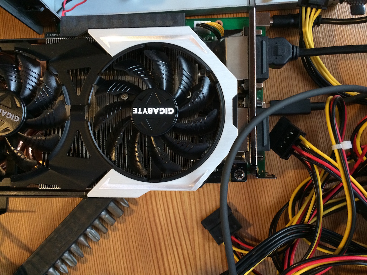

DannyFK Posted January 13, 2016 Share Posted January 13, 2016 Hi to everybody. Fist of all, I'd like to thank all the people who share this knowledge. After some time thinking about make my own eGPU, today I received the last part. The specs of my Mac are the followings: 2012 MacBook Pro I7, 16 GB RAM and Intel Graphics 4000 and Geforce 650M (discrete). I'm concern that my Mac have TB1 and the performance of the eGPU it's low than TB2. I bought the Dell DA-2, the PIN cables, the Akitio Thunder2 and the Zotac GTX 970 graphic card. First I tried to power the Akitio and the card with Dell DA-2, but it seems that the system was unable to start (maybe I'm doing something wrong). Later, and with an old PSU ATX 450W, I finally powered the whole system. With the Goalque software my Mac got the eGPU and started running in an external display via HDMI, but after aprox. 15 min of use, the Mac crashed and restarted. Since then, when I try to use the eGPU, the Mac restarts again and again when I load X-Plane simulator. The errors report indicates a kernel panic error. I think that it could be the NVIDIA drivers, but Im not sure. I have installed both the CUDA drivers for Mac and the WEB drivers for Mac too. Please could somebody help me with this problem? Could come the error from using the old PSU ATX 450W? P.D.: I'll try to power the eGPU again with the Dell DA-2. Thank you so much. Danny. Quote Link to comment Share on other sites More sharing options...
