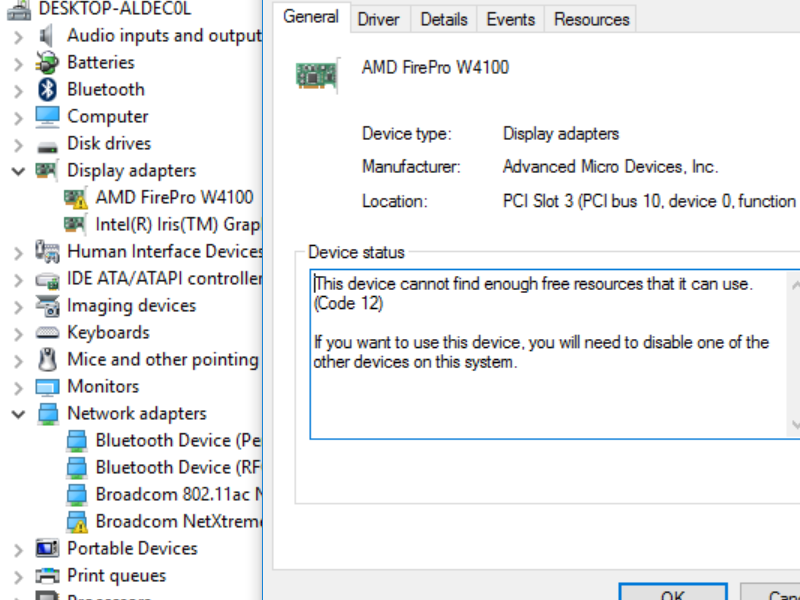

rozhkov Posted September 13, 2015 Share Posted September 13, 2015 Hello! Probably smb have the same issue.. FirePro Amd w4100 video card and Apple thunderbolt ethernet do not install correctly with Akitio T2 screenshot ==> Can not install drivers from AMD, bcs: "No supported video card found" ??!?!? 2015 13" MBP TB2 Win10 Akitio-T2 Quote Link to comment Share on other sites More sharing options...

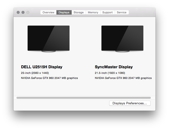

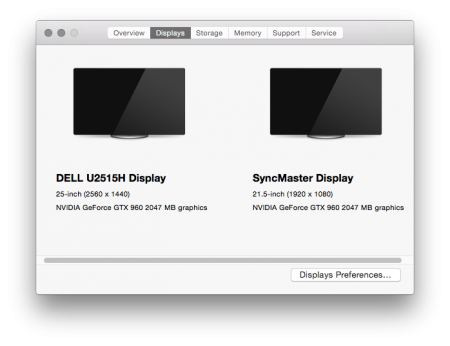

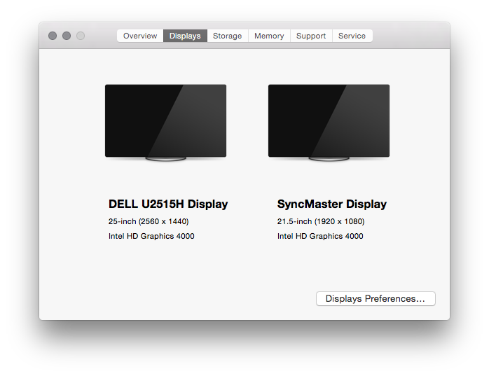

Shez Posted September 15, 2015 Share Posted September 15, 2015 Hi, I have a problem with Mission Control performance on my mac mini 2012 with Intel HD 4000, when I connecting two or more 1440p monitor. Even if I connect all of them to eGPU (GTX 960), after system start +10 minutes, system anyway switch all of them to Intel HD 4000, it shows below the About This Mac -> Displays. The graphic processing work thru HD4000. Is it possible to make that system use force eGPU on OS X? Anyone have same problem? Quote Link to comment Share on other sites More sharing options...

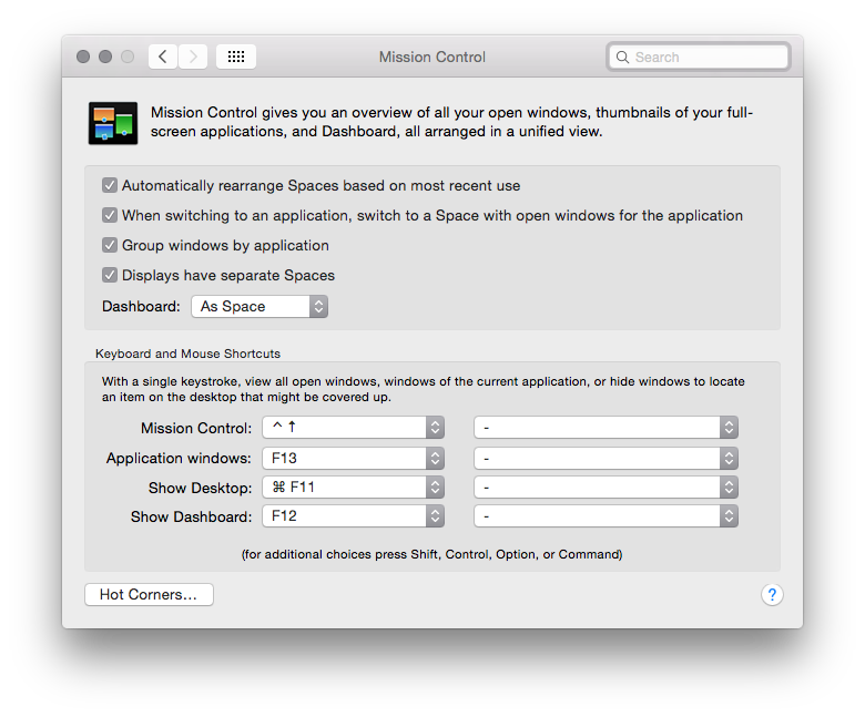

euqlaog Posted September 15, 2015 Share Posted September 15, 2015 Hi goalque, is it possible to fix that in near future with our script?http://forum.techinferno.com/diy-e-gpu-projects/7910-diy-egpu-macbook-experiences-136.html#post144273Shell script is very handy for almost anything. For display controlling, I have to use OS X frameworks. What’s your Mission Control settings? What happens exactly when “system anyway switch all of them to Intel HD 4000”? Is the Mac going to sleep after 10 minutes? Are you running a specific application that is affected or is it just the Mission Control?The application can take advantage of any GPU, even those that are offline. It’s often programmer’s responsibility to handle multiple GPUs and monitors, but OS X is quite smart switching between them. OpenGL dynamically changes the renderer depending on the screen and the segment of the window.If you have set the external monitor as the primary, the eGPU spans both the internal and external screen, and when you drag a window to internal screen, the application is still accelerated by the eGPU. The screen you select as main works for application launching. However, Mac mini has no “internal screen” except the HDMI interface, but I guess the functionality is the same.Type “system_profiler SPDisplaysDataType” to see the list of displays and their current corresponding GPUs. The same list is under system report/graphics/displays, and by pressing Command+R you can refresh the view. Quote Link to comment Share on other sites More sharing options...

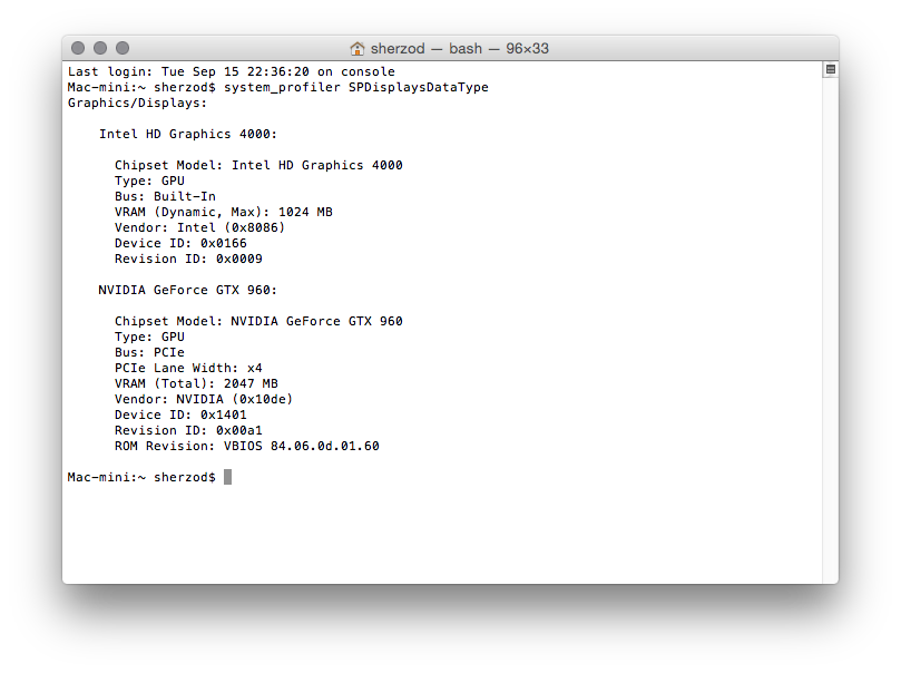

Shez Posted September 15, 2015 Share Posted September 15, 2015 Graphic processing from eGPU switch back to HD4000. It's not going to sleep, just switching in background gpu to default as processing unit, even if the monitors connected to eGPU. OS X is not switching to eGPU when it's offline, because I feel when the Mission Control works with 120 fps and 15-25 fps. Just starting my mac mini and it's showing that: after 5 minutes without running any apps: Mission Control: system_profiler SPDisplaysDataType: --- OS X 10.10.5 Quote Link to comment Share on other sites More sharing options...
euqlaog Posted September 15, 2015 Share Posted September 15, 2015 Screenshot at 1.46.59 AM says that you have no displays connected, which is very weird. I'll check how my Mac mini behaves with two monitors. Quote Link to comment Share on other sites More sharing options...

euqlaog Posted September 16, 2015 Share Posted September 16, 2015 @Shez: If the system profiler produces information without any displays, something is not right. Let me know if the problem is reproducible. First of all, I recommend reinstalling OS X. Glad to hear it’s ok now. Quote Link to comment Share on other sites More sharing options...
