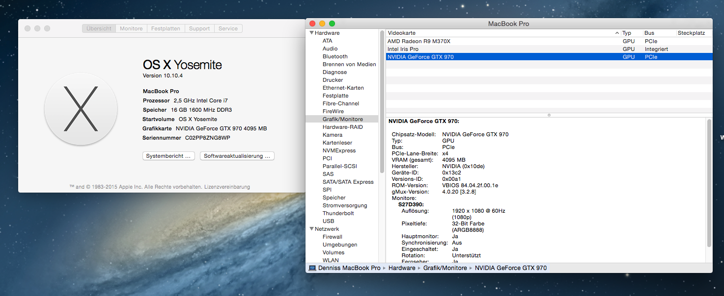

eGPUfan Posted August 7, 2015 Share Posted August 7, 2015 So guys Gatsby told me that the eGPU works for the rMBP mid 2015 with M370X for Windows 10 without any Software guides, too. U just have to plug in the Akitio before u start into Windows then disabling the M370X and then u can install the drivers for the for example GTX 970 (GJ Windows 10). After a restart the eGPU works fine and with less crashes than on Windows 8.1!!! So the second case was the eGPU working on OS X (just for 10.10.3 or above) for the mentioned Macbook. Here u just install the newest NVIDIA Web Drivers or u use the tool from the Bison-Box which u can download here. http://bizon-pc.com/a/bizonbox_mac.zip then start the start.command file. So I guess there are not any issues with the mid 2015 rMBP anymore enjoy. Quote Link to comment Share on other sites More sharing options...
