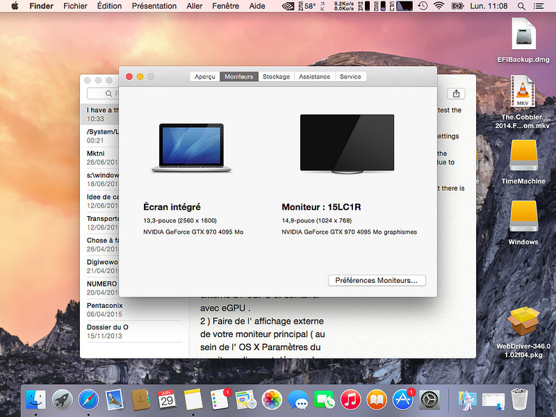

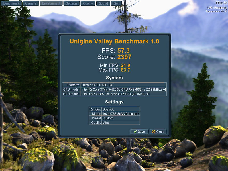

I have a theory. Could you borrow an external monitor? If yes, I'd like you to test the following setup:
1) Connect an external monitor to the eGPU and boot with eGPU.
2) Make the external display your primary monitor (within the OS X Monitor settings drag and drop the menu bar to the external display)
3) For me, OS X now says that all displays are driven through my eGPU and the benchmarks confirm this it seems (with a small drop on the internal display due to Optimus, as would be expected).
If this works out, one could conclude that the trick is to make OS X think that there is an external display connected. (I think this has been suggested before.)
You theory is wrong ... ^^
Made in the graphics card that is displayed corresponds to the card of the primary monitor
The internal display remains on the graphics card intel Iris, same for the thunderbolt display
It should be inspired by the Macbook pro with 750m, so the mac switch on the external graphics card
