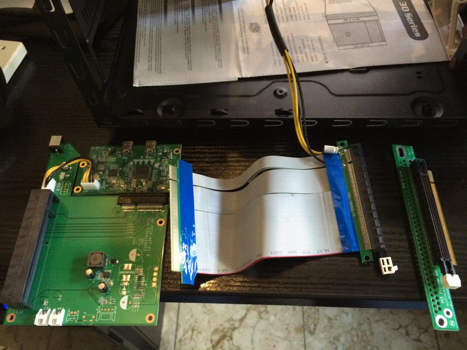

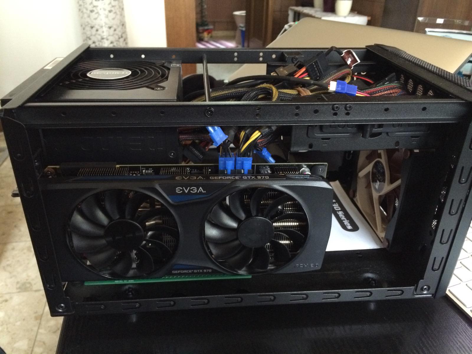

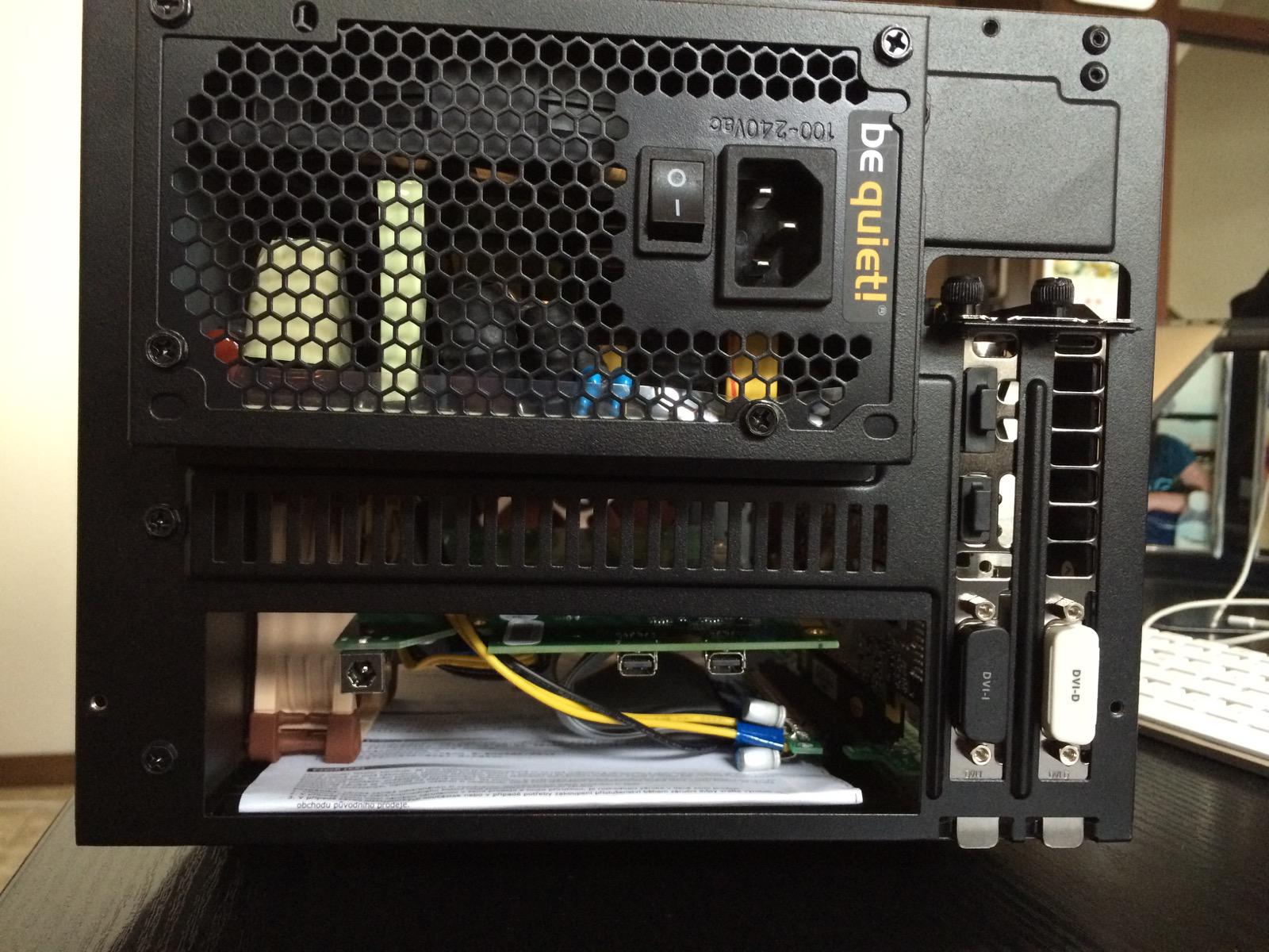

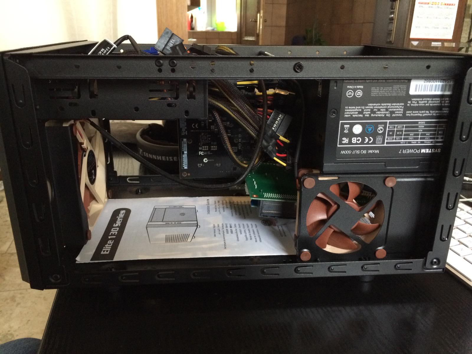

  1. Open AKiTiO's box by a normal screwdriver, take out the PCIe board, attach the riser and the GPU to its x16 slot

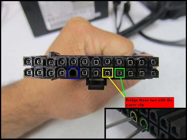

  2. Attach PSU's power cable (blue) to the GPU and do the "paperclip trick" as shown in picture 1.
  3. Attach DVI/HDMI cable to the GPU (if using a back bracket, I wasn't able to fit DVI-cable because the plastic part was too wide) and use any external monitor you like (4K would be nice to test with this setup)
  4. Place something under the GPU so that it will be steady (a removed front panel is perfect for this)
  5. Attach AKiTiO's 60W power plug to the DC jack of the PCIe board
  6. Connect TB cable
  7. Power up AKiTiO's box (green light should appear) and the PSU at the same time (I use a power strip with a switch on the floor)
  8. Turn on MacBook Pro (blue light should appear). If it is booting to OSX partition, change startup disk to Boot Camp partition from the OSX preferences.

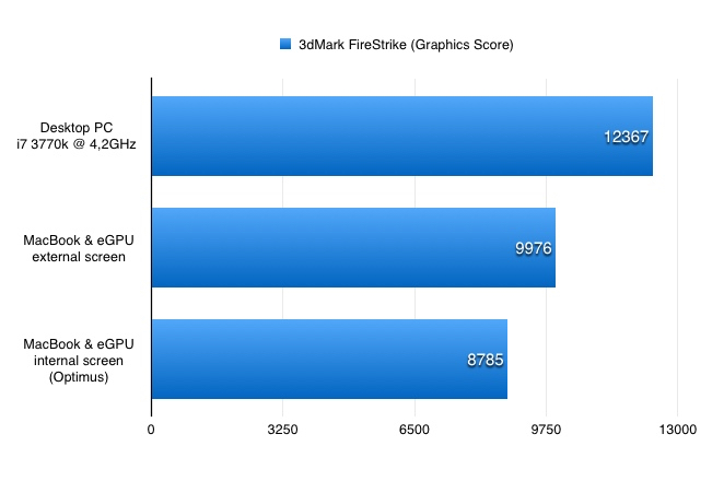

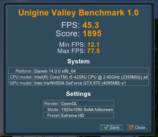

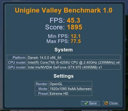

BENCHMARKS
Optimus results (internal vs. external display):
3dMark_FireStrike (Graphics Score): 8785 vs. 9976 (88% performance of external display)
3dMark_11(Graphics Score): 12981 vs. 13773 (95% performance of external display)
Valley_ExtremeHD(Score): 1922 vs. 2104 (91% performance of external display)
Results (eGPU external display vs. Hackintosh):
3dMark_FireStrike (Graphics Score): 9976 vs. 12367 (81% performance of Hackintosh)
Valley_ExtremeHD(Score): 2104 vs. 2274 (92,5% performance of Hackintosh)
Results (eGPU internal display vs. Hackintosh):
3dMark_FireStrike (Graphics Score): 8785 vs. 12367 (71% performance of Hackintosh)
Valley_ExtremeHD(Score): 1922 vs. 2274 (84,5% performance of Hackintosh)

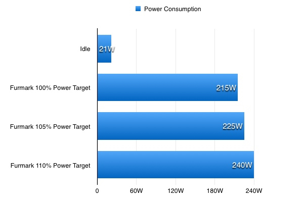

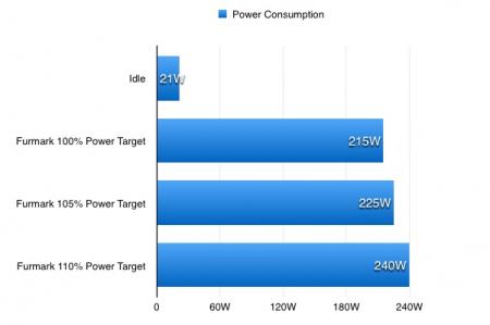

POWER CONSUMPTION
Combination of GPU, ATX PSU, AKiTiO [without PSU], molex powered riser:
Idle ~ 21W
Valley ~ 150-160W (max. 180W)
3dMark11 ~ 200W (max 215W)
3dMark13_Sky ~ 195-200W (crashes after entering the cave)
3dMark13_Fire ~ 170-200W (max. 210W)
Furmark ~ 215W (max. 220W [100% power target])
Furmark ~ 225W (max. 230W [105% power target])
Furmark ~ 240W (max. 240W [110% power target])
Combination of GPU, ATX PSU, without riser [AKiTiO PSU in use!], measured on the ATX PSU:
Idle ~ 12,5W
Furmark ~ 150W (max. 155W [100% power target])
Furmark ~ 158W (max. 160W [105% power target])
Furmark ~ 165W (max. 167W [110% power target])
Without riser [AKiTiO PSU in use!], measured on the AKiTiO PSU:
Idle ~ 10W
Furmark ~ 70W [100% power target]
Furmark ~ 74-75W [105% power target]
Furmark ~ 78-80W [110% power target]
imho a powered riser is almost compulsory. The AKiTiO PSU specifications are output 12V, 5A = 60W. Furmark, which is of course no real world scenario, is exceeding the PSUs specifications. Might work for temporary peaks in games (real world scenario).

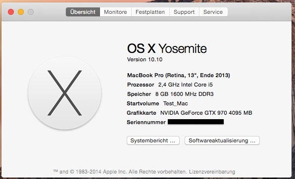

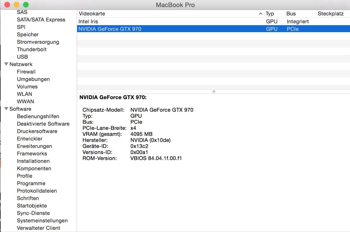

Was able to install the GTX 970 in OSX 10.10 Yosemite, following @Mark guide: http://forum.techinferno.com/implementation-guides/8059-%5Bguide%5D-2013-15-macbook-pro-gt750m-gtx780ti%4016gbps-tb2-sonnet-ee-iii-d-osx10-10-a.html
BUT after changing to the OSX Default Graphics Driver, the eGPU setup is spoiled again… Can't fix it with reinstalling the WebDriver, kext editing, fixing and shutdown+boot.
eGPU isn't recognized anymore :(

Aiiiiiii… this is madness. After some mixed reboots into Windows / OSX the eGPU isn't working in OSX. Trying the Nvidia driver magic with the kext files…, but doesn't help.
I don't get it.
I was using Kext Wizard!
Is there a reason why I should copy the kext files to the desktop and edit it there? After editing copy them back and after that run Kext Wizard?

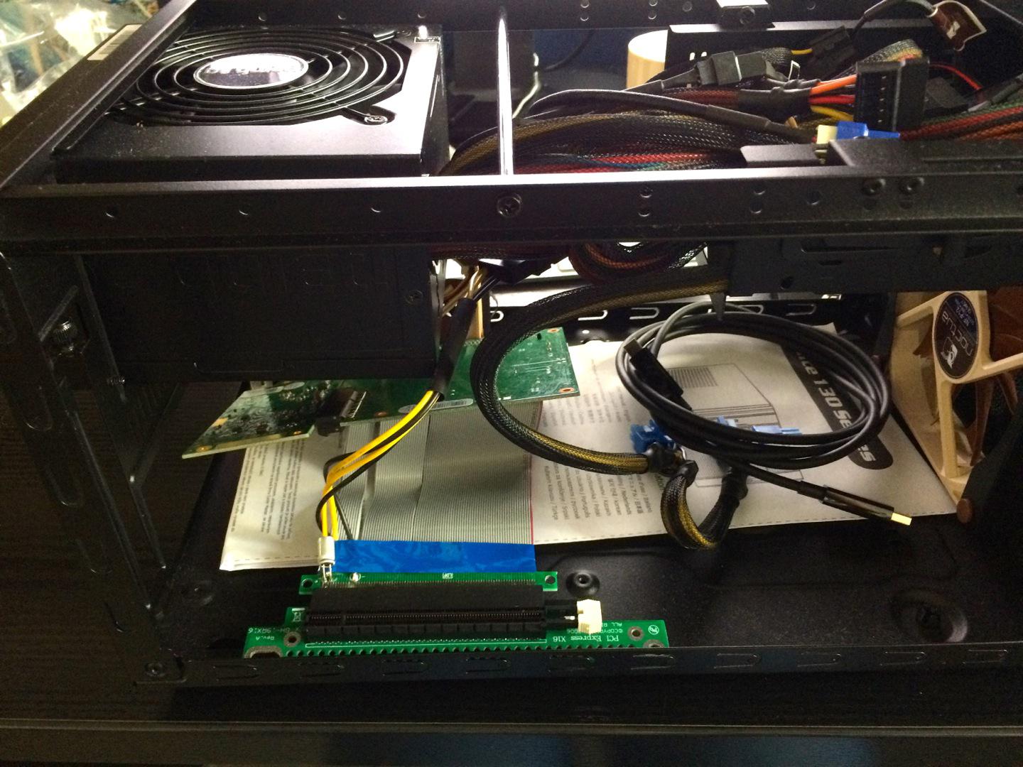

My GPU is currently in a RMA process, but maybe the picture without the GPU is even better.
I am using two riser:
- a 90° PCB riser
- a flexible riser molex powered
- a 90° PCB riser

No! In this forum we came to the conclusion that the AKiTiOs limit is 25W. So by using 80W, it is running beyond the specifications -> not good!
I thought, that a 6+8-Pin power connector on the GPU might provide enough power so that the GPU doesn't need more than the 25W, but I was wrong.
Bottomline is that I would advice everybody who wants to work with a AKiTiO to get a molex powered PCIe riser card to overcome the 25W. Additional benefit is, that the AKiTiO doesn't need it's own PSU and can be directly powered by the riser.

Can you explain how the molex or "paper clip trick" is used to power up the ATX? That picture no.1 one that is on the other guide isn't clear at all regarding that connection.

Paperclip trick:
Source: Power Supplies
This needs to be done to start a PSU without a regular PC mainboard.
I am using the Elite 130 because I don't see much sense in using the AKiTiO itself. It is way much too small to host my big GPU and my PSU! So with the Elite 130 I can build everything into a cheap case without cables or PCBs visible/exposed on my desk. It's also a safety issue.
No, the power button of the case is not working. The power button is just giving a temporally connection to the PSU and is mainly used by the circut boards/mainboards. I will use the PSU on/off switch at the back or a multiple socket powerplug with a switch.

Tested OSX on my 13" (late 2013) MBPr and got it working but mainly on the external screen. Internal (with eGPU performance) only if I drag the animated windows into the internal screen.
Rebooted…boom…eGPU is gone. That's it! No more OSX and eGPU with a GTX 970 for me. Maybe it will work with a GTX 780 better?!
- a 90° PCB riser
I will also need to buy a 90° riser because the powered riser doesn't fit in my SilverStone FT03 mini case. And a SWEX to make the case fan work.
