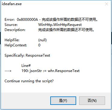

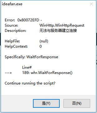

      1.  First forgive my English is not very good (PS:Baidu translate),My computer is Y500,Found the ideafan, has been using this software,Last month upgraded the WIN10 version 1607Found Ideafan can not get open hardware monitor of the temperature, that is AUTO failure, Upgrade from open hardware monitor to 0.7.1  beta  after automatic mode return to normal。
      2. Yesterday, the upgrade win10 14901 ideafan after the above situation, however, there is no new version of the open hardware monitor available, there is a good way to solve it, although the manual can also be used to open ideafan
     3.The mouse pointer on the ideafan icon does not display the temperature of the screenshot below,The normal condition is the display temperature,Seek solution

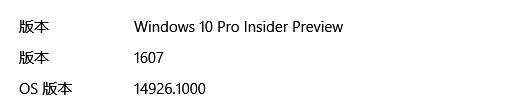

1. I have 1511 still, because when going with further Windows update = INTERNET is gone. So I had to revert. Could you confirm what is your current Windows 10 version (Start->Run... and type winver.exe)? I understand, that automatic mode is not working and temperatures are not showing. I believe I can fix it - give me some time to review.

23 hours ago, 雨灵 said:
As shown in figure, can not obtain the temperature, automatic mode failure!

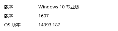

雨灵, I will try updating the Windows 10 to 1607 to review. Could you please try to close both IdeaFan and OpenHardwareMonitor and run them manually? Are temperatures shown then?
When the temperature is high, the natural operation of the manual mode, using the shortcut keys.
I see. Give me some time to get ready and update to 1607, I will check what is going on on that version.

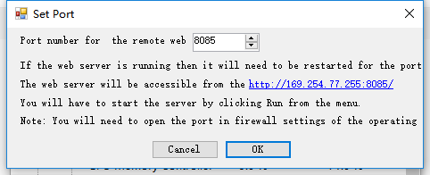

I personally had to go to OpenHardwareMonitor and enable Options->Remote Web Server->Run for that to work. Please write if you manage to succeed for others may want the information too.
Edited by lil kim
On 2016/9/26 at 3:01 PM, lil kim said:
I have been warned for even posting the link I found. It is written there that that user was banned from these forums, so I believe you will have to write him personally if you want to solve this issue :o
web service 》Run:ohmy:

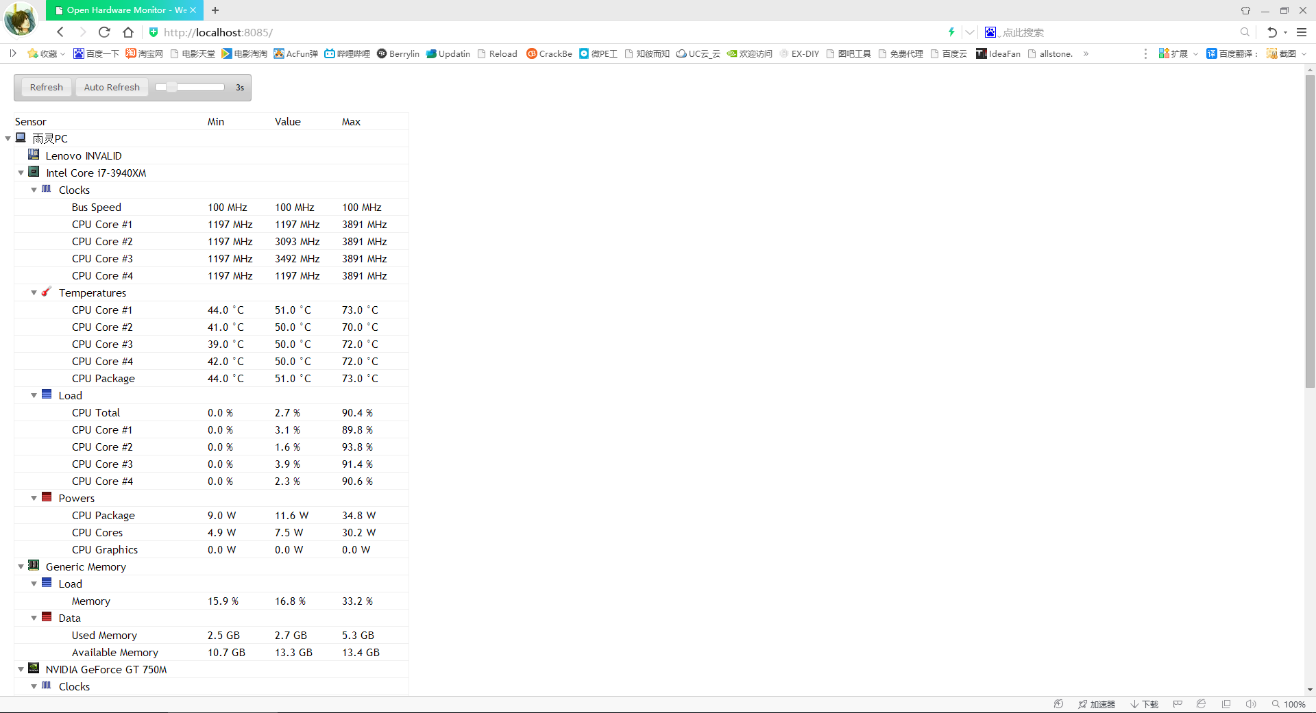

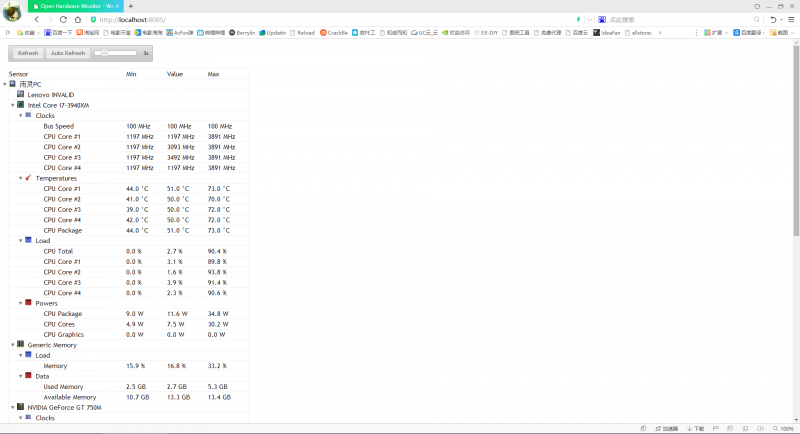

Hey man, can you access OpenHardwareMonitor server from the browser by going to http://localhost:8085/ ? Maybe someone is blocking that port like windows firewall or something.
49 minutes ago, 雨灵 said:
So did you open the port in windows firewall settings as the note says ? Although I did not need to do that, I think I have my firewall disabled on my home PC. Maybe either IdeaFan or OpenHardwareMonitor is blocked or not open in firewall ? I would first try disabling firewall and restarting IdeaFan and see how that goes. If it does not work - its not firewall problem then.

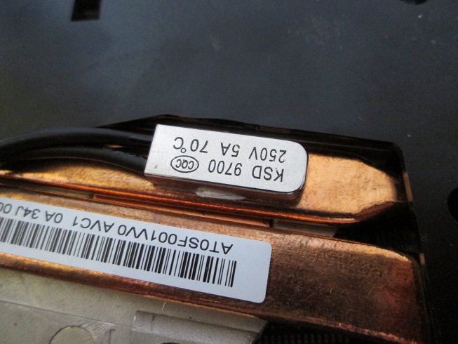

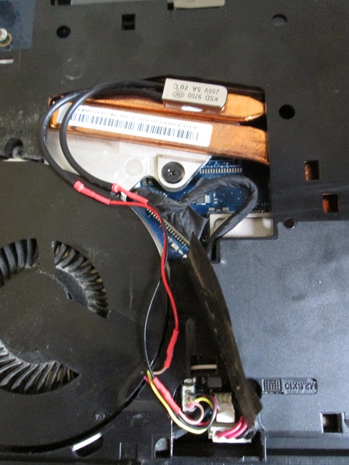

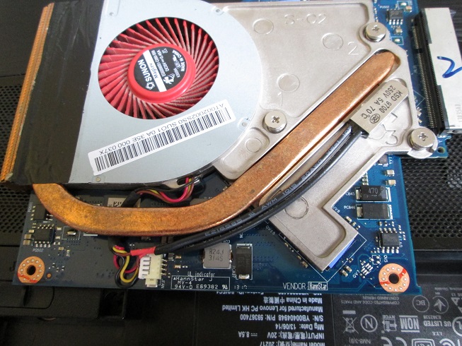

Here is my solution to the fan control problem.
I was browsing on ebay looking for some sort of micro switch that I could hook up to the fan brown wire, so I could turn it on or off when needed, and I came across this temperature sensor/switch. They work like a thermostat, when reaching a certain temperature it will either turn on or off depending on the model.
You can choose from a range of temperatures, from like 45C to 130C. I'm using a normally closed, 70C model. Around 70C it will open the circuit and run the fan at full speed until the temperature drops down to around 65C. They are dirty cheap! I paid 99 cents each, including shipping.
Wire the sensor in series with the brown wire, place it as close as possible to the chip or heatpipe using thermal adhesive tape and you're done.
This is what it looks like
(I keep the wires tucked under the black sticker)
I glued the sensor with double sided thermal adhesive directly on the heatpipe.
There's not enough room on the ultrabay GPU to glue the sensor on the heatpipe, so I glued it right next to it. Worked just as well.
More pictures: http://imgur.com/a/DBlxV
This is the listing I ordered from: http://www.ebay.com/itm/331577233585
Search for "KSD9700". Make sure you choose the "Normally Closed" model.
Both GPUs are running at 1189MHZ and the memory is running at stock speeds.
GPU2 was repasted a couple months ago with Mastergel Maker from Cooler Master. CPU and main GPU still have the stock thermal paste.
"Idle" temperatures, watching a video, browsing the web (measured on a hot day).
CPU ~55C
GPU1 ~50C
GPU2 ~40C
Full load (GTAV, BF Remastered, MadMax). GPU2 will overheat and throttle using a GPU burner software like Furmark and OC Scanner. This never happens in any gaming session, regardless of how long I play.
CPU ~80C
GPU1 ~77C
GPU2 ~83C

@fmj777 bro, i did the sensor mod that you have posted, but my fan stopped working after. can you help me as to what have gone wrong? I've soldered the wires in series as your instructions and photos, I'm not sure if that's what caused it to stop working. did you solder yours or just wrapped them together? can you give advice as to what to do? thanks!
Edited by angel_grin
