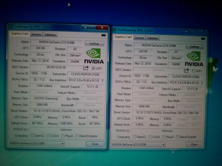

Hi guys
I had a problem after flashing graphics MSI 870m to Clevo bios
After the firmware gives the same result as in the picture on the right, the difference may be only in versions of the BIOS
Firmware from under Dos, any errors in the firmware has not issued even once, all firmware ends well
I tried to flash firmware with some tech forum and believe the result will not change
How to revive the video card?
Right - after flashing
Left - to firmware

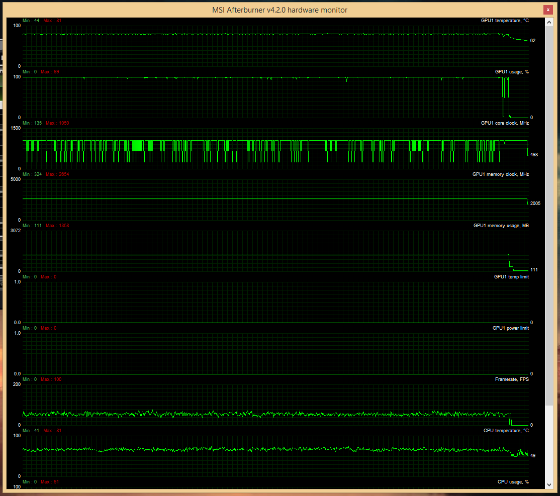

Tonight I could go to bed later, so I fired up NVInspector and surprise surprise, only the clock is limited to the typical +135Mhz, but voltage can be bumped up +250mV and memory 2500Mhz, tried to bump the core to 1050Mhz and the memory to 2600Mhz, ran Heaven benchmark, stable temps around 75ºC, will need to repaste the gpu and use good quality thermal pads because right now its with MX4 and random thermal pads that are not that good.
But I will send you the VBIOS, with some luck I can push her past the 135Mhz limit without artifacts.
EDIT:
Went to play a bit of Crysis and the GPU clock is always bouncing up and down, this happens with both stock clocks and OC'ed, is this normal?
