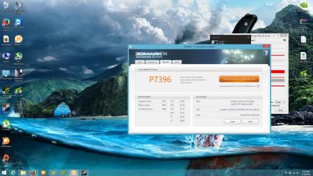

kingkaan Posted May 18, 2014 Author Share Posted May 18, 2014 this is really weird..it was showing perfcap green because i put the voltage too high..right now i did the whole 3dmark11 test and i got 7396 score at +60 core +550 mem...card becomes unstable if i go +135 and give enough voltage...i lose a lot of fps for some reason...my temps are perfect..never passes 65c both cpu and gpu.. Quote Link to comment Share on other sites More sharing options...

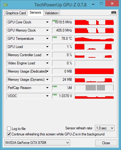

Bios Modder Klem Posted May 18, 2014 Bios Modder Share Posted May 18, 2014 oh wow..my bad Klem.. i just ran 3dmark11 with your rom didnt touch anything just as it is..and got 7597 almost 7600 on 3dmark11...cheers mate! what do you usually get with this rom? I do not have GTX870M. I just make this mod based on your vbios. Please run GPU-Z(monitoring window with set max value) and then run 3D Mark. After 3D Mark was finished, make screenshot of GPU-Z(monitiring window) and post here. Quote Link to comment Share on other sites More sharing options...
kingkaan Posted May 19, 2014 Author Share Posted May 19, 2014 here you go Quote Link to comment Share on other sites More sharing options...
Bios Modder Klem Posted May 19, 2014 Bios Modder Share Posted May 19, 2014 [ATTACH=CONFIG]11656[/ATTACH] here you go Ok. Nice. Can you try a bit increase core clock? For example to 1046 or 1085. Quote Link to comment Share on other sites More sharing options...

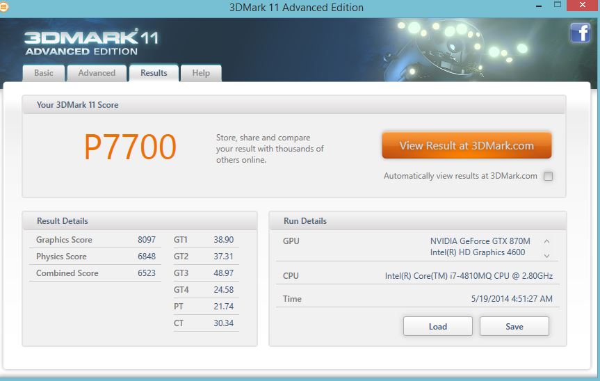

kingkaan Posted May 19, 2014 Author Share Posted May 19, 2014 Ok. Nice. Can you try a bit increase core clock? For example to 1046 or 1085.i am at 1110.5 right now almost got 7800 in 3dmark11..can we go higher? like can you mod it higher maybe we can reach 8k? possible? when i do it from inspector in game perfcap shows pwr green Quote Link to comment Share on other sites More sharing options...
Bios Modder Klem Posted May 19, 2014 Bios Modder Share Posted May 19, 2014 i am at 1110.5 right now almost got 7800 in 3dmark11..can we go higher? like can you mod it higher maybe we can reach 8k? possible? when i do it from inspector in game perfcap shows pwr greenTry this variant. Quote Link to comment Share on other sites More sharing options...
kingkaan Posted May 19, 2014 Author Share Posted May 19, 2014 Try this variant. got 7700 getting close Quote Link to comment Share on other sites More sharing options...
Bios Modder Klem Posted May 19, 2014 Bios Modder Share Posted May 19, 2014 See only graphic score, because this score for graphic card. P8000+! Phisics score is for CPU, and total score for combination both CPU+GPU. You can try a bit increasy core clock and run 3D Mark again. Quote Link to comment Share on other sites More sharing options...

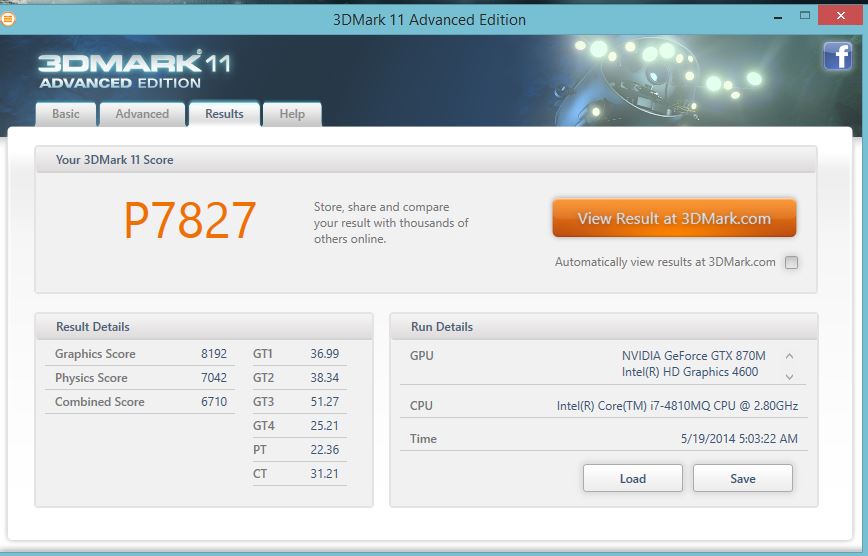

kingkaan Posted May 19, 2014 Author Share Posted May 19, 2014 Try this variant. and this is at 1110.5.. can we go higher than this? Quote Link to comment Share on other sites More sharing options...
Bios Modder Klem Posted May 19, 2014 Bios Modder Share Posted May 19, 2014 P8192 graphic score! It is very nice result for 870M! You can try a bit increase core clock more then 1110,5. Quote Link to comment Share on other sites More sharing options...
kingkaan Posted May 19, 2014 Author Share Posted May 19, 2014 P8192 graphic score! It is very nice result for 870M! You can try a bit increase core clock more then 1110,5. indeed i just tried raising it a bit more..for some reason performance dipped..like lost about 7-8 fps in 3dmark..not sure why though. temps are all good tho Quote Link to comment Share on other sites More sharing options...
Bios Modder Klem Posted May 19, 2014 Bios Modder Share Posted May 19, 2014 indeed i just tried raising it a bit more..for some reason performance dipped..like lost about 7-8 fps in 3dmark..not sure why though. temps are all good tho Ok. I understand. This is max for your case. For overclock more you need power supply(power adapter) with more power. But now you have already very nice overclock and result. Quote Link to comment Share on other sites More sharing options...
