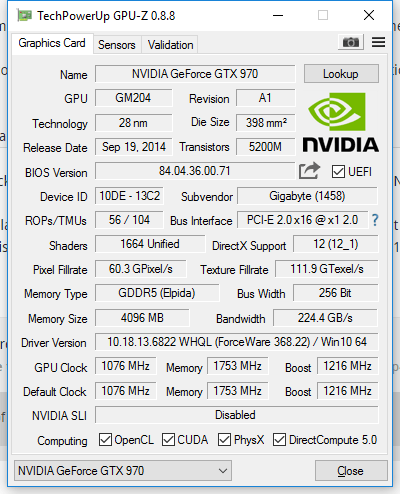

Thanks! The GB package actually had a 6pin to 6pin + 6+2pin so I was good to go. Now I have as pare 6 to 8 pin adapter turning up tomorrow haha
As for internal display.. it works (I installed GTX 970M listed drivers off the bat) but I'm wondering what sort (if any) performance increase I'll see if I use an external monitor? If I start using a monitor do I need to change drivers? This is GPU-Z (running the render test) does it look ok? 2.0 x16 @ 1 2.0 ?
About 15-20%, depending on the workload.
You can look at the many benchmarks that other users have put up. Some of them compare scores/framerates both with and without external monitor.
x1 2.0 is the highest you can get on EXP GDC.
GTX 970 gives very strange results however: http://www.owen-lu.com/egpu/
Edited by Arbystrider
