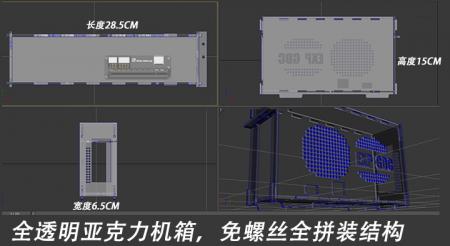

I was now looking at this enclosure: http://www.yoybuy.com/en/show/35071708906/?s=t
It looks good and it's cheap. One problem I was thinking about is that with it you won't be able to detach the hdmi and power cable from the exp gdc. Well, you can detach them, but you'll have a hard time re-plugging them. In order to be able to detach the power cable (at least), I thought you could use a DA-2 extender cable, but there is none on the eBay...

Of course I own that enclosure =) (I use it for a PE4L enclosure atm, you can see my new 3Dprint enclosure in my sign)
And yes you are right, you'd need to use a 'carpet knife' and break an opening for it....or solder your own extension power cable!
I'd go for the knife idea if were you since that's probably very easy if you have patience with it.
Nice work with your enclosure! Very handy having it behind the monitor.
About the carpet knife, is it really possible to cut plexiglass (it's plexiglass, isn't it?) with it?

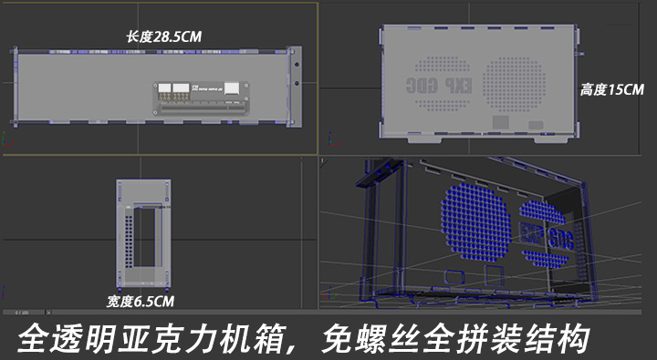

1) Before buy a box for EXP check out the size of your card, there is restrictions.

About number 1), I think he means that there is a limited space (28.5cm if I remember correctly) to accomodate the VGA into the enclosure.

Yep, sorry for my English, it is pretty rusty. You can only fit a video card that meets this requirements:
[ATTACH=CONFIG]11560[/ATTACH]

I'd also like to add that the height became a slight problem when using PE4L + Asus DC2 GTX660, I manage to just barely squeeze it in there tilted, due to the external heat pipes of the card. I can imagine the EXP GDC's bottom layer needs to be removed in order to fit a DC2-type card.
