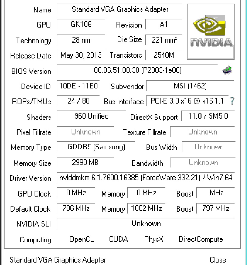

Saraph Posted March 26, 2014 Share Posted March 26, 2014 Hello! Hopefully someone can assist or point me in the right directions with an issue I'm having with this upgrade. I have a MSI GT70 0ND laptop that had a 675m GPU in it (now dead). After looking around for a replacement I found that the 675m was still very expensive, so I decided to go with the 770m hoping that it would at least be comparable in performance. My issue is that after swapping the GPU's my screen is set to 640x480 16-bit (seems lower actually, the colors look terrible). I am unable to install any driver software and my card shows up as a standard VGA adapter. The listing I bought this card off of did say it was an msi card but I am having my doubts. I attempted to disabled the VGA adapter and use on board to at least feel comfortable troubleshooting but I get the error 'This device has not enough free resources that can be used.' I've read several forum posts that mention flashing the bios, how is this done? Has anyone else ran into an issue like this before? Edit: I was able to finally get the GPU-Z application and take this screenshot. Hope this helps. Quote Link to comment Share on other sites More sharing options...
Bios Modder Klem Posted March 26, 2014 Bios Modder Share Posted March 26, 2014 Hello! Hopefully someone can assist or point me in the right directions with an issue I'm having with this upgrade. I have a MSI GT70 0ND laptop that had a 675m GPU in it (now dead). After looking around for a replacement I found that the 675m was still very expensive, so I decided to go with the 770m hoping that it would at least be comparable in performance.My issue is that after swapping the GPU's my screen is set to 640x480 16-bit (seems lower actually, the colors look terrible). I am unable to install any driver software and my card shows up as a standard VGA adapter. The listing I bought this card off of did say it was an msi card but I am having my doubts.I attempted to disabled the VGA adapter and use on board to at least feel comfortable troubleshooting but I get the error 'This device has not enough free resources that can be used.' I've read several forum posts that mention flashing the bios, how is this done?Has anyone else ran into an issue like this before?Edit: I was able to finally get the GPU-Z application and take this screenshot. Hope this helps.[ATTACH=CONFIG]11242[/ATTACH]You need to flash vbios from MSI. Now your vbios from DELL.Download Nvflash and flash this vbios VGA Bios Collection: MSI GTX 770M 3072 MB | techPowerUp Quote Link to comment Share on other sites More sharing options...
Saraph Posted March 26, 2014 Author Share Posted March 26, 2014 You need to flash vbios from MSI. Now your vbios from DELL.Download Nvflash and flash this vbios VGA Bios Collection: MSI GTX 770M 3072 MB | techPowerUpWhere do you see this is from Dell? I will flash as soon as I can and retry drivers. Quote Link to comment Share on other sites More sharing options...
Bios Modder Klem Posted March 26, 2014 Bios Modder Share Posted March 26, 2014 Yes, it is no DELL, it is original Nvidia vbios, but as i wrote you need to flash vbios from MSI. Quote Link to comment Share on other sites More sharing options...
Saraph Posted March 26, 2014 Author Share Posted March 26, 2014 Yes, it is no DELL, it is original Nvidia vbios, but as i wrote you need to flash vbios from MSI.Thank you! Will do asap and let you know. Quote Link to comment Share on other sites More sharing options...

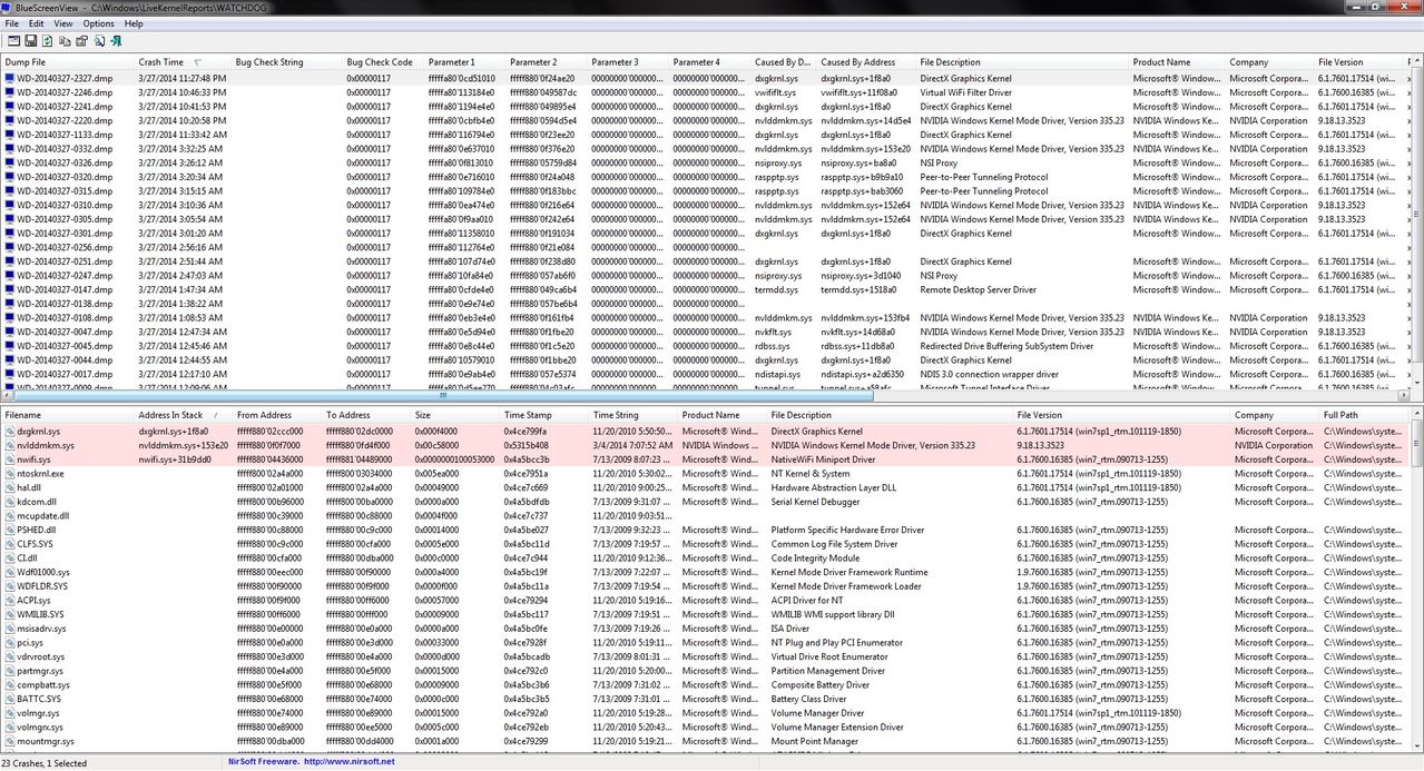

Saraph Posted March 28, 2014 Author Share Posted March 28, 2014 Link 1 bios brings me back to low rez 16 bit. Second bios works just as well as the very first one, anytime I try and run GPU-Z I bsod. Here is a screenshot of the BSOD errors. Quote Link to comment Share on other sites More sharing options...
