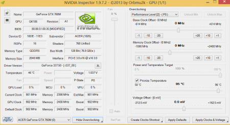

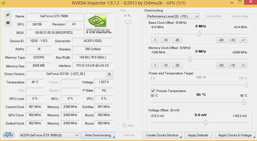

I managed to flash my bios using the FPT tool in bios and then it unlocked the advanced tab in bios as well as the gpu is doesnt downclock/ throttle anymore. i managed to get the gpu it to 1056mhz core and 4800mhz memory and it's very stable as well. Try to undervolt your CPU if you want to increase the voltage of your GPU thou, because you might run out of power and the laptop swtches to battery when that happens. Try using the static value instead of the dynamic, it's a lot better for haswell CPU. I got my CPU stable at core voltage 0.95v which reduces heat and consumption a lot, the cpu cache voltage an the other hand won't stay stable below 1.03v. I've increased voltage of the gpu to 1078, but I am not sure if I should try to push it further, cause it might generate too much heat or damage the gpu permanently. What do you think would be the highest safe voltage for the GTX 760M?
memory 4800mhz??are you sure???how do you set static value?in intel xtu its greyed out for me and i cant switch from adaptive to static?i got big problems with cpu temp after flashing when gaming even with 100mv undervolt in xtu
Actually my temps are fine with modded bios...just my gpu voltage jumped from 0.825V or 0.850V(not sure) to 1.037!that was the main heat problem i guess but i will test it now with less voltage for gpu..is the gpu under w a s d keys?cause i feel the heat a bit when temps go above 80C..i didnt felt the heat few months ago with same temps
i would help you but i dont know if you can use my vbios to flash..im not soo good in computers like other guys..Btw guys if you need more psu power you can undervolt integrated gpu..i undervolted for 30mv and its stable..no crashing while browsing etc..I also undervolted cpu 111mv and power managment is 99% and disabling wifi and bluetooth in device manager can help too..I tryied with static voltage but its seems worse for me..Anyone else having better results with static voltage?maybee im doing something wrong.
