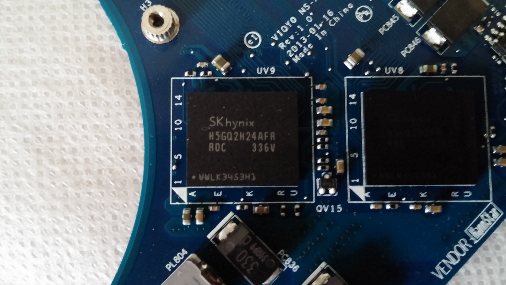

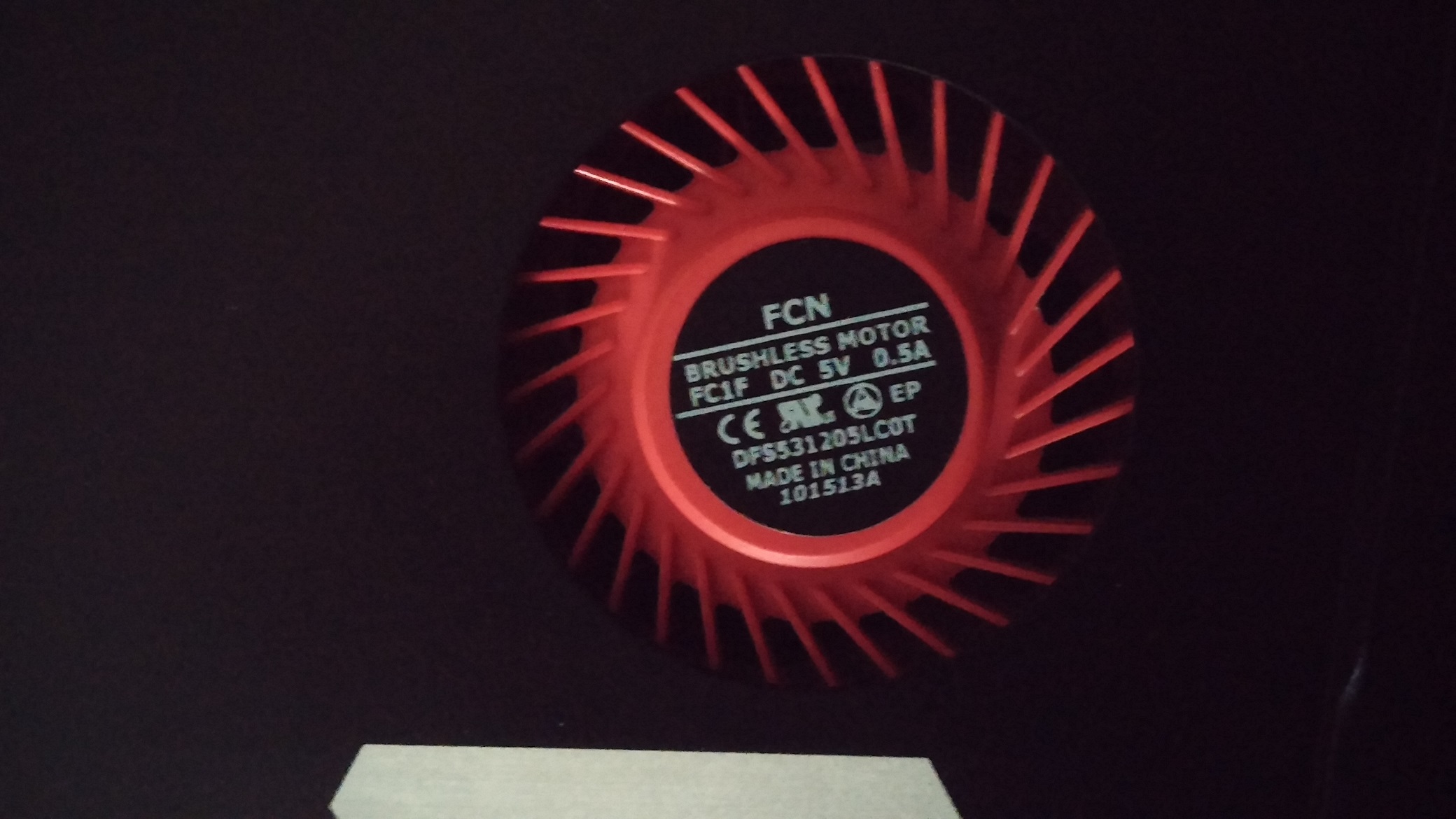

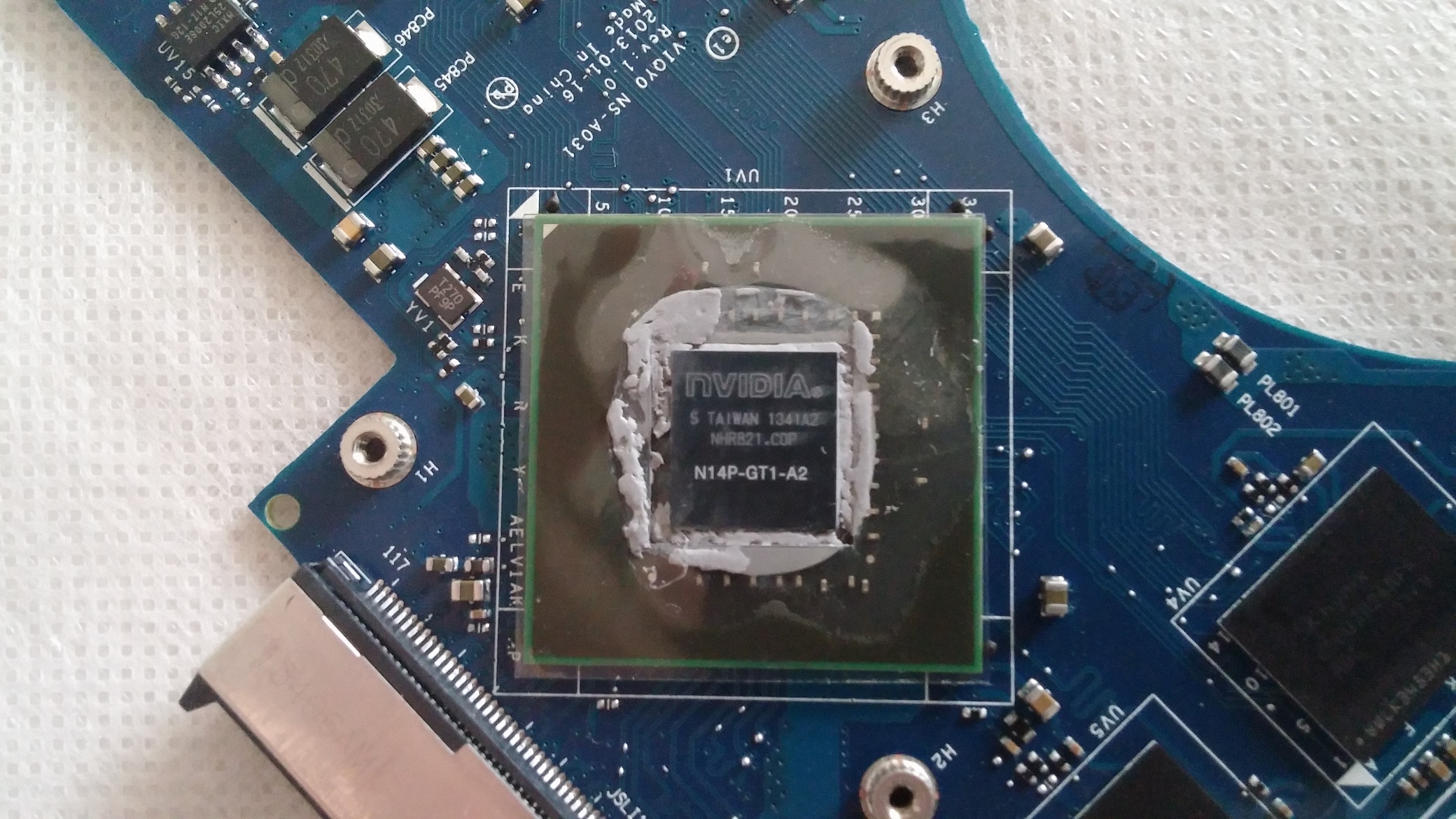

fejerm Posted January 1, 2014 Share Posted January 1, 2014 It reaches 98C without laptop coolerpad quite fast. I have attached pictures of my fan, GPU die and VGA memory to this post. I have tested, if the ultrabay FAN was running on max RPM, it would help a LOT. I've ran a game while I started dust removal and until the fan was running on max RPM the 2nd VGA temp started to decrease. Wonder if it would be possible to mod the system bios or 2nd vga bios to force the fan to run on max rpm ... Quote Link to comment Share on other sites More sharing options...
sullyman86 Posted January 1, 2014 Share Posted January 1, 2014 hmmm odd. I have samsung memory on mine. Are you able to overclock your memory? i oc mine to +400mhz. i havent tried to go any higher yet. that fan looks exactly like mine so my theory of the different fans affecting temps is blown away. Do you have all of your springs on the screws that hold down the heatsink to the GPU? There should be three silver springs and three silver screws.Would you mind trying something? Put two objects under the rear feet of your laptop to raise the backend similar to what a laptop cooler would do. then take a desk fan (i use a honeywell fan) and put it behind your laptop and point it toward the underside. Try gaming this way and let me know what temps you get. I was able to bring my cpu temps down from 85c to 70c in battlefield 4 by having this setup with the fan on high. Just curious if it will affect your ultrabay temps or not. Quote Link to comment Share on other sites More sharing options...
fejerm Posted January 1, 2014 Share Posted January 1, 2014 hmmm odd. I have samsung memory on mine. Are you able to overclock your memory? i oc mine to +400mhz. i havent tried to go any higher yet. that fan looks exactly like mine so my theory of the different fans affecting temps is blown away. Do you have all of your springs on the screws that hold down the heatsink to the GPU? There should be three silver springs and three silver screws.Would you mind trying something? Put two objects under the rear feet of your laptop to raise the backend similar to what a laptop cooler would do. then take a desk fan (i use a honeywell fan) and put it behind your laptop and point it toward the underside. Try gaming this way and let me know what temps you get. I was able to bring my cpu temps down from 85c to 70c in battlefield 4 by having this setup with the fan on high. Just curious if it will affect your ultrabay temps or not.overclock would be pointless since the ultrabay VGA is already melting ... In theory i could OC higher with Hynix RAM.I have this cooler: http://content.hwigroup.net/images/products/xl/197243/cooler_master_notepal_xl.jpg CM Notepal XLIt helps a little bit, but not much. The temp of the ultrabay VGA still reaches 98C, the only difference that it takes a little bit more time to reach it. I've also repasted with Arctic MX-4 and did not help anything. Quote Link to comment Share on other sites More sharing options...
