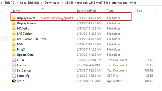

grandanoke Posted March 2, 2014 Share Posted March 2, 2014 No you can't, try the vBIOS mod option, AC power set windows to high performance -> open Nvidia Control panel set power option to high performance.what do you mean vbios mod option , i did follow your instructions when i installed the card and downloaded the 334.89 driver(latest) and replaced all files(numbers)with the one you told me? what else can i do?- - - Updated - - -sr for being noob about that ..but explain what is vbios (a12 unlocked?) and how can i upload it .. Quote Link to comment Share on other sites More sharing options...

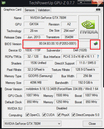

J95 Posted March 2, 2014 Share Posted March 2, 2014 @grandanoke Download the latest GPU-Z Download TechPowerUp GPU-Z v0.7.7 | techPowerUp click save card BIOS and upload the vBIOS file here (.zip), helping members upgrade succeed. Thanks. Not the M17xR3 system BIOS A12, but the gtx 770m vBIOS http://forum.techinferno.com/general-notebook-discussions/1847-nvidia-kepler-vbios-mods-overclocking-editions-modified-clocks-voltage-tweaks.html#post23432 Quote Link to comment Share on other sites More sharing options...
Robbo Posted March 2, 2014 Share Posted March 2, 2014 @grandanoke very few were able to successfully upgrade their R3s/770m proving that it is vBIOS related, so you could request svl7 to modify this specific version to 'rev 02' (adjustable voltage/power target...) http://forum.techinferno.com/general-notebook-discussions/4635-bios-vbios-modification-request-thread-svl7.html consider donating.Download the latest GPU-Z Download TechPowerUp GPU-Z v0.7.7 | techPowerUp click save card BIOS and upload the vBIOS file here (.zip), helping members upgrade succeed. Thanks.That's a good idea j95, so that other users can just use grandanoke's VBIOS to make sure their 770M is compatible with the R3 - and plus if svl7 modifies it then it will be a fully overclockable & overvoltable option as well! It's been a bit of a mystery as to why some 770M's work and other's don't so it would be great to have nailed it down to a specific VBIOS file that is compatible with the R3. 1 Quote Link to comment Share on other sites More sharing options...
grandanoke Posted March 2, 2014 Share Posted March 2, 2014 That's a good idea j95, so that other users can just use grandanoke's VBIOS to make sure their 770M is compatible with the R3 - and plus if svl7 modifies it then it will be a fully overclockable & overvoltable option as well! It's been a bit of a mystery as to why some 770M's work and other's don't so it would be great to have nailed it down to a specific VBIOS file that is compatible with the R3. so now you gonna use me? ((...nah just kidding:) gimme instructions step by step ....and simple as possible what to do... Quote Link to comment Share on other sites More sharing options...
J95 Posted March 2, 2014 Share Posted March 2, 2014 Click the green/black icon and save the vBIOS file.[ATTACH]11101[/ATTACH]That's a good idea j95, so that other users can just use grandanoke's VBIOS to make sure their 770M is compatible with the R3 - and plus if svl7 modifies it then it will be a fully overclockable & overvoltable option as well! It's been a bit of a mystery as to why some 770M's work and other's don't so it would be great to have nailed it down to a specific VBIOS file that is compatible with the R3.Yeah, already PMed @tacumadesigns http://forum.techinferno.com/alienware-m17x-aw-17/5951-problem-a12-unlocked-bios-not-showing-hidden-menus.html Quote Link to comment Share on other sites More sharing options...

J95 Posted March 2, 2014 Share Posted March 2, 2014 ok i did save it.....btw the most serious problem i have is that every 20 min the nvidia divers stop responding..and i have to close the game sometimes...(although the drivers recover )at least i want someone to help me solve that:/- Uninstall drivers (previous drivers leftovers) Display Driver Uninstaller (DDU) V12.4 first uninstall option (Safe Mode)- Download GeForce 334.89 WHQL- Extract driver 7-Zip/winrar -> Nvidia...International folder delete the following folders:Display.OptimusDisplay.UpdateGFExperienceGFExperience.NvStreamCGFExperience.NvStreamSrvLEDVisualizerMS.NETNetwork.ServiceNvVADShadowPlay- Display.Driver folder -> copy/overwrite nvdmi.inf (unzip) nvdmi.inf_v334.89_AW_M17xR3_GTX_770M- Nvidia...International folder\ -> run setup.exe 1 Quote Link to comment Share on other sites More sharing options...

Robbo Posted March 3, 2014 Share Posted March 3, 2014 frist i will have to unistall the old nvidia dirvers(which are the 334.89 ...although they are not oldXD)? and then extract the new driver(the same ) , delete all that files, and then copy that thing you gave me and install it?i didin t get the "safe mode" and the last part where i have to copy/overwrite that file(driver) , in case sthing go wrong and the driver failed to install(like it happens most of the times even with the original driver ) i will be able to boot the laptop normally and try again? - - - Updated - - - the first time i tried to install the driver , it failed twice before it installed:/ thats why i am asking you.. It was j95 that gave you the instructions for how to do a clean install of your drivers, so if you're unsure then hopefully he'll be able to come back to you. But according to his instructions I understood it as: 1) Uninstall drivers using Windows control panel 2) Run Display Driver Uninstaller (DDU) V12.4 and choose the first uninstall option (Safe Mode). 3) - Download GeForce 334.89 WHQL 4) Extract the driver using 7-Zip 5) Go to the NVidia 'International' folder in the extracted driver and delete the following folders: -Display.Update -GFExperience -GFExperience.NvStreamC -GFExperience.NvStreamSrv -LEDVisualizer -MS.NET -Network.Service -NvVAD -ShadowPlay 6) In the Display.Driver folder -> copy/overwrite nvdmi.inf with (unzip) nvdmi.inf_v334.89_AW_M17xR3_GTX_770M 7) Run the Setup.exe file in the International Folder, which will sucessfully install the driver All I did there was copy & paste what j95 suggested to you & put in a few of my own words. - - - Updated - - - btw forget to mention that the hwinfo can r recognize my gtx770m , only at the compal ec section it says gpu .it could recognize my old gtx580m and there were 2 more sections only for the card (volts ,tempe,mhz and bla bla) As long as GPUz is showing that it's recognizing the card in all it's areas then I should think that's fine. 1 Quote Link to comment Share on other sites More sharing options...

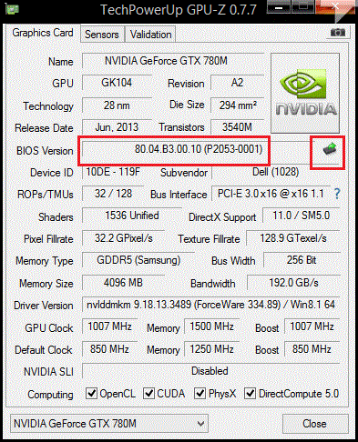

J95 Posted March 3, 2014 Share Posted March 3, 2014 @grandanoke DDU/uninstaller to remove any leftovers of the 580M. - Include Display.Optimus to the folders list above. - Post GPU-Z screenshot and upload the corresponding vBIOS file -> right click -> send to 'Compressed (zipped) folder' or 7-Zip Add to "xxxxxx.zip". Quote Link to comment Share on other sites More sharing options...
