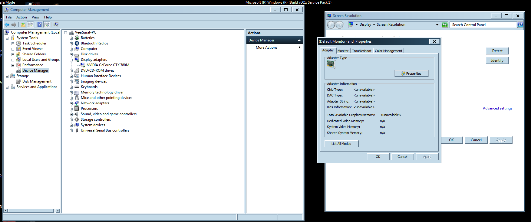

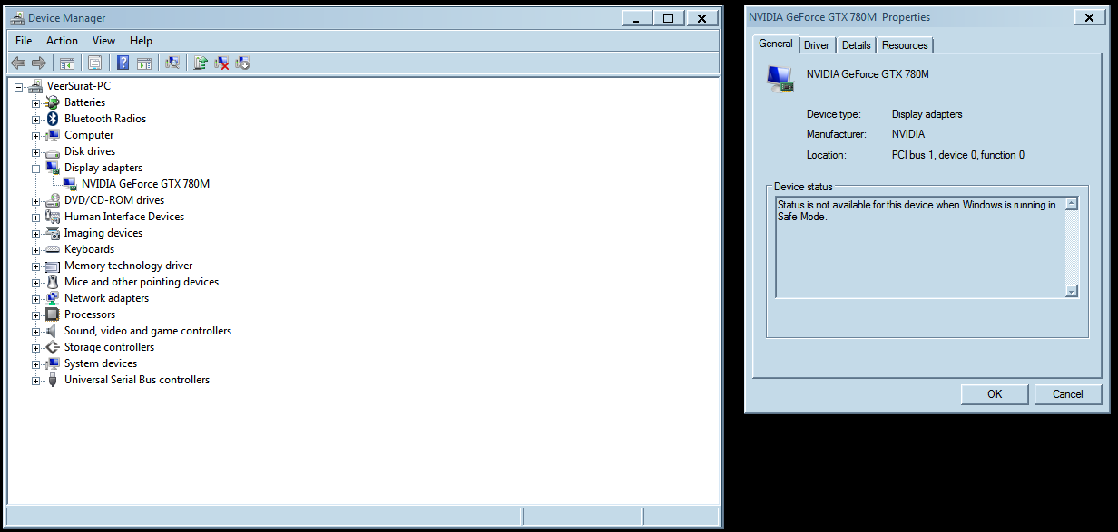

veer 13 Posted June 28, 2013 I did install the unlocked bios A12 for the R3, manage to find the video config options, and i did disable the integrated GPU (didn't touch any other settings).I reinstalled the 780m, got pass the boot screen onto the screen where windows 7 loads( the windows 7 animation) then no login screen or anything, my whole screen is just showing different colours or sometimes just white, then a beeeep, then it restart (or crashes not sure, no BSOD).So what I did is I booted into Safe Mode, and everything works as it should, got to the login screen, typed in my password and it loaded. I checked the device manager, to verify display adapter, it said standard VGA( ok!!??), so i uninstalled the current nvidia driver which was the 320.xx and had to restart. Got back into safe mode, installed the driver which is available on the upgradeyourlaptop's ebay page Index of /support/drivers/upgradeyourlaptop/Alienware.The driver version is 311.27, it detected the device and installed, but there was no screen blinking or anything during the process (which is weird right?) and then said installation completed and i closed the setup (which was the only option available).I went back to the device manager/Display adapter, where now it shows the GTX 780m.(was so excited). so i restarted the system went back into normal mode. I have the same problem still, the screen stays white or red or pink or..... then a beeep and it restarts (my guess it crashes cause i got a crash report when i went back into safe mode). In Safe Mode its still show the adapter the is 780m.I'm not sure what is causing this, my guess, i have to tweak something the the bios setting or maybe installed a Vbios update or a modified version. Or maybe the driver is not working properly. As i said i'm not sure.I also checked the screen resolution/ advance setting, and no information about the GPU is available under the adapter tab. it all says not available. Checking the adapter properties, the driver is 'VGAsave'.I need advise, anything u got is most welcome.thank you everyone. Quote Share this post Link to post Share on other sites
svl7 5702 Posted June 28, 2013 Did you change the primary display to PEG and IGD to disabled (internal graphics device, igd - if I remember correctly)?You might want to try the latest Nvidia beta driver. Quote Share this post Link to post Share on other sites
veer 13 Posted June 28, 2013 i changed display to PEG and the IGD was disabled. i still have the same problem. Now in safe mode i cant install the drivers, its not detecting the card. i also tried a new driver 320.49 beta with no luck, it did not detect the hardware either.When the display is in SG, the 311.27 does detect, but not the 320.49.how about the pci express graphics, should change anything in the options. Quote Share this post Link to post Share on other sites
svl7 5702 Posted June 28, 2013 You need to modify the .inf file in order to install the driver. Quote Share this post Link to post Share on other sites

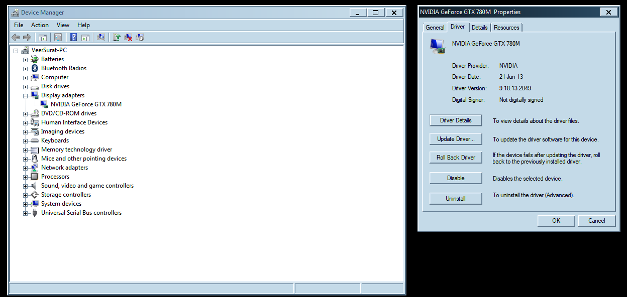

J95 961 Posted June 29, 2013 Every time the system Bios is flashed load optimal defaults then restore settings.Use nvcvn.inf v320.49 instead, it's already modded.nvcvn.inf.zip 1 Quote Share this post Link to post Share on other sites
veer 13 Posted June 29, 2013 do i paste both the nvdmn.inf and nvcn.inf into the 320.49 driver "display.driver" folder or only the nvcn.inf. Quote Share this post Link to post Share on other sites
veer 13 Posted June 29, 2013 Tried installing driver v320.49 with only the nvcvn.inf, it did detect and install, but when i booted back to normal mode from safe mode, i got the blank screen again. here are the steps i did (hoping this helps) : Step 1. turn on the system press F2 to get into BIOS press F9 to restore default setting. I cannot immediately reboot after this as i'll get stuck at the boot screen.(alien head logo boot screen) Step 2. Entered Video Configuration Special Features - enable powerXpress - muxed fixed scheme Primary Display - PEG (was SG) Internal graphic - Disabled (was on AUTO) Pci express graphic: ASPM - AUTO PEG workaround - Disabled Always enable PEG - Disabled PCI Express Configuration(under the advance tab): Dmi link ASPM control - Disable (was already disabled but i was wondering if i should change it) Step 3. F10 save and exit F8 to load boot options booted into safe mode with networking Step 4. copied the nvcvm.inf launch the 320.49 waited for extraction then the setup wizard failed to detect the hardware. Pasted and overwrote the nvcvm.inf into the extracted folder C:\NVIDIA\DisplayDriver\320.49\Win8_WinVista_Win7_64\International\Display.Driver. went back to C:\NVIDIA\DisplayDriver\320.49\Win8_WinVista_Win7_64\International, run the setup.exe Wizard detects the hardware and installs it successfully. (I chose the express installation first then after fail to boot in normal mode, I redid everything above then chose custom where i selected only the driver itself and the nvidia audio, where it fail again in normal mode,both installation were successful according to the setup wizard.) I went to Device manager/ Display Adapter, it shows GTX 780M. Step 5. Restarted into normal mode where it boots and get to the window7 animation loading screen after this my screen goes completely white or pink or blue, etc. i'm attaching some pics for more info. Again i would really appreciate any help i can get from you guys. thanks. Quote Share this post Link to post Share on other sites
