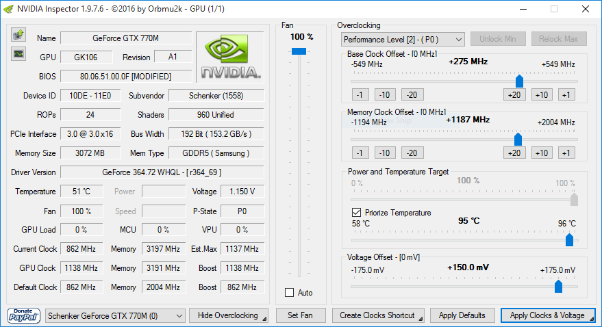

hey thanks to your quick guide, it gave me an idea where to start with memory OC/OV on my ancient 770m lol I was able to go from ~2000 mhz memory to ~3200 with samsung memory @ 1.51v (stock 1.35v), used 4B pencil as i noticed its less grainy and thus dust and airflow doesnt wipe it out easily i guess, though still havent tested it >1mo. I also had to raise vbios tdp limit since the core started to throttle after memory overvoltage, and now its perfectly stable. http://i.imgur.com/3iRJwed.jpg http://i.imgur.com/eA3MHcc.jpg http://i.imgur.com/V7T8MoL.jpg offtopic, did you actually remove the backside memory from your 980m? " MSI 980m 4GB (no pointless backside memory wasting power) " thats awesome for OCing...
