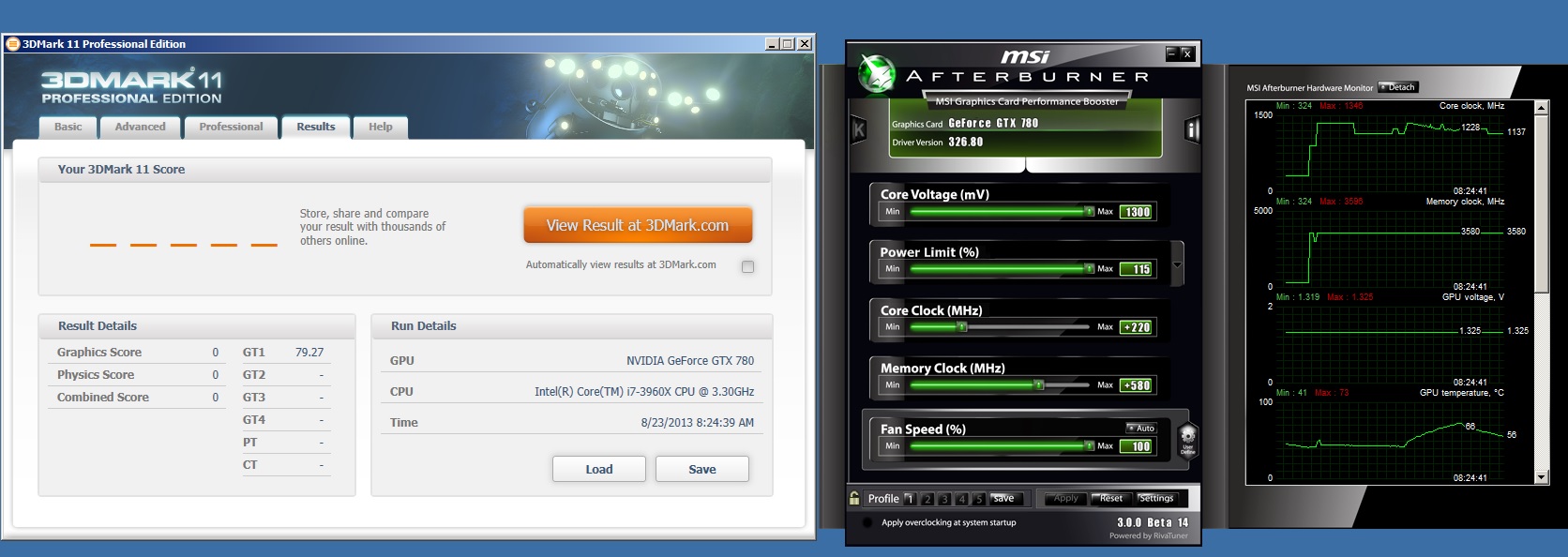

[ATTACH=CONFIG]8746[/ATTACH]
[ATTACH=CONFIG]8747[/ATTACH]
Amazing scores! Grats to you and svl7.

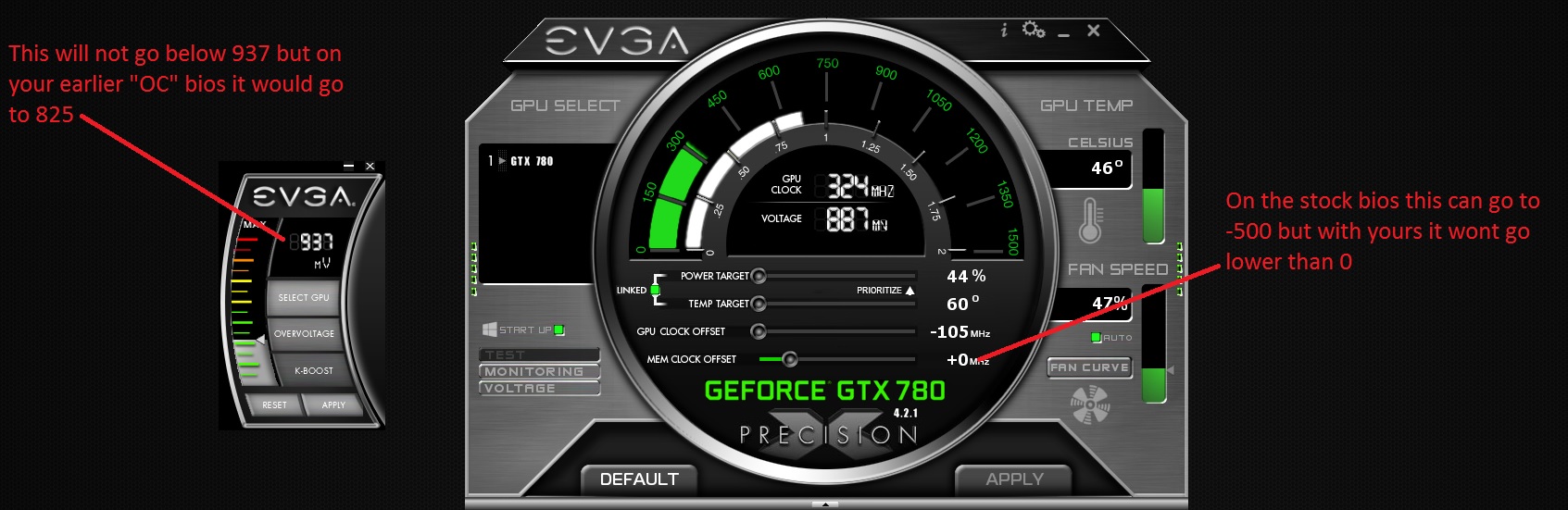

I flashed to the Nvidia GTX 780 (EVGA) - 80.10.3A.00.01 - 'OC edition v03' as I had your older "OC Edition" and now I can no longer set my voltage any lower than 935 where as before I could get near 800, Also now I cannot lower my memory clock below 0 in EVGA Precision X where as before I could get -502MHZ but I can get this on the stock VBios.
Also your REV03 VBios is only 198KB in size and the older one was around 250KB, what changed ?

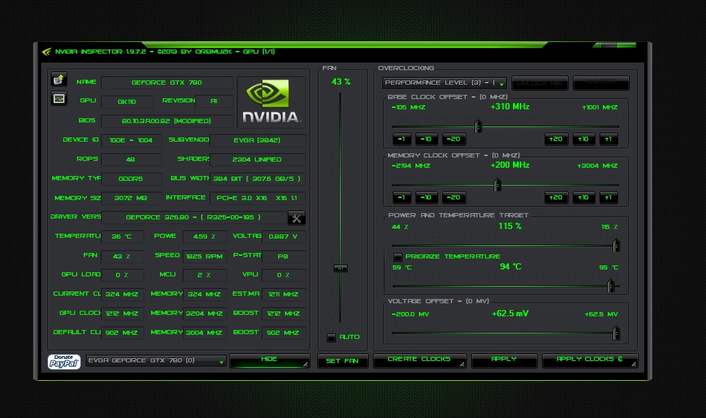

You are able to lower the 3d voltage per software with the stock vbios? Can you send me a screenshot of Nvidia Inspector when you use the stock vbios?
No that's not what i meant, in your last OC bios i could lower the voltage below 935 now i cannot and the memory will not go below 0 in precision x like it did before in your last oc bios but with the stock bios the memory will
In short with this vbios, I cannot underclock or undervolt like with your older one, rev 1 or 2 maybe

I still don't get what you mean, please post the screenshot I mentioned.

With EVGA precision? It certainly didn't allow for undervolting with the inspector... but anyway, what do you want with a 3d P-State at 0.825v? That's totally pointless.
Lower temps and the ability to underclock even the memory like I could in your previous bios :)
