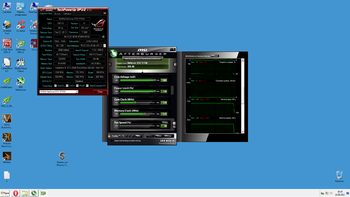

SVL can You make BIOS with higher voltage ?
Do not worry.I will burn my card :)
And higher Power Throttle.
Like this enginering BIOS :) Pleeeeeeeeasssseee :)
Call it : TITAN KILLER SVL :)
You can't reach the power target of svl7's bios with 1.21 volts, which is max without any voltmods.
As i said before his gpu-z shows the real clock for his base clock.
He is using the engineering bios with gpu boost 2.0 which means that the actual clock of the gpu is much higher than the baseclock shown in gpu-z.
You are using svl7 bios without gpu boost, you get the clock that you set.
There is nothing wrong with your card, just clock it higher. You need a higher offset with svl7 bios because it doesn't use gpu boost.

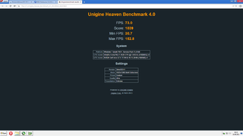

Scores :
1.SLV7 BIOS : 5838
2.Asus BIOS : 5795 (END,no possible OVC more,out of 3D Mark every time)
Maybe on SLV7 i can go more with Memory clc,but i doesnt give visible effect.
Voltage : MAX reported by Nvidia Inspect.monitor : 1.2.
Temp : MAX 83 C
Fan speed : max 72 %
I want to break this magic 6000p barrier.
I will try with this ENG Bios or I will connect 220 V straight from wall to this card :) !!!
Thanks everybody for help.Now I understand a lot more of this magic card,bios,programs.
