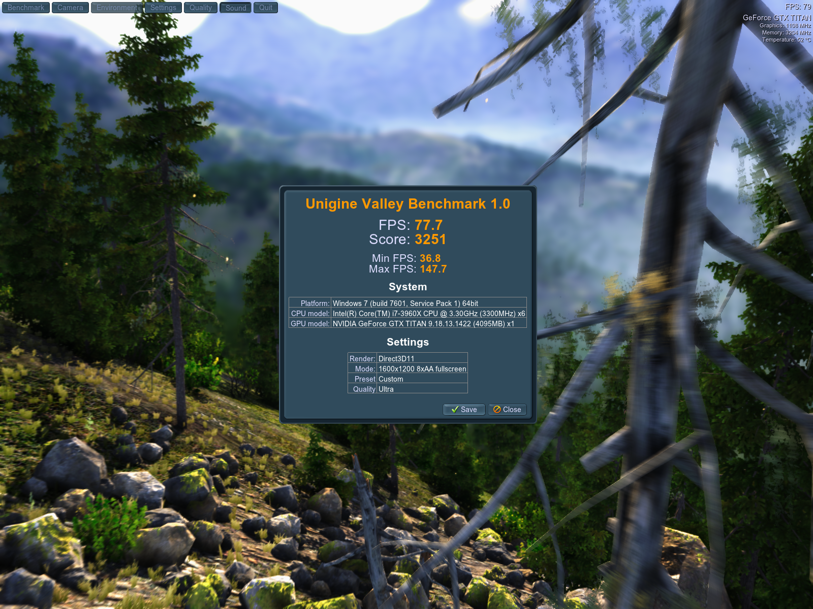

just flashed with your bios and beat my Valley score by 100+
my old highest was in the 3120's mark.
thank you svl7 enjoy your beers!
that wasn't even my highest clock speed my highest clock speed is 1188mhz on core and that was just my gaming clock 1100mhz! u r the man!
