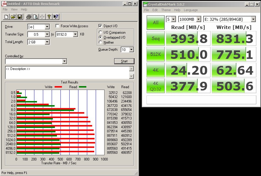

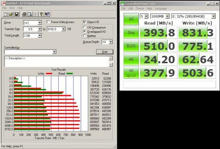

Hi,
New to forum and new owner of P570wm. So far I'm loving this mobil workstation with the exception of the weak bios. I just got mine built up a couple days ago and have been testing it out and have run accross a couple oddities.
For starters, I've got two Corsair Force 480 gig drives striped. they are both on the sata 3 ports. My reads are 1/2 of of the writes which is ususally backwards of what you would see. Any thoughts? I've checked drivers/etc but haven't come across anything odd. I've also have an OCZ 256gig drive on the Sata 2 port as my boot drive. It's obviously being throttled.
I do a fair amount of video editing and 3D animation while traveling, hence why I built this computer. I'd really like to get the read speed of the raid up to where it should be.
thoughts?
Thanks
