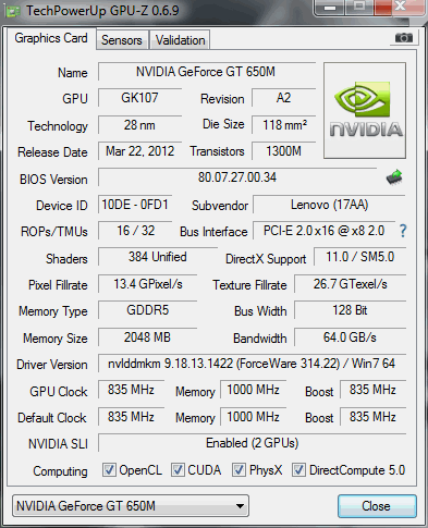

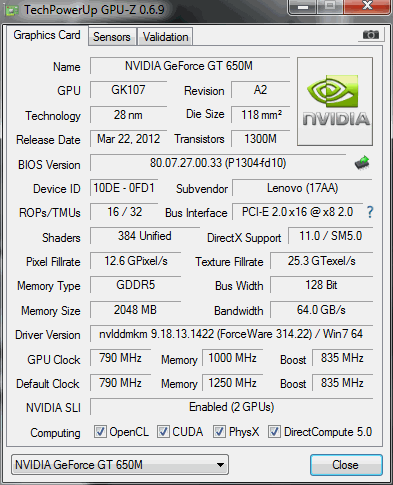

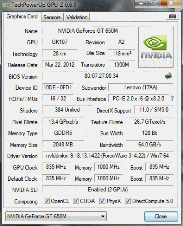

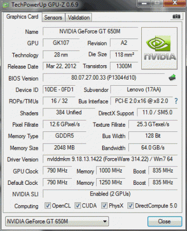

I did notice one "problem" with the vbios after spending a little more time with it. It looks like it only flashed on the first card.
I can overclock card 0 as high as I like, but card 1 caps at 924 (+135).
In NvidiaInspector, Card 0 shows a modified bios as expected, but card 1 shows stock.
Any suggestions?
Thanks again, everything else looks solid.
Interesting. So you have an additional GPU in the multi bay? What does GPU-Z or Nvidia Inspector tell you regarding the vbios version of card 1?
Hmm, I thought I changed both, let me check again.
Edit: @LewsTherin05 - It seems the extension bay handles the vbios stuff differently... I'm not sure how exactly it works, but maybe the vbios gets copied to the extension module and since you already had that version there it didn't update... but that's wild guessing.
Can you try dumping the vbios of GPU1 with GPU-Z or nvflash? Though I doubt you can access it.

Yea I'm getting "BIOS reading not supported on this device" for either card using GPUz to dump.
NVflash is showing "No NVIDIA display adapters found"
It seems to me as if the additional GPU comes with an eeprom for the vbios, else I can't really explain this behavior... If that's the case then I wonder how the vbios update happens. In case it happens at POST when the system sees that the module has an older version then we might be able to trick it into updating. I'll see what I can do.
