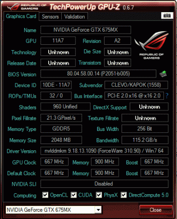

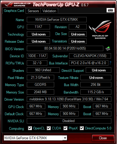

buluunee Posted January 31, 2013 Share Posted January 31, 2013 yeah i need that too also cant find any modded vbios for msi gtx675mx. Its a shame that its vbios is locked when the build of this card is literally monster oc ler. btw here is my back up of vbios made with gpu-z http://share.gogo.mn/vSZ1y8ae3A4891359647298/11A7.rom i think its same with luoxia's vbios but who knows.. oh yah,,i have just read some post of yours from some dude's topic which you mentioned that vbios of yours forces gpu to work under full load all the time <- that will shorten the life span of the gpu? for me i am a 3D score chaser so i would not need to use my nvidia gpu all the time and also gaming w.o oc is fine so i would really like to push my gpu to its limit when benchmarking and during normal usage i would stick to stock clock speed and low temps. oh ya btw unlocked vbios can control fan speed right? coz its locked for me atm which is pain in the butt.. and also THANK YOU whether its successful or not.. Quote Link to comment Share on other sites More sharing options...

buluunee Posted February 1, 2013 Share Posted February 1, 2013 okay tnx for reply mate... i would ofc stay away from unlocked vbios of 680m since its not a fail proof. so is there any chance to get a modified vbios on gtx 675mx?btw i just got 5 posts here and just saw luox's vbios screen shot and mine is different than him Quote Link to comment Share on other sites More sharing options...
