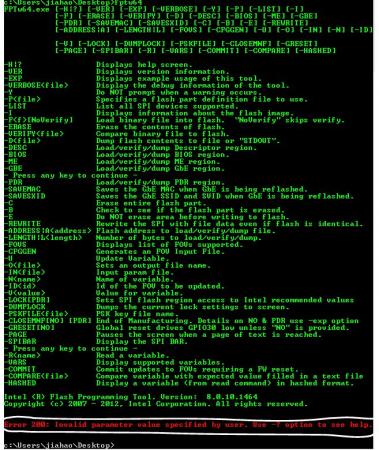

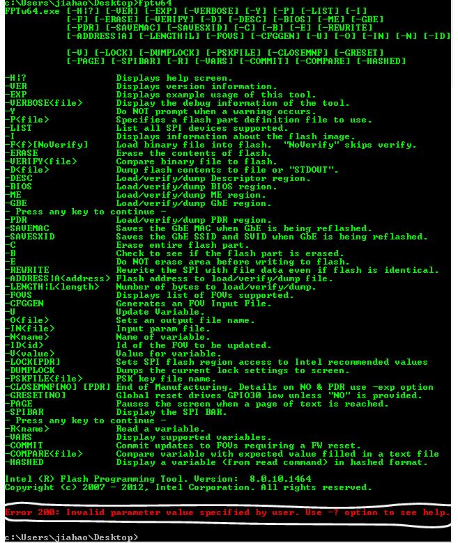

i am getting this "Error 200: Invalid parameter value specified by user. Use -? option to see help." when i try to backup my bios
Make sure you're typing everything correctly. This may or may not help, but before extracting the zip files, right click -> properties -> select unblock -> hit apply and OK. Start command prompt as admin by hitting start, type cmd, right click -> run as admin. Once open, type: "cd c:\your\file\path\of\BIOS\Fix<file path="" of="" the="" bios="" fix="">" Obviously without the quotes and add your file path with what's there<file path="" of="" the="" bios="" fix="">. Try copy and pasting all the commands, you can't ctrl-v in cmd, so just right click->paste. I'm nearly certain the problem lies with how you're typing it since the error you're getting is "invalid parameter value specified by user" and that's pretty much saying you typed something wrong.</file></file>

well i can't enter any parameter wrong, cause i haven't type anything yet.[ATTACH]10289[/ATTACH]
Yeah, I don't know what you're trying to do so.. maybe someone else will help
