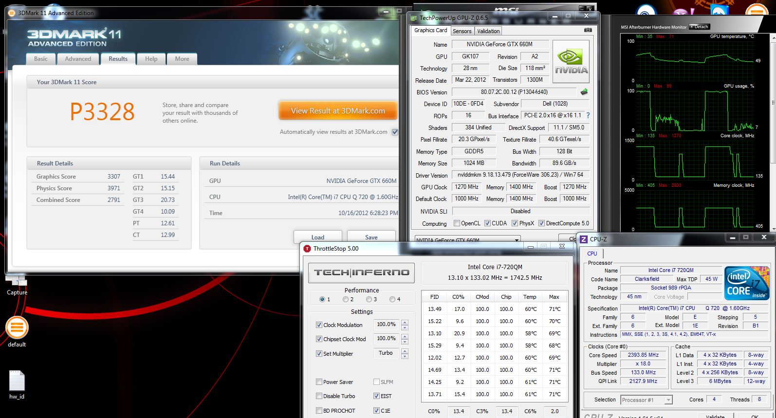

I am always in High Perf. Adapter is plugged. Weird thing is I reverted it back to the 1st VBIOS in the guide and I am getting 835Mhz (original clock). Flashed it again to the clevo OC version, still i am capped to 700Mhz. Really weird as I did not change anything at all. Could I have bricked my card? :(
I got it to work again this morning. :)

I or maybe my daughter accidentally clicked on BD PROCHOT, unticked it and i got it to go up past 1000Mhz.
I also noticed, if i enable VSYNC on games, GPU clock gets capped down.
I am now playing with the slider finding a sweet overclock spot. I could reach 1300Mhz but if you tinker with a game's graphics options, the driver crashes and MSI AB resets the clocks of the GPU.

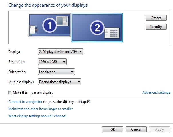

I now got it to work on my HDMI TV using the DP-to-HDMI adapter. What happened was that it detected it as a VGA display.
post-6143-14494993816722_thumb.jpgWhen it detected it as VGA, there was still no display on the TV.
Then i reinstalled the drivers, restarted it and Bam, i suddenly got it to display and system detected it now as HDMI. Problem solved.
