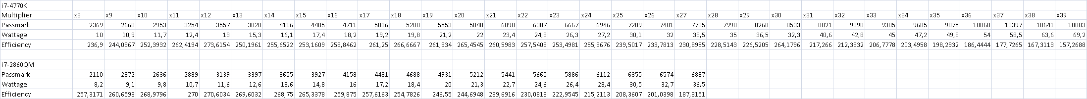

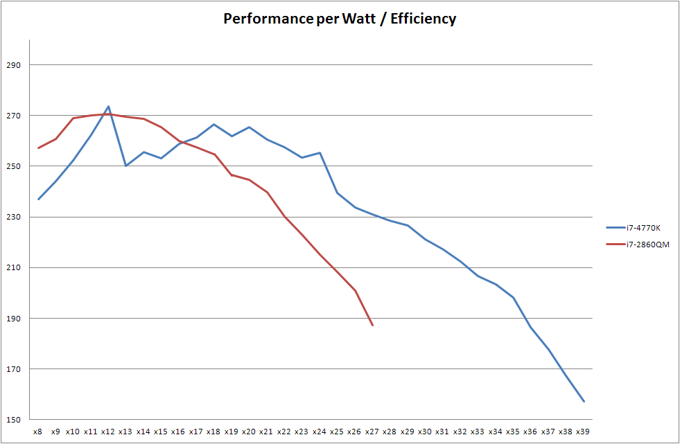

Finally yesterday the i7-2860QM arrived so I naturally played with it for a while. Here are my findings:
Highest turbo due to TDP throttling was x27, single threaded the CPU does 3.6GHz turbo. Compared to i7-4770K the efficiency is still OK and even surpassed the newer Haswell on lower multipliers
Performace measured in Performancetest 8.0 on Win7 x64. Score measured for every multiplier, then divided by stable Watt figure in Throttlestop.
However Passmarks are not reliable indicator of performance across platforms as it penalizes the use of 32bit OS and generally include CPU features, rather than focusing on raw power.
Real world difference is between 4-6% on same multiplier.
3dMark06 score went from 4750 to 5053 most likely due to extra 5M of L3 cache.

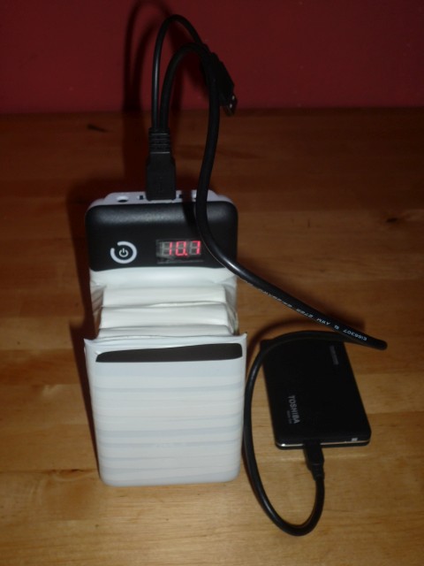

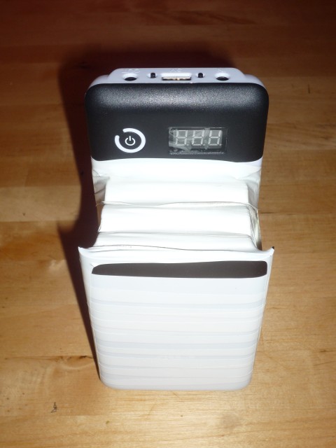

Weight - about 1.25kg, but provide more than enough runtime even for older, less efficient laptops, such as R60.

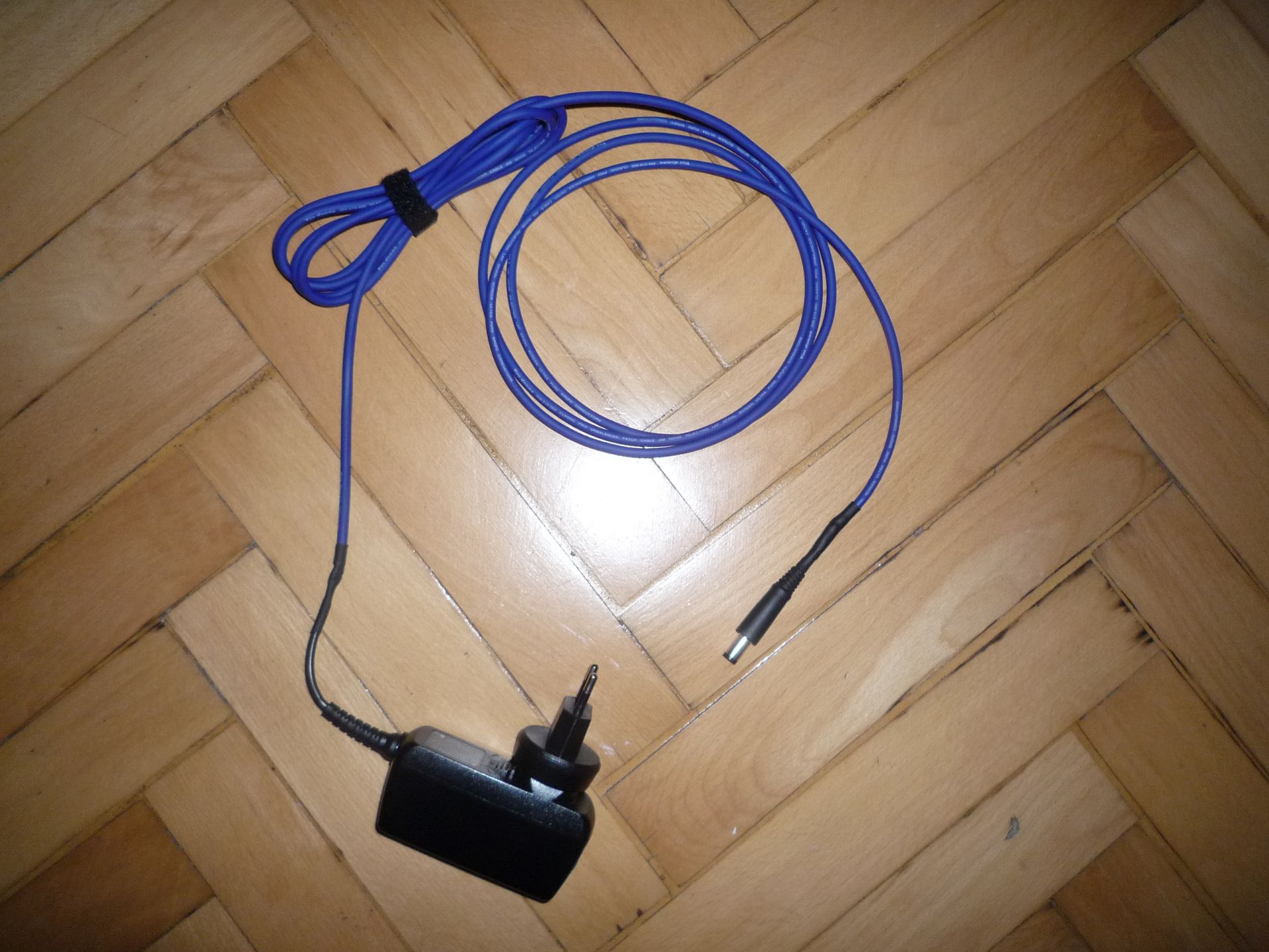

This is how the AC adapter looks like when finished.
180 grams versus 290 and about 3 times more convenient.
40W - runs flawlessly 2530p and non-turbo 2560p/2570p.
I've also replaced stock cable with Van Damme Unbalanced Pro Patch with silver plated OFC copper core - much lighter and more flexible.
Tested the OL protection, kicks in at about 2.35A and shuts down the DC part for 3 seconds. No explosions for this one :)
Marked as Efficiency level V - based on my testing dissipates less than 1W in 5W load, 0W under no-load condition.
Played CS:Source on 2530p while charging 9-cell. Adaptor passed with flying colours, temps were below 45°C.
I'll write a short DYI, that is if anyone is interested...
