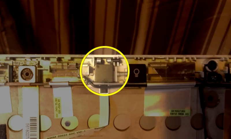

I'm looking to get the nightlight diffuser cap and spring as showing in this pic of different model but is almost the same:
Its attached to the front black bezel, is it possible to get those parts without the bezel?
Thanks.
