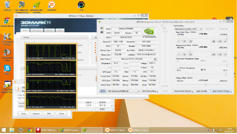

I own a GT60 PE dominator pro with 880m. After heavy cooling mod ( backplane drilling, adding additionnal heatsink, custom laptop cooler) i can say i can old the 880m at full loard 80°C max.
Today i tried overclock all day long, and the result is disapointing. With stockvbios 880m is throtlling to stock clock even when i set +135MHz to clock and +250 to memory. I can do a full 3D mark bench it's stable, but nvdia inspector show that max clock doesnt match the overcocked frequency.

That picture doe not really explain much.
It does explain alot, in nvidia inspector i set +135MHz/250MHz with +112.5mV.
I end up with around 8150 in 3DMark 2011.

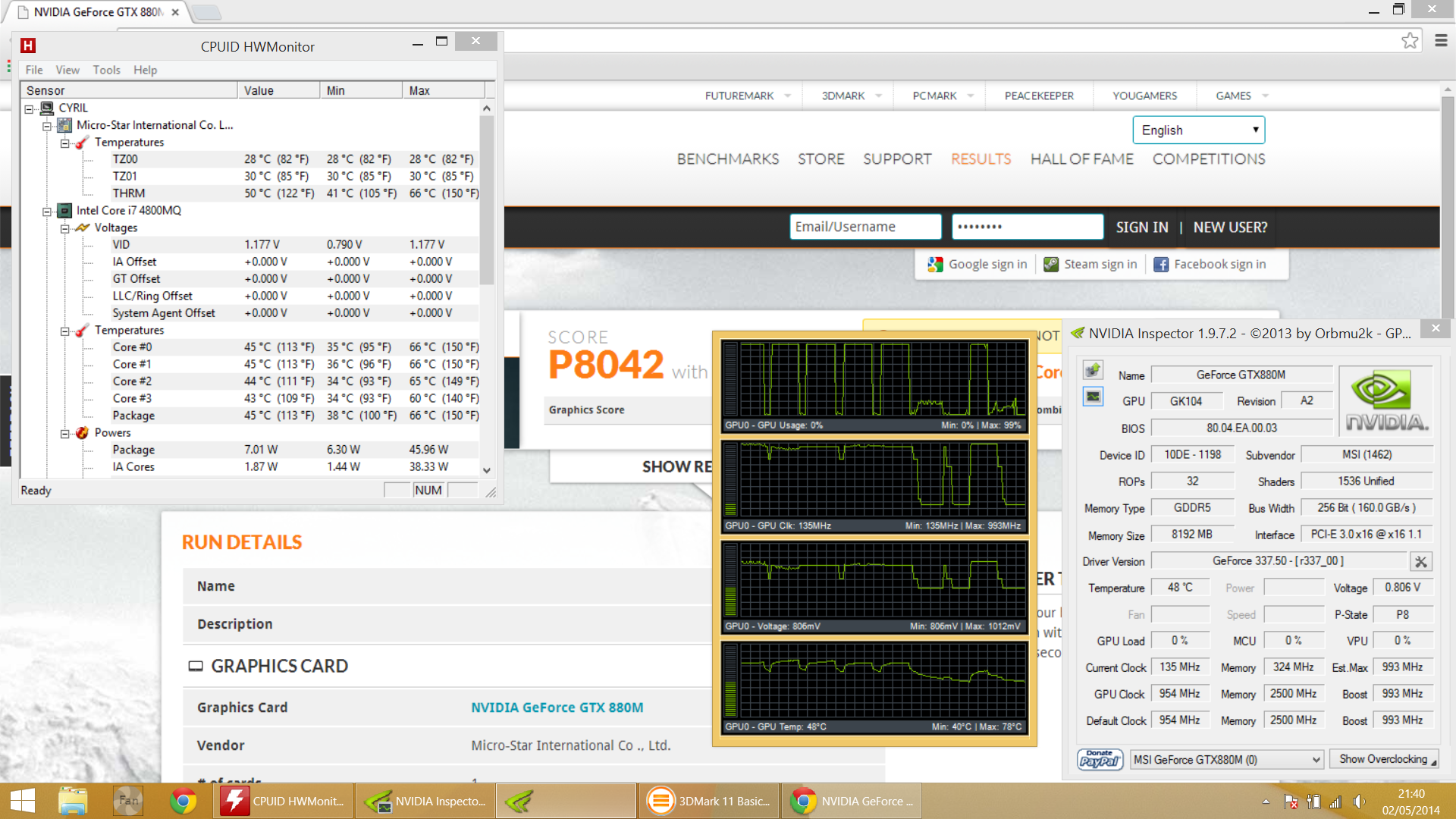

On stock frenquency i got between 7950 and 8050 at 3D Mark 2011.
I am sorry for the poor quality on the screenshot, it was showing that even with overclocking, the new nvidia boost feature make my overclock useless. As when the GPU isn't enough loaded, the card simply clock down.

Thanks for the comparison scores, yes you can tell that the overclock doesn't really do much for the 880M on the stock vBIOS. You said that it throttles when the card's not loaded, which you said caused your low score - actually it's the opposite, your card is getting overloaded & then downclocking in response. But yes, not much point in overclocking the 880M on the stock vBIOS according to your results at least. Anyone else, post up your scores. :-)

Yes sorry that's what i meant, when the GPU get too much load, he downclock itself :) Even with a good temperature! <80°C in my case.
Update /!\ : I have tried to push voltage even more +125mV, this result in a laptop shutdown on 3D mark11 after 2minutes. I don't think my PSU can handle the power needed. Or maybe there is a vbios limitation to the maximum power drawn by the card?

Edit : Added stock 3D mark 11 high res screen shot, poor performance... 8048 with 78°C MSI GT60 PE Dominator Pro.
