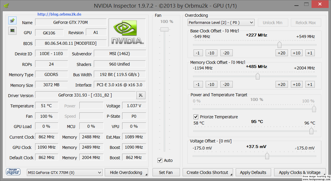

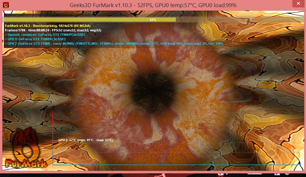

Yeah your GPU score is low, I get 300 points more than you when my core is only at 1006Mhz, so something not right there.
EDIT: I think your Physics score is quite low too, I get only a few points less than you do, and I've only got a 2630QM. Is your CPU getting too hot & throttling, this could lower your GPU score too.
mhh but this time your gpu clock throtteling at 1045mhz.At the last time it was only 1019mhz. if you want i set the power settings in the vbios again higher. I have my core clock at 1160 at the time and i don't get any pwr PerfCap Reason...

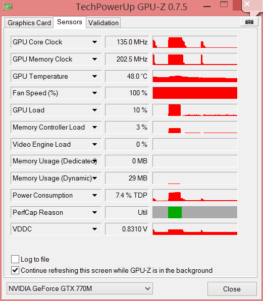

His GPU is not throttling the clocks according to his GPUz sensor readout, so I'm not so certain that this is the problem.

hey robbo yeah i tried everything you suggested still low score and " pwr " problem
