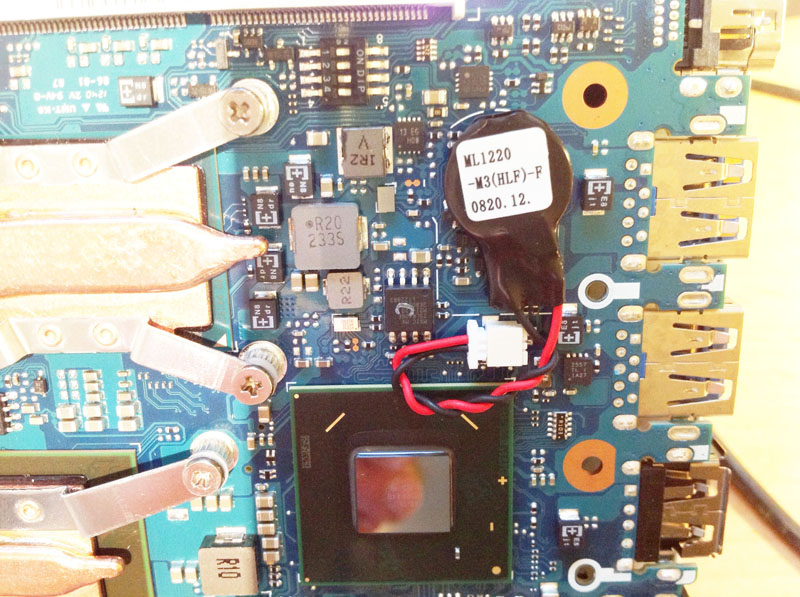

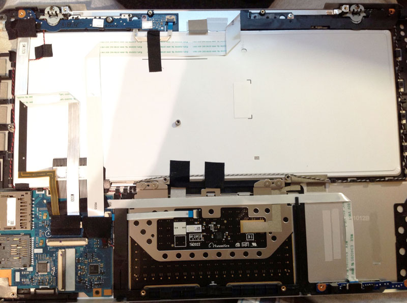

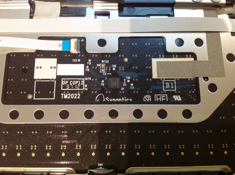

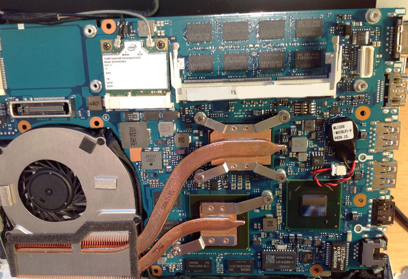

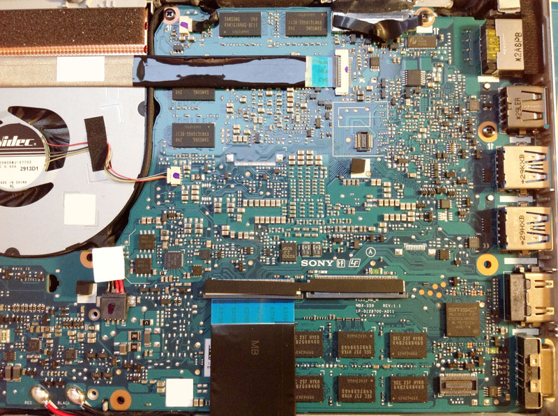

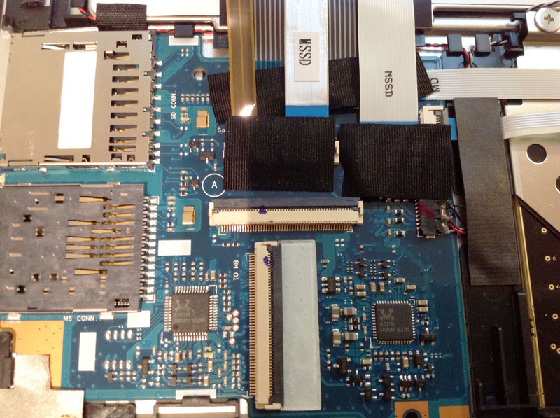

ottelo Posted April 17, 2013 Share Posted April 17, 2013 Here is the Service Manual for SVS131 from 2013: http://www.docs.sony.com/release/MDSM/989095201_sm.pdf 2012 http://www.docs.sony.com/release/MDSM/989092601_sm.pdf And few pictures from my disassembled SVS1312H3ES Windows 8 Model. Images may be helpful for anyone Images.rar (high res images) I disassembled my netbook (you can see it on the pics) to desolder my BIOS flash IC (on the last image right under the battery). It's a Macronix "MX25L6406 EM2I-12G" 8pin SOIC. @ the Bios menu screen (or with CPU-Z) it says its a MX25L6405, the old and discontinued version from MX, because the new chip have the same SPI ID! After desoldering, I've read the content (64Mbit = 8MByte) with the tool flashrom.exe (Win32 v0.9.6.1 - r1671 specially compiled for me and my chip ). I've sent the backup to svl7 to unlock the OC function for me. Quote Link to comment Share on other sites More sharing options...

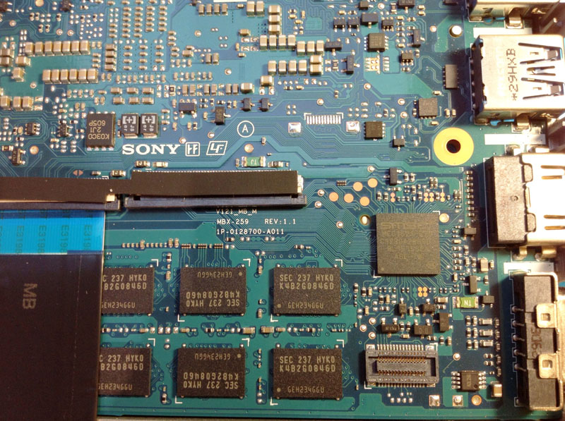

tearsmiling Posted August 29, 2013 Share Posted August 29, 2013 I have pics from the back side of the board. CPU and GPU are facing bottom of the notebook and its extremely hard to access them. Need to disamble the entire notebook to do that. I gave it a try yesterday, but i failed to do it since i could not locate the point where it was stuck. I cant see GDDDR3 controller on the bottom of MB. So it must be on the same side where GPU and CPU are. Quote Link to comment Share on other sites More sharing options...
