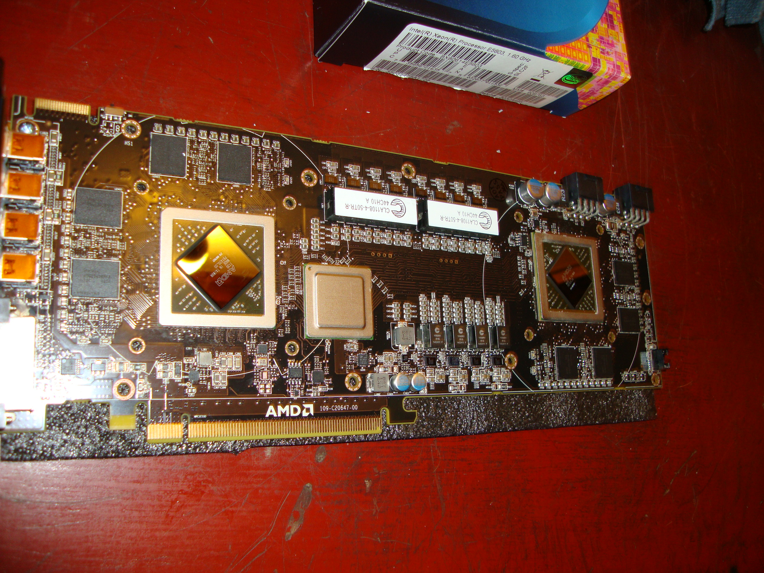

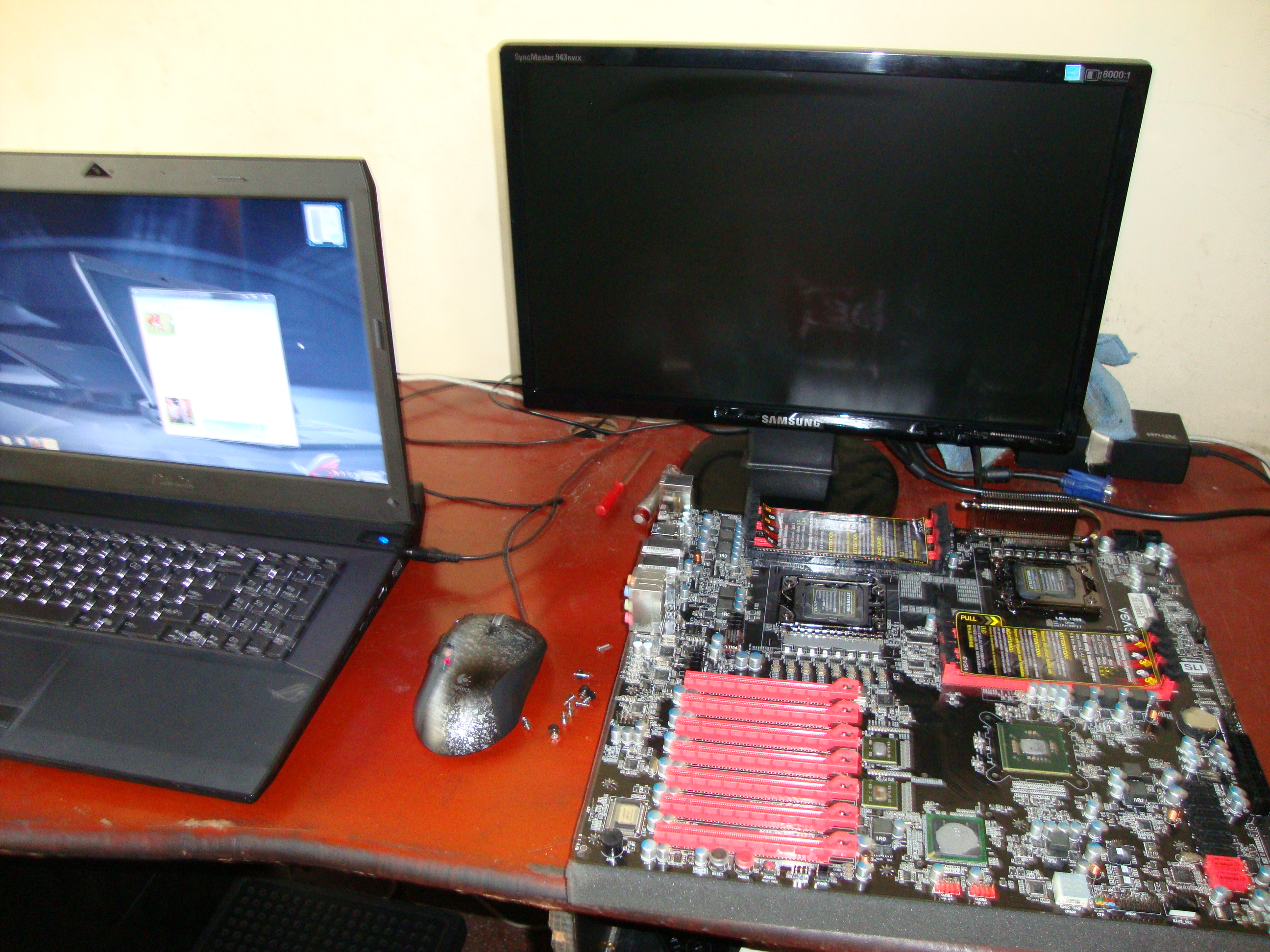

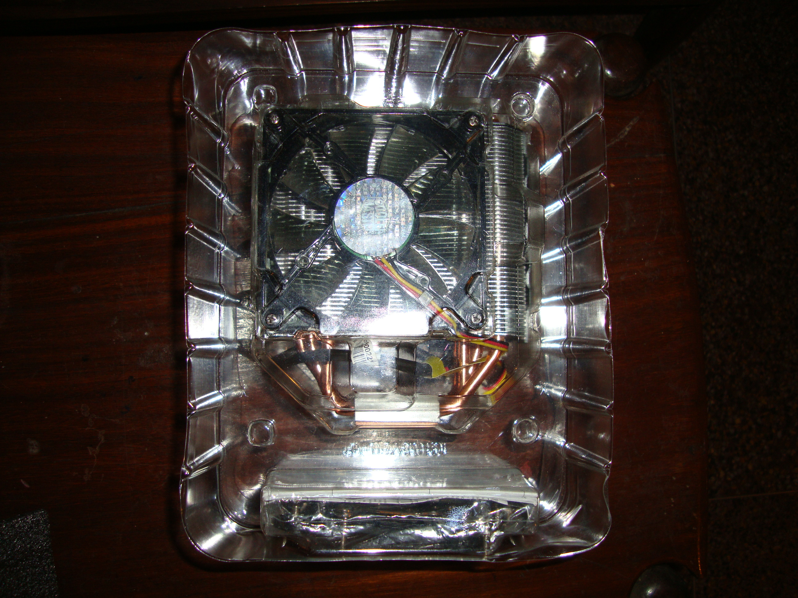

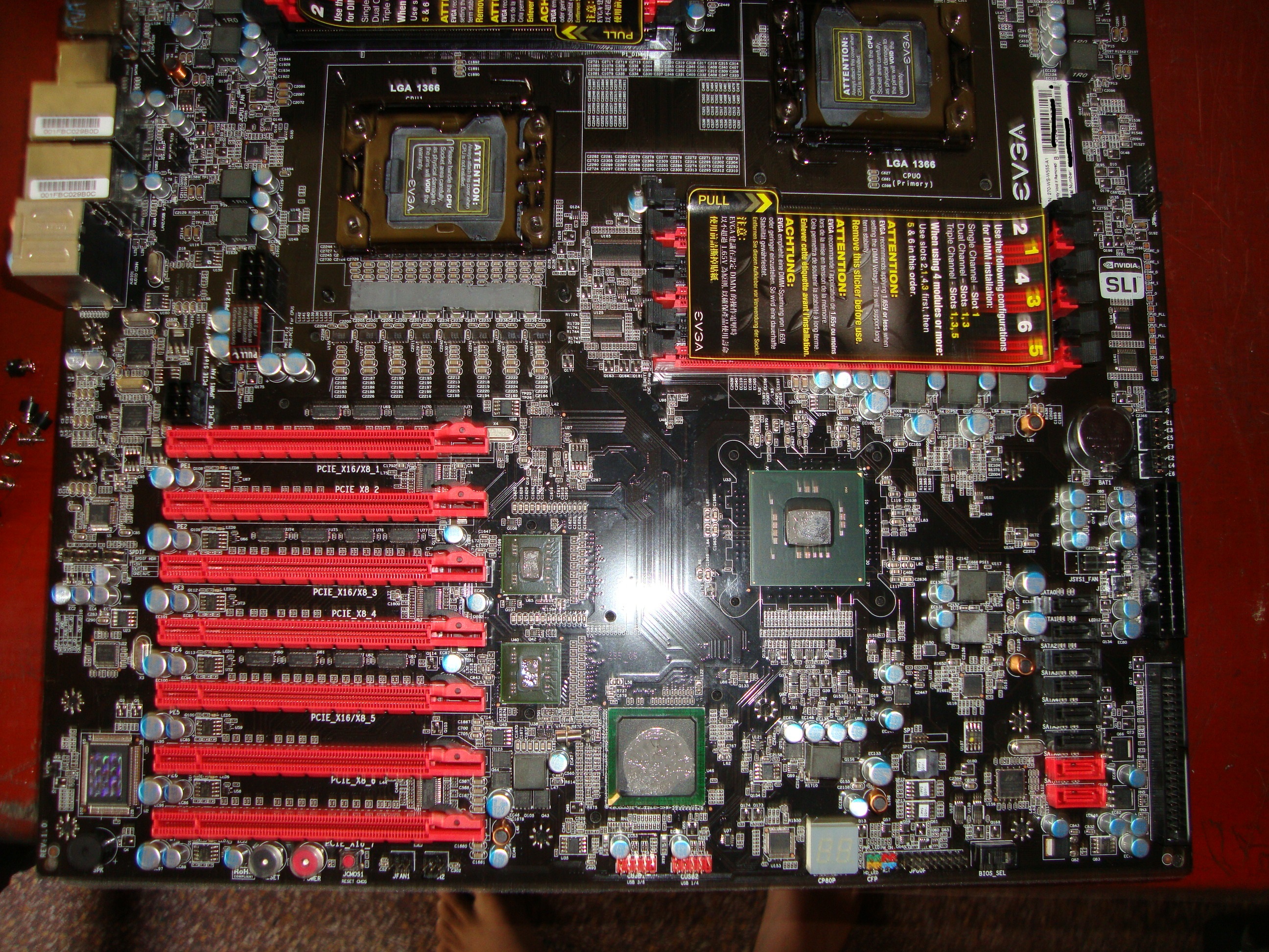

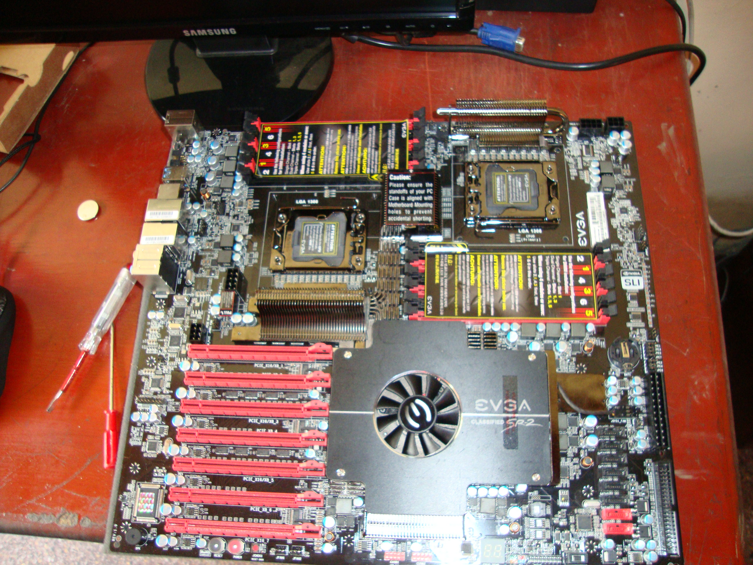

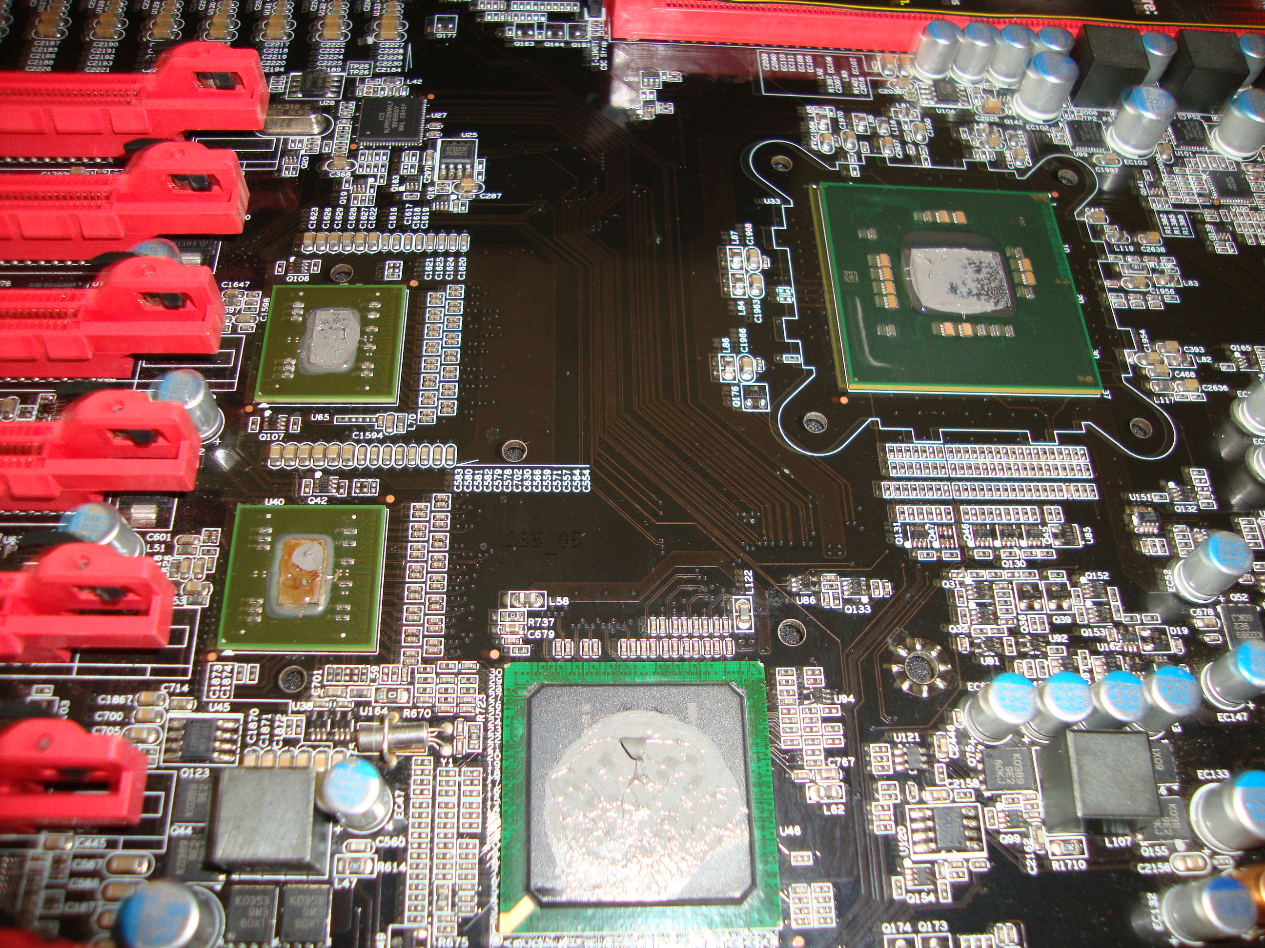

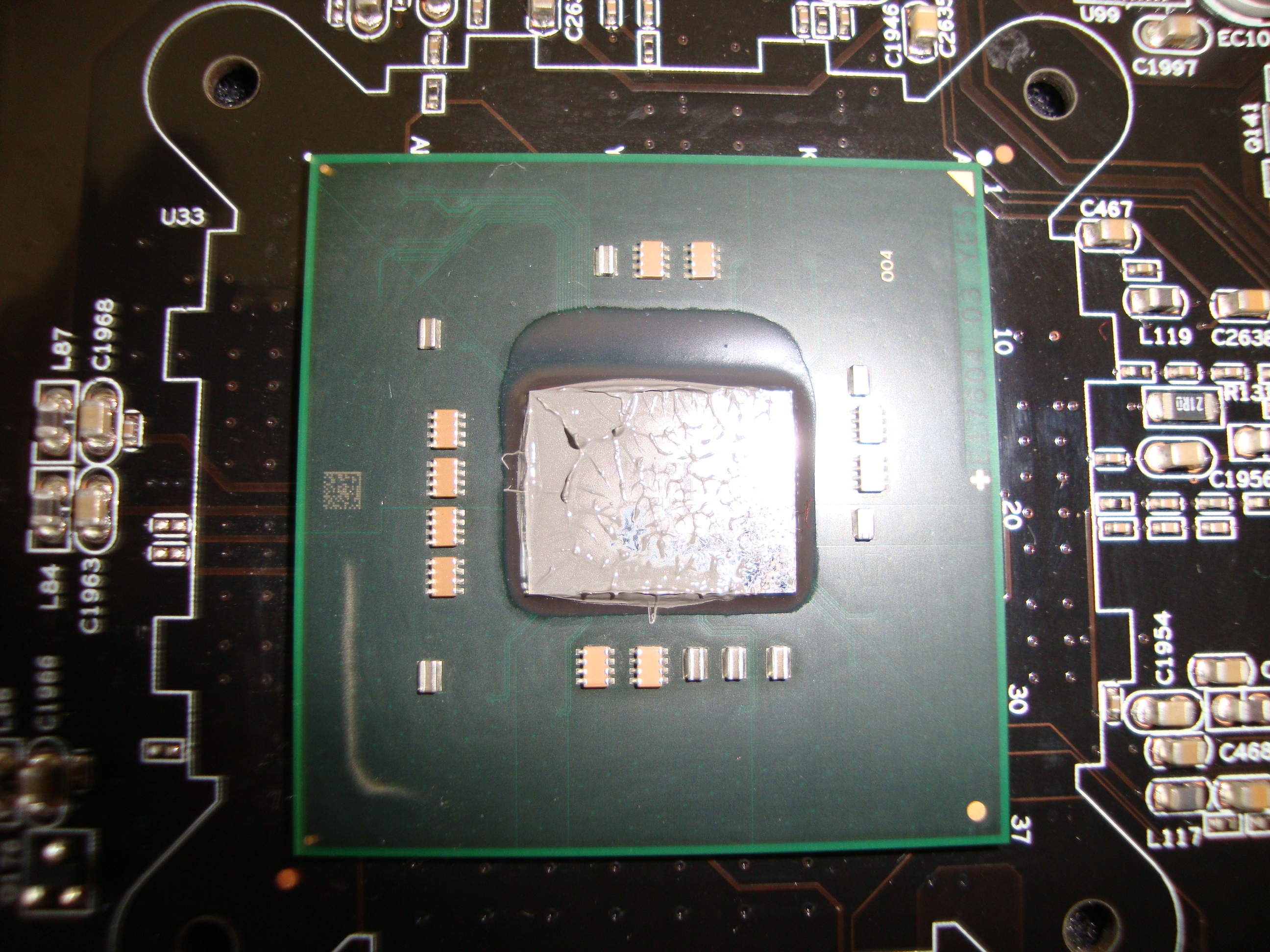

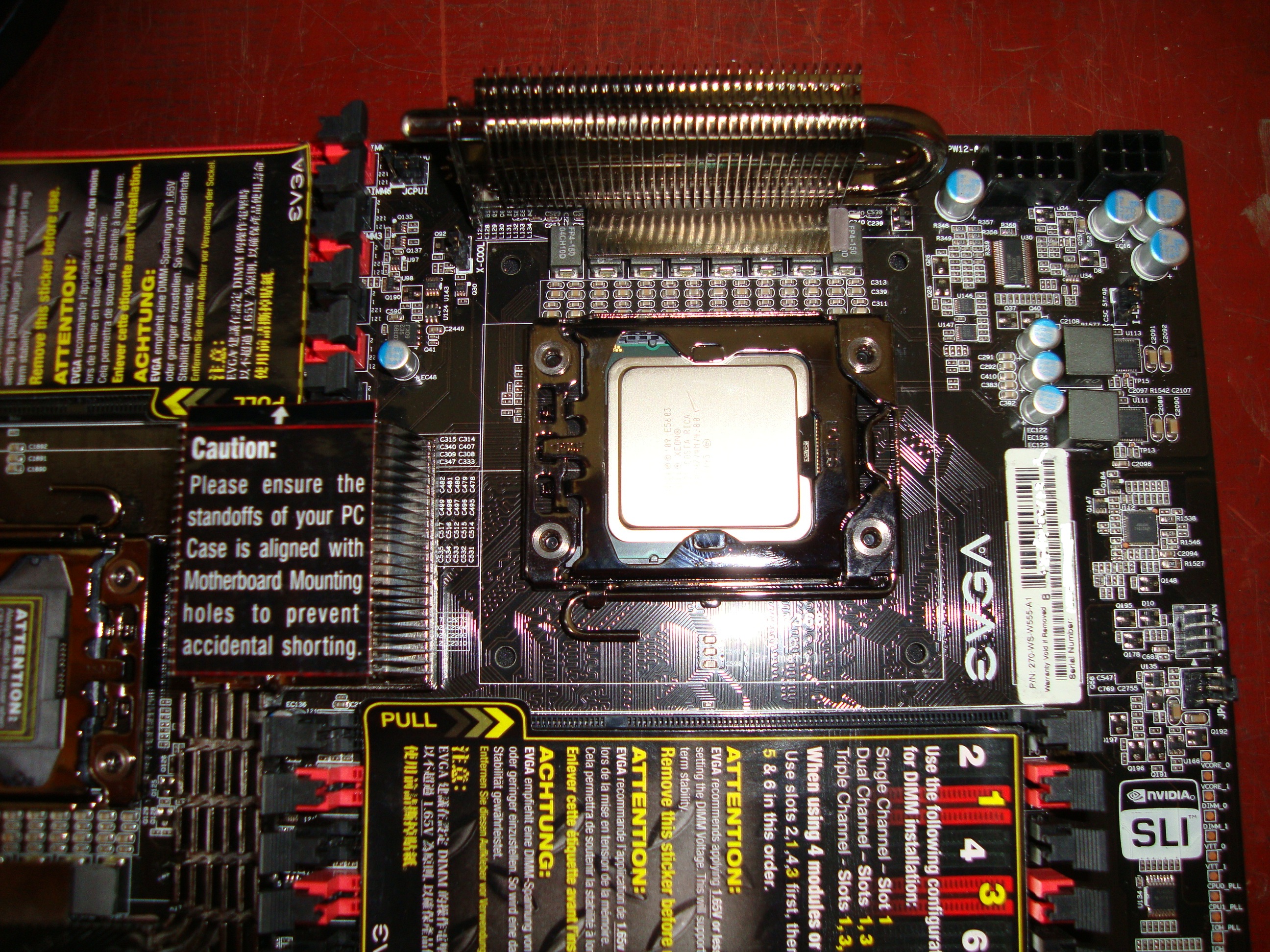

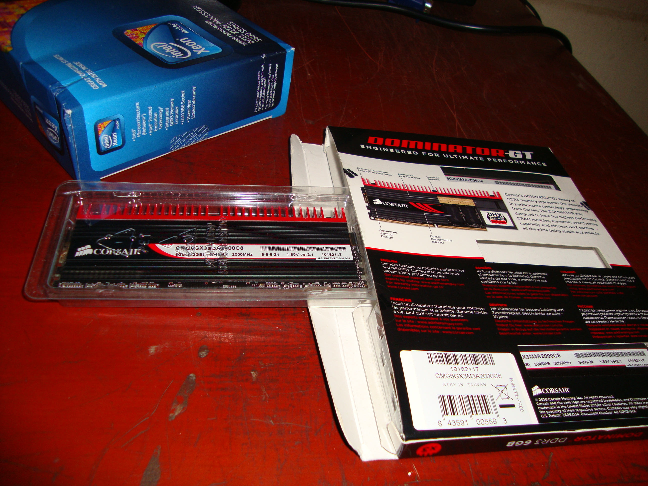

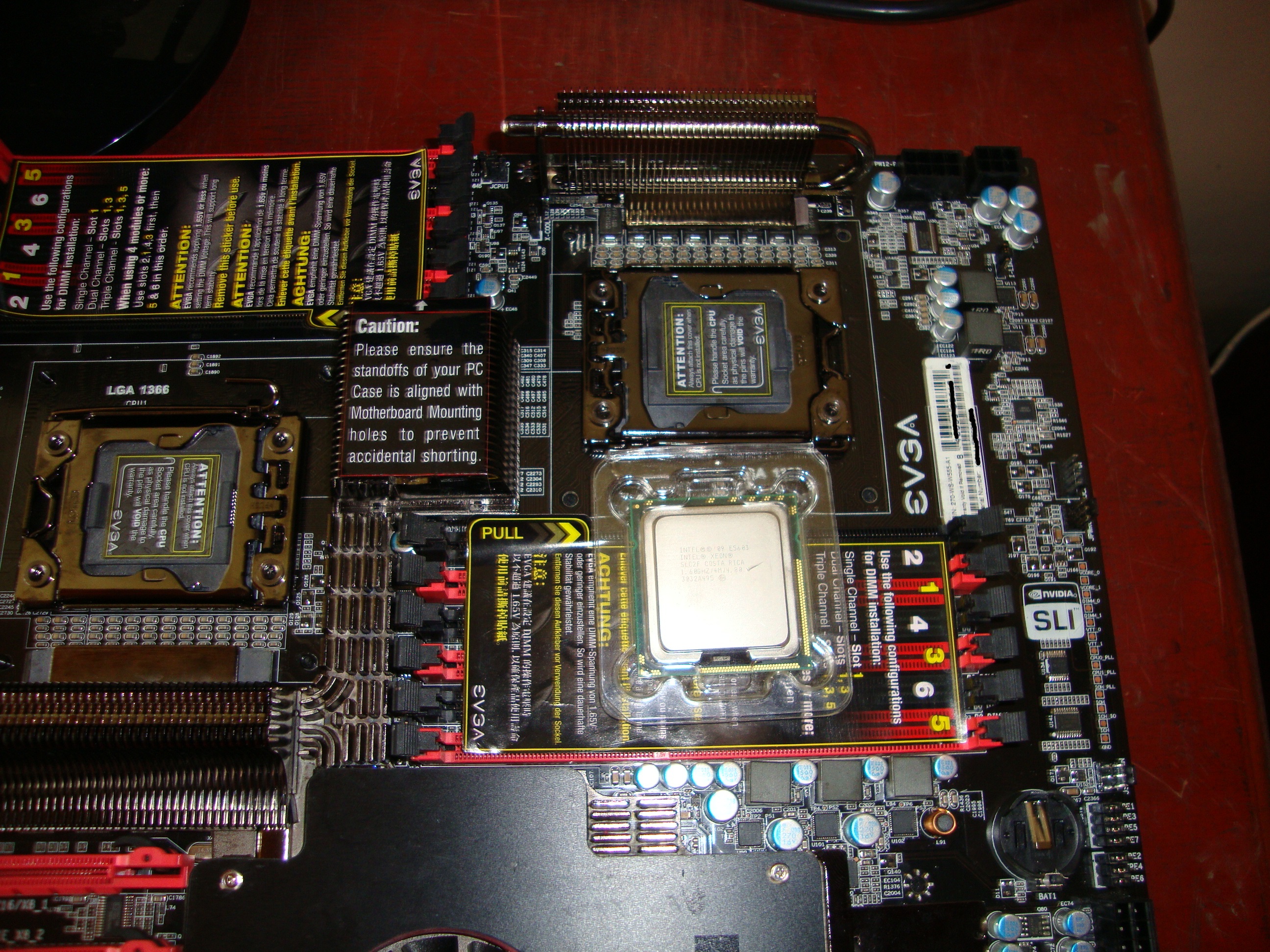

evgasr2 Posted May 4, 2012 Share Posted May 4, 2012 (edited) Hey guys , Just wanted to make a built log for my sr-2 , this is my first experience building a rig on my own. I will need your support to complete it successfully today I got most of the parts I ordered. I know that factory's doesnt do a great job in applying thermal paste , so I repasted before I proceed. hopefully my Asus G73jh is helping me from background . system spec's : EVGA SR-2 1x Intel Xeon E5603 Processor Corsair Dominator GT 6GB ram HD 6990 + GTX 465 vga 19'' samsung monitor 160GB 5400 rpm hdd , I know its the slowest thing on my rig lol. ordered an 90GB ssd and will order an 1.5tb hdd. More update incoming ................. Edited May 5, 2012 by evgasr2 5 Link to comment Share on other sites More sharing options...

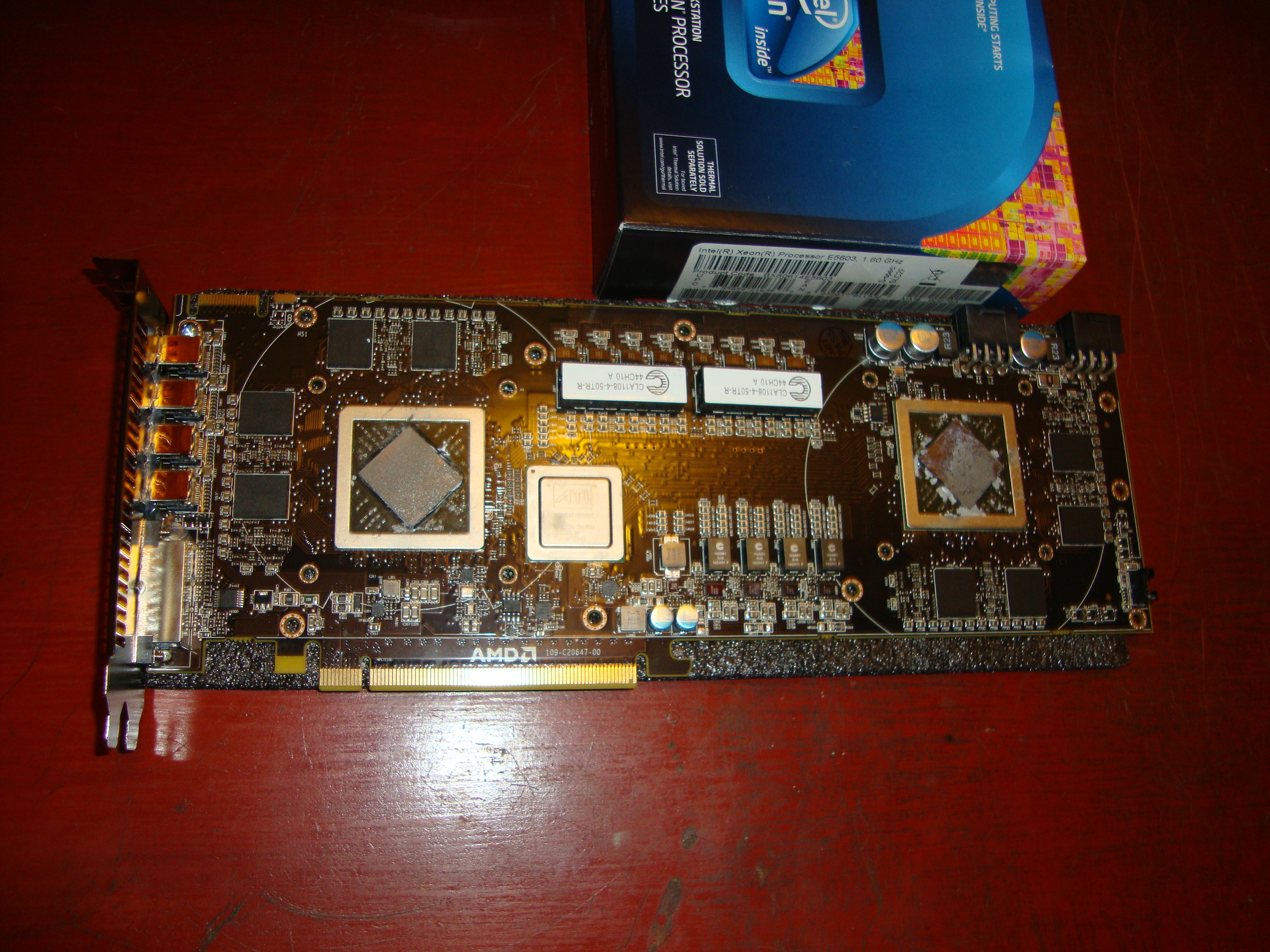

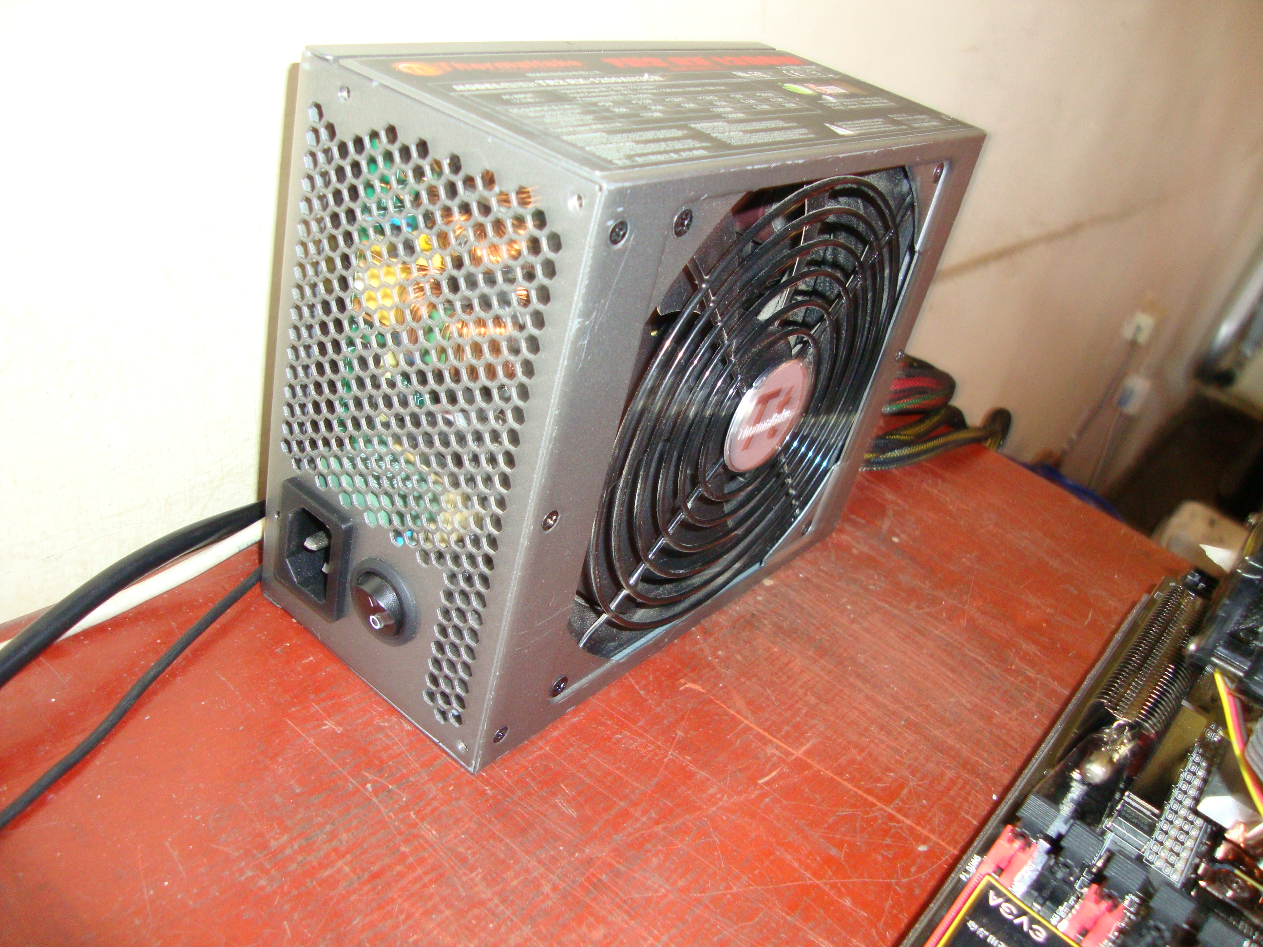

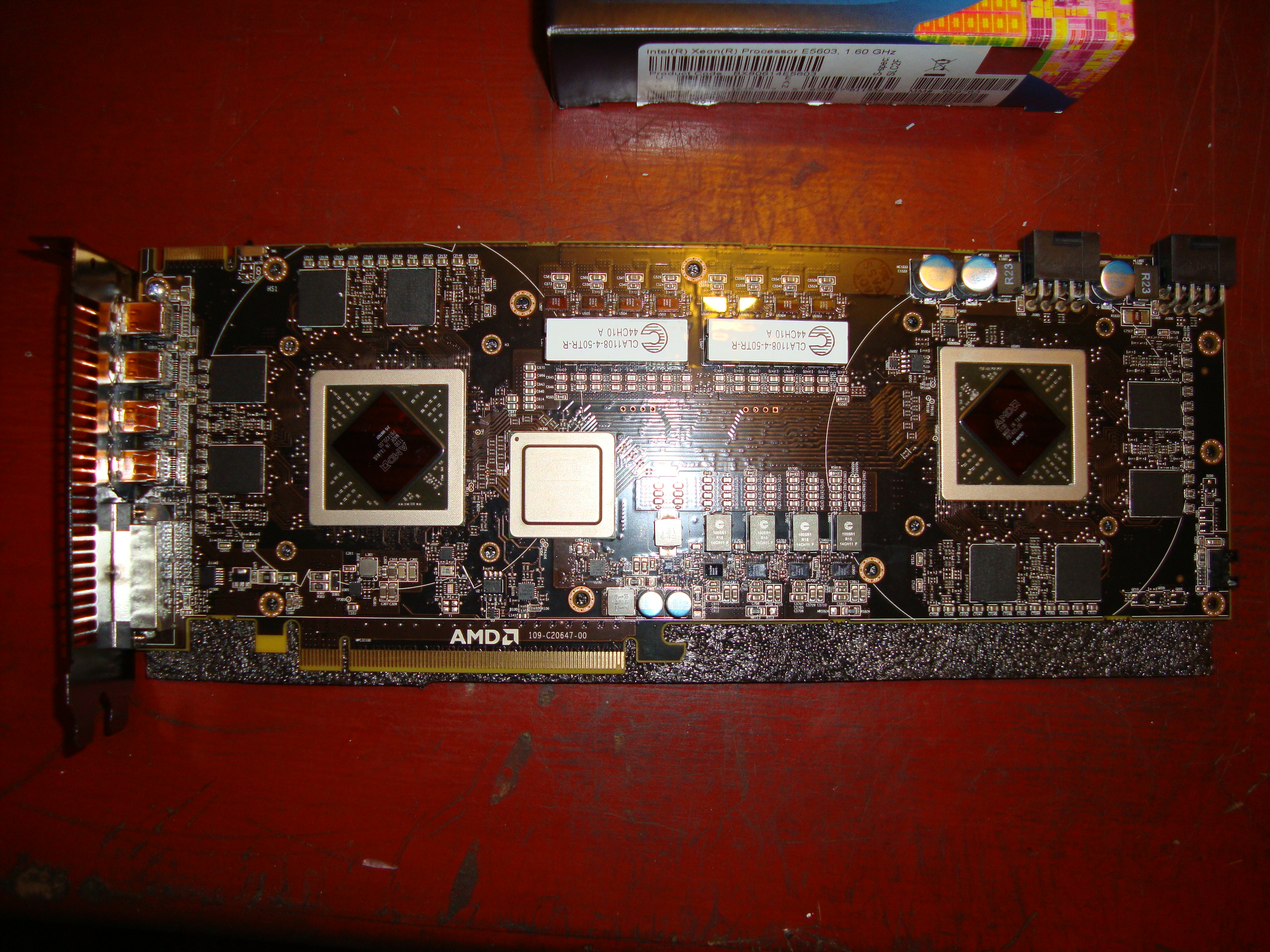

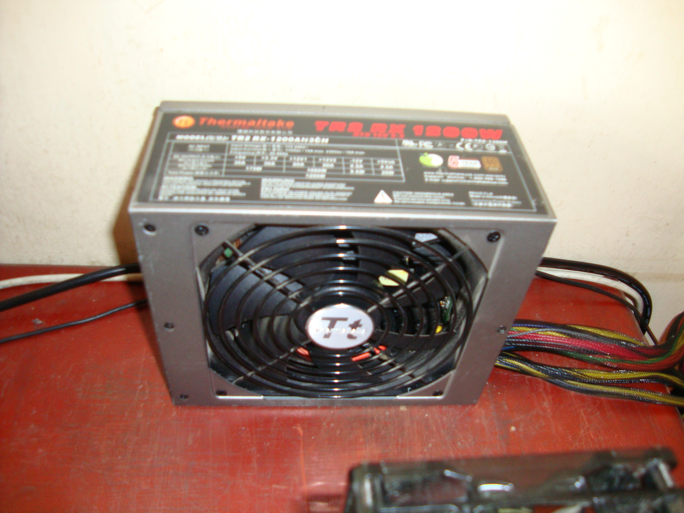

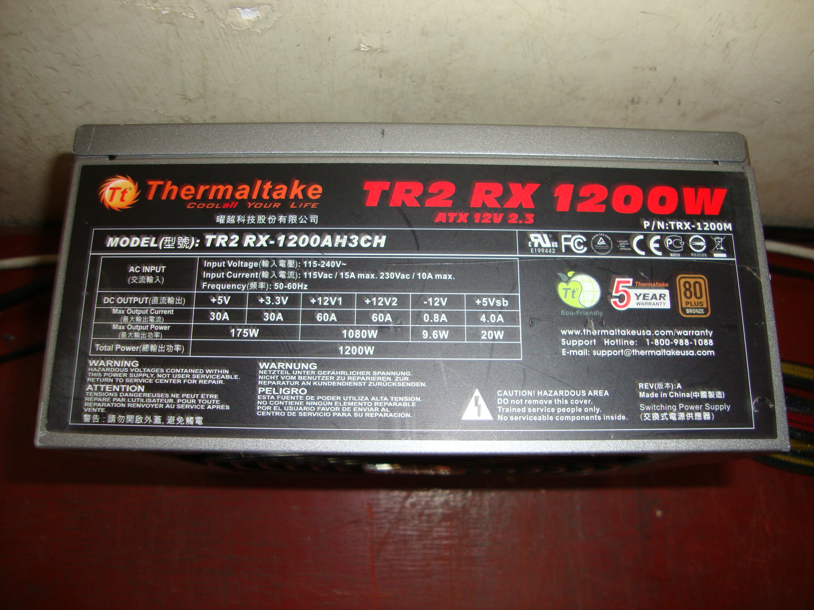

evgasr2 Posted May 4, 2012 Author Share Posted May 4, 2012 Thanks . il keep updating this thread as much as I can.and also , the current hd 6990 doesn't have a cooler , but I have already ordered one so It should arrive soon , maybe tomorrow. cant wait to bench.My 1200W Thermaltake PSU has arrived , more pictures soon. Link to comment Share on other sites More sharing options...

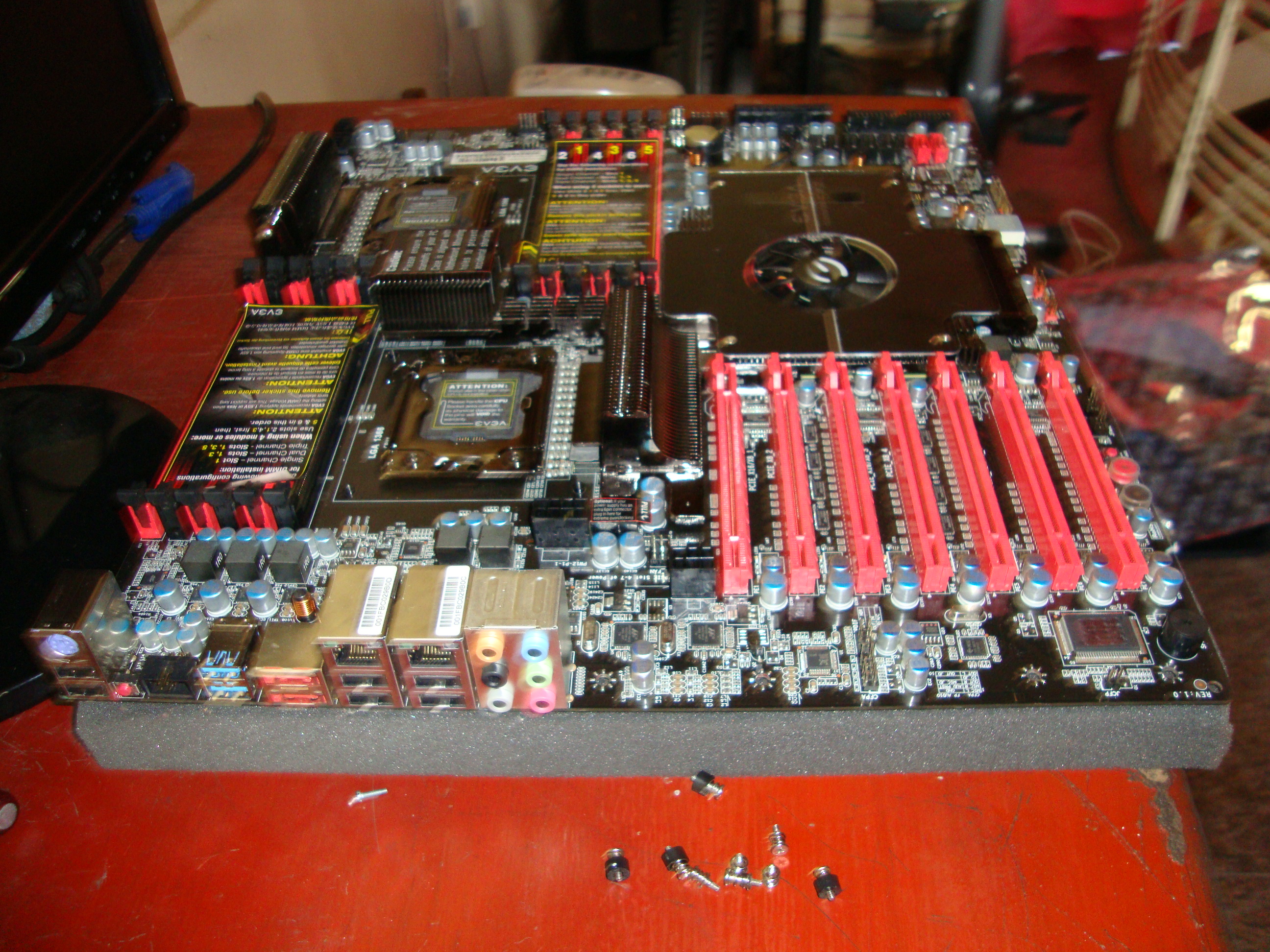

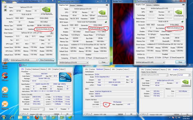

evgasr2 Posted May 5, 2012 Author Share Posted May 5, 2012 Pictures incoming,guys I need help!my GTX 465 runs at x4 speed , I tried all new drivers and reseated and tried it in all seven slots , but still at x4 speed , I need help in this.thanks a lot. Link to comment Share on other sites More sharing options...
Founder Michael Posted May 5, 2012 Founder Share Posted May 5, 2012 guys I need help!my GTX 465 runs at x4 speed , I tried all new drivers and reseated and tried it in all seven slots , but still at x4 speed , I need help in this.thanks a lot.you might want to involve @Jimbo and @ConkersGrillforce1337 ... 1 Link to comment Share on other sites More sharing options...
mw86 Posted May 5, 2012 Share Posted May 5, 2012 Yes they are the running experts on DIY Desktop rigs Great setup EVGASR2 Looking forward to seeing it as it progresses. 1 Link to comment Share on other sites More sharing options...

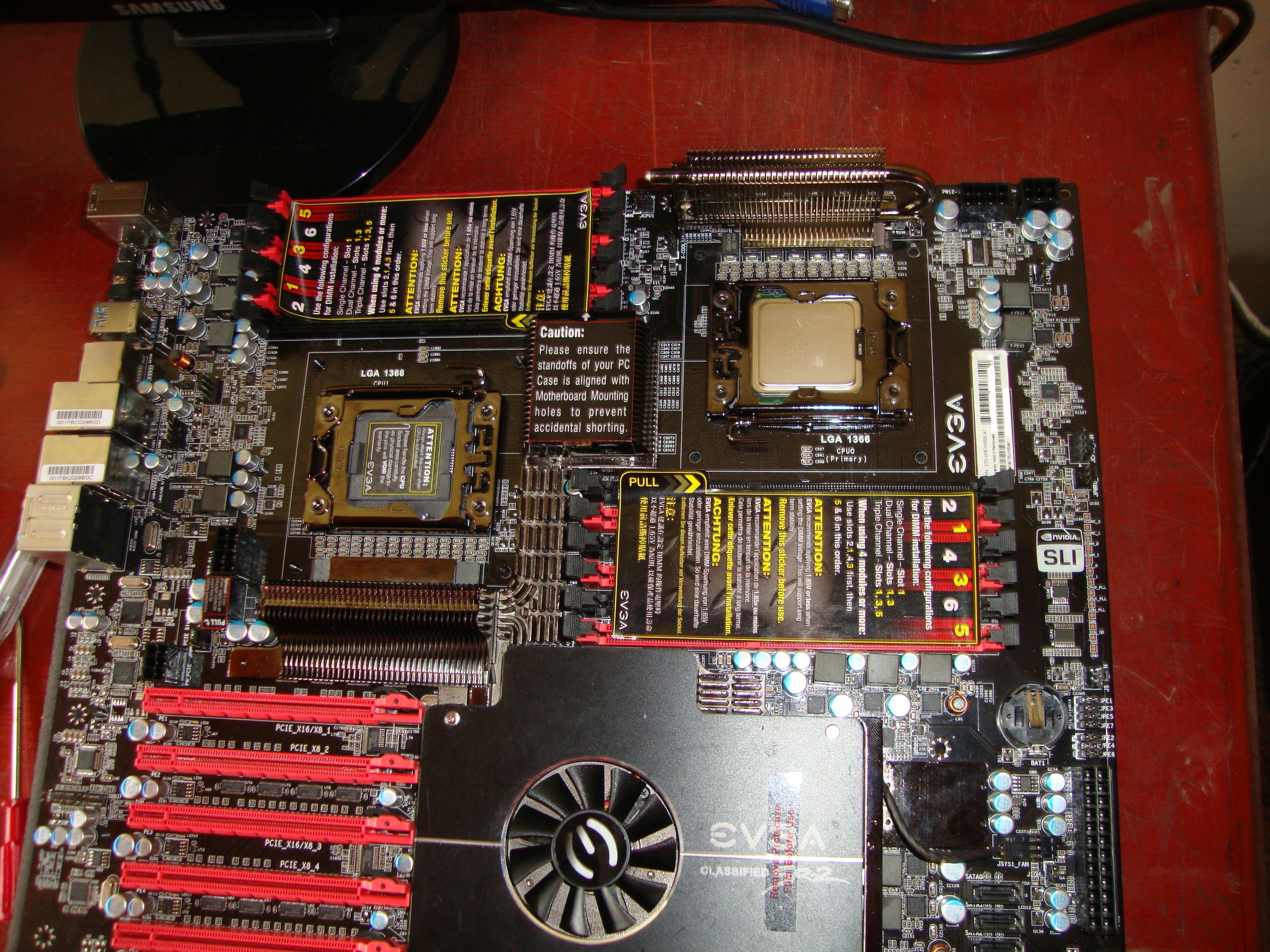

evgasr2 Posted May 5, 2012 Author Share Posted May 5, 2012 Did a test setup with my GTX 465 , but im unhappy because gpu-z and cpu-z reports as x4. thanks for your help. Link to comment Share on other sites More sharing options...
Jimbo Posted May 6, 2012 Share Posted May 6, 2012 Hmm, that is very odd.There seems to be a couple of threads about the issue (The one at guru3d is you i think?), I'm not sure what else to suggest.It's possible that it's caused by using one CPU on the board, though I haven't heard of it before. Is it possible to try the GPU in a different PC? 1 Link to comment Share on other sites More sharing options...
evgasr2 Posted May 6, 2012 Author Share Posted May 6, 2012 Yes I opened a thread on guru3d but no avil, Yes I can check that card on my friends pc, but hes not at home for 2 weeks, If I get the hd 6990 cooler tomorrow I could check it.but I have seen many people using their SR-2 with single processor, but didnt have this problem.thank mate. Link to comment Share on other sites More sharing options...
Jimbo Posted May 6, 2012 Share Posted May 6, 2012 Not sure what to tell you, except that I think it's probably the GPU rather than the motherboard (hopefully). If you can get the cooler on the 6990 that would probably be the easiest way to check, otherwise you will have to wait for your friend.Are you planning on trying to run the 465 with the 6990? Link to comment Share on other sites More sharing options...
evgasr2 Posted May 6, 2012 Author Share Posted May 6, 2012 Yes , I would be happy if the problem was caused with my GTX 465 , because RMA my SR-2 will cost alot for me.I cant wait until my HD 6990 cooler arrives, may be it should come on Tuesday , because its holiday tomorrow, ahhhh I hate it. if my friend comes before it Il be way happier.Yes I thought of running HD 6990 as primary and GTX 465 as physx ,I have downloaded that modded file to install nVidia drives while ATI exists , but if my hd 6990 runs at x16 and this gtx 465 runs at x4 , il probably sell this and keep my hd 6990.I saw the bench score's of gtx 690 and I was over excited , I thought of buying it but no money though.It performs 2x of hd 6990 im very unhappy about it. but nvm this is overkill or my 1440x900 inch monitor. Link to comment Share on other sites More sharing options...

Conker Posted May 6, 2012 Share Posted May 6, 2012 (edited) [ATTACH=CONFIG]4209[/ATTACH]Did a test setup with my GTX 465 , but im unhappy because gpu-z and cpu-z reports as x4. It's possible that it's caused by using one CPU on the board, though I haven't heard of it before. Is it possible to try the GPU in a different PC? Found a thread at overclockers forum about the same issue, this time with an ASRock motherboard. Perhaps it's an error in GPU-Z/CPU-Z. Hopefully your HD6990 cooler is coming soon, so you can test your system with a different card. I don't think the NF200 chip is broken and using an EVGA SR2 with only one CPU is also no problem. In the EVGA SR2 manual on page 37/38 is described how to disable the second CPU socket and how to disable the PCIe slots. Take a test run with a single PCIe slot (top slot, nearest to second CPU socket) enabled and the second CPU socket disabled...maybe it works P.S: Cool you've opened your own worklog for your machine keep us updated Edited May 6, 2012 by Conker 2 Link to comment Share on other sites More sharing options...

evgasr2 Posted May 9, 2012 Author Share Posted May 9, 2012 Hey guys !Im very happy , the x4 speed thing is now gone, yay.the problem came from my GTX 465 , now it out of my sr2 .now running with hd 6990 , and im posting with it now.the temps seems to be bit high . like 50oC idle and passes 80oc at gpu-z render test, thermal paste im using is : DYNEX , does this paste conduct electricity ?is it safe to use it with my hd 6990? my Arctic MX-4 is on its way , im using this for temporary.il be posting pictures shortly. Link to comment Share on other sites More sharing options...
